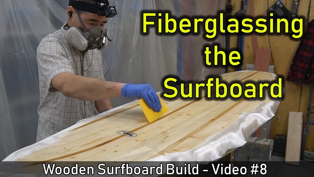

About my second Build, the Woodboard “Woody”
Sorry that I use the same Name for my Board like another Builder, but the inspiration to build a Board with wood comes as I show his videos and I love the Name, so I Germany exist an Woody-board too. ;-). Thank you about your inspiration.
In this time, the Woodboard use the same Akkupack like the Cubaboard. I only change the Box. My Plan is in the Future to build a 21700 Akkupack and in the new Box is enough space about a 21700, 14 or 16S and 14P Setup.
