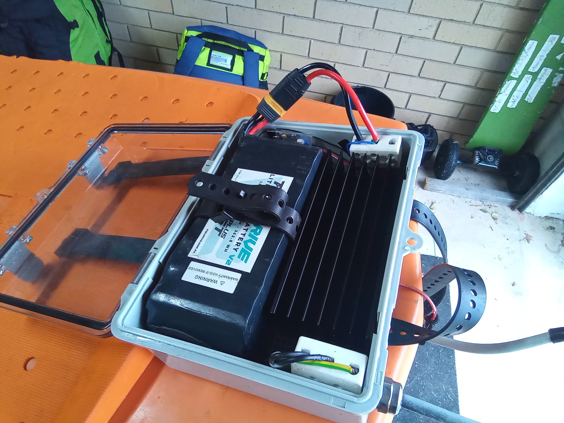

My first simple electronics build - FD Assist + Replacement
Flipsky 75200, huge heat sink, VX3 remote, 57 amp ceramic terminal blocks, thermal tape, double sided nanopore tape.
VESC Tool: 70 amp, 100 amp max, ERPM needed to be increased to 100k or motor wouldn’t turn from auto configuration.
Temp only went up 20 degrees with internal heat sink when tested 50 amp 100% throttle for 80% of battery. Water was sucked in when turning board over to exit due to cooling air, so water is splashed on before, and straps added.
Runs well with more power than before, more multiple battery runs required to ensure reliability.
Next I’m going to attach the old box to the front so I can use two batteries at a time.
I’m still learning, so this setup on my 105lt board will last until swing weight bothers me, and I will do another build.
Ran three batteries back to back. Didn’t suck in any water, but got drops of condensation as expected.
I’ve been informed the original FD Assist Plus used 60 amp, and the extra 10 I added was noticeable even if rarely used at max.
In 20 knots and associated waves on flat water, it made easy work where with the original unit I would have had some challenges.
I think there is certainly a place for those with limited skills or desire for complex builds, to at the least use Foil Drive motor, prop, universal mounting pod for a build, then with pre-built batteries.
For a box on the board design, used gen 1 parts are regularly for sale, or even a complete unit.
I was going to buy a gen 2 max unit, but now have the power I was seeking, and when downsize my board will build something instead of buying a complete unit.
Most likely using the new version 2 high power motor, batteries from China, and doing the electronics and case myself.

Had a lesson in running too many amps through my electronics today, the weak link must be the original cable from my FD Assist from the battery to ESC. Also possible my ESC got overheated and throttled power, as I couldn’t get on foil as easily, then not at all.
With the batteries in parallel it is unlikely they lost power, although it doesn’t take much for the FD batteries to lose their grunt, I’ve done it at 60% and unable to get on foil, and unknowingly at under 10% got on foil.
I did come in on low battery, so my final failure to get on foil could be from numerous reasons.
The conditions were glassy, so I kept doing touchdowns and breaches, fell off numerous times and looked down to see the speed at 26 km/h instead of my usual 20 km/h.
I only got 4 km out my two batteries in parallel, when I usually get 8. I thought there was something wrong with my setup, but the next day with slower speed it ran as expected.
I’m going to run some new batteries in series, to 14s, and change from a 6374 motor to a 6384.
This will dramatically reduce the amps and should increase range from 8 km to 9.5 km. Of course depending on how many starts I need.
This is now the end of this post and build.
I was out on the water, sat on my board, the box went under the water and sucked some water in. I usually splash the box before submerging it, and didn’t intend or realise I did it.
There was corrosion on the wires, and a few days later the ESC died.
I was warned about corrosion, but some salt water must have dripped on it and not sure if the recommended coating would have been enough.
So it will be a rebuild to follow in another post to come.
It still proved you could use an internal heatsink, and the terminal blocks made construction easy. If I had covered and coated the ESC, and the terminal blocks in some way to make the contents more waterproof it would have been a good design other than dealing with the contracting air sucking in water.
A better box would likely solve that. I saw recommendations but found problems sourcing them. Stupidly I will continue with this box as I’m impatient, tired of looking for alternatives and have connectors in it I don’t want to reconnect.
I will try to make the seal better, and use an external heatsink next.
