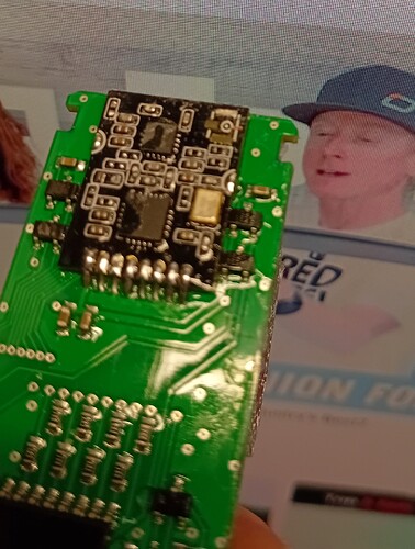

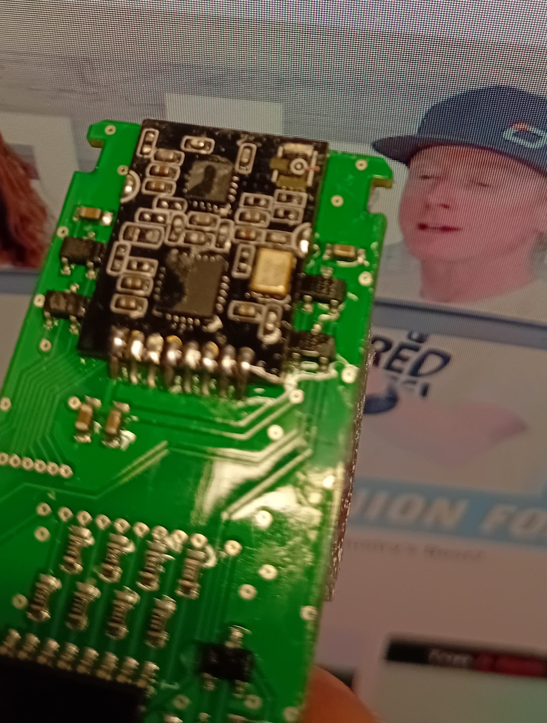

Is it just the pinout? If I solder the module like this, will it work?
The turning radius on one motor will be quite large; ideally, I’d like the board to turn in place.
You can solder every pin with a wire, yes
But the module must not touch the original pads
Thanks, that’s all I wanted to know. I’ll cover the contact pads with a mask.

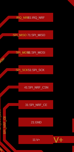

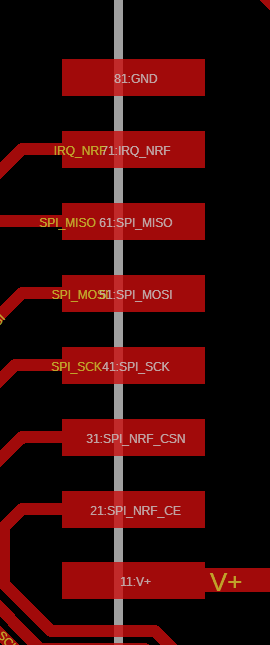

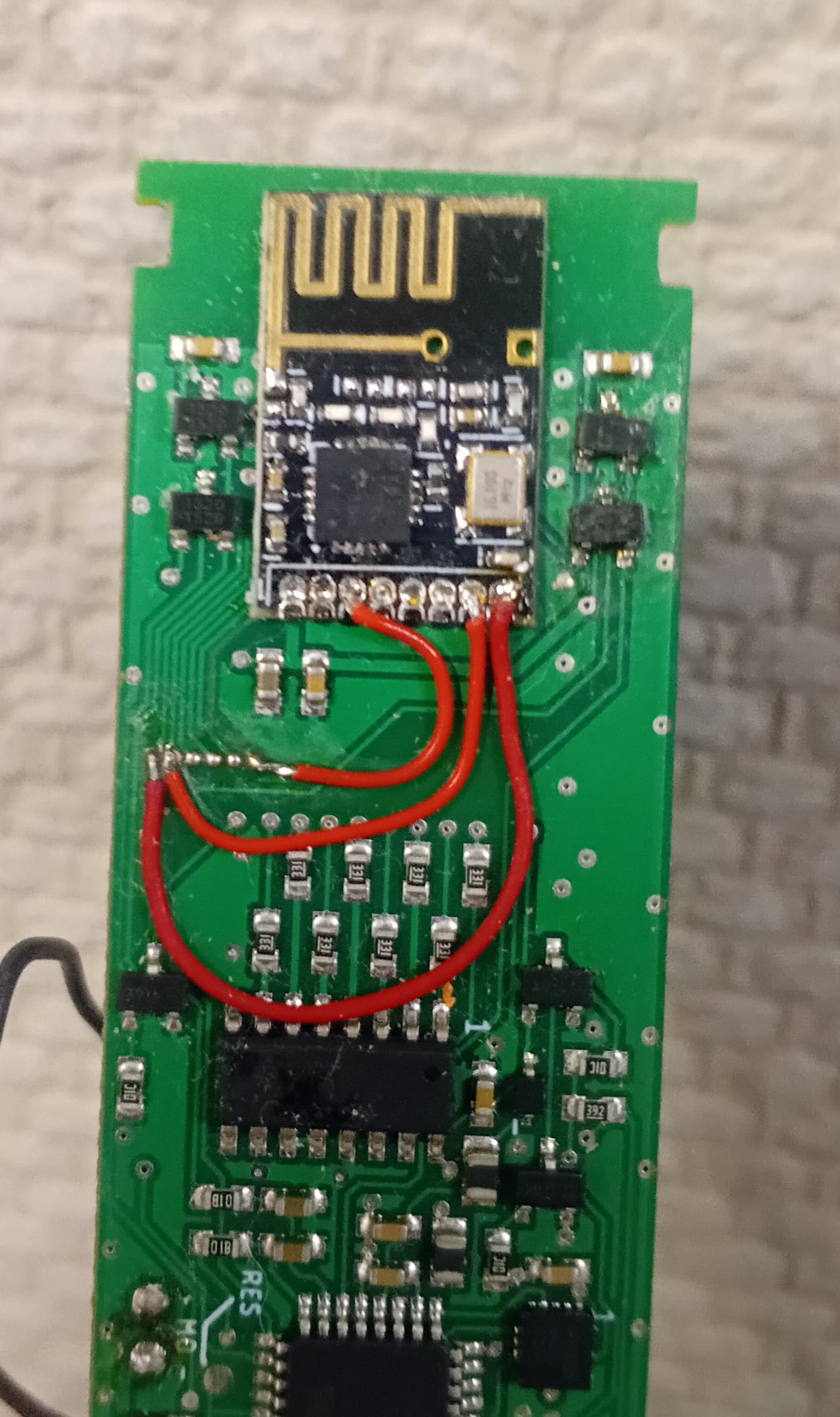

Here to compare the pinouts:
left nomal | right LR
Basically shifted by 1 except power stays and GND moves to the end

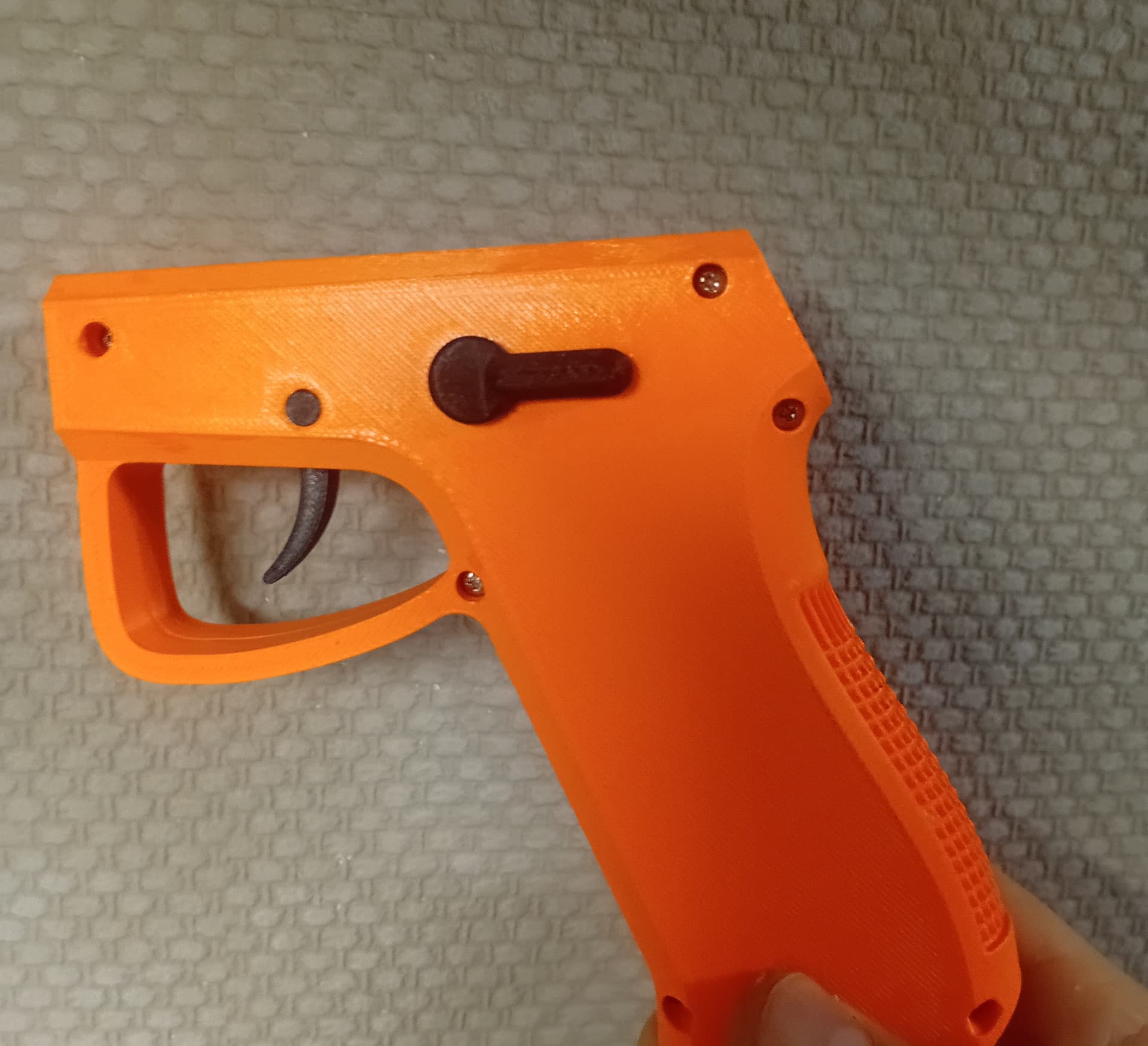

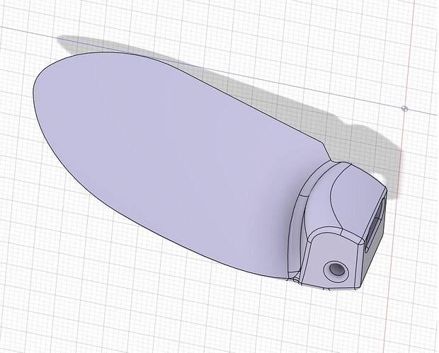

I made a new model for the LR module and slightly extended the trigger guard for ease of use with thick gloves. Testing tomorrow.
Failure. During installation, the antenna connector caught on a plastic overhang and tore off along with the socket (
Easiest is probably to replace the whole nrf-24 module, those connectors are finiky to solder.
In a pinch you can solder the antenna cable directly to the board as well.
Everything works perfectly. The range is about 100 meters. Battery life has been reduced by half – no more paddling ))

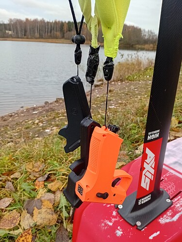

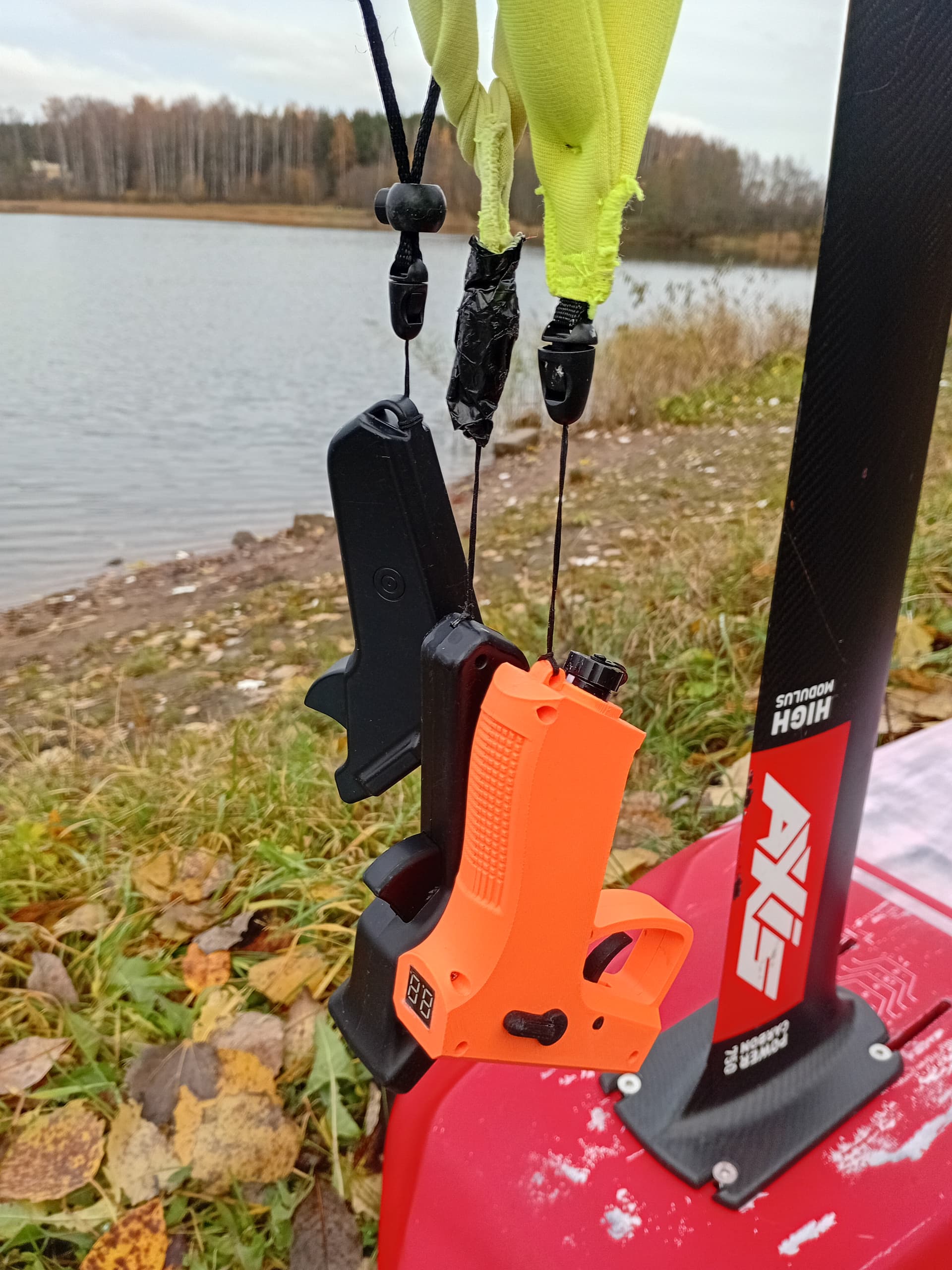

Do you ride with all 3 remotes at the same time? 3 way independent steering :wink:
I was simply testing whether the stabilizer would break under the weight of the Bremote. It turned out to be quite heavy, but still maintained positive buoyancy. And for its 5 Ah capacity, I’m willing to live with this drawback.

If anyone needs the FD blade model for non-commercial purposes, please send me a private message. The geometry was restored from a low-quality STL file, so it’s not a perfect copy, but you can always make your own adjustments. I can’t promise it’ll be done quickly.
290cfb0425cc36bbcb1786c0c4a92a2bdaefd0a3_2_620x499
If you are requesting a model, please provide your email.
