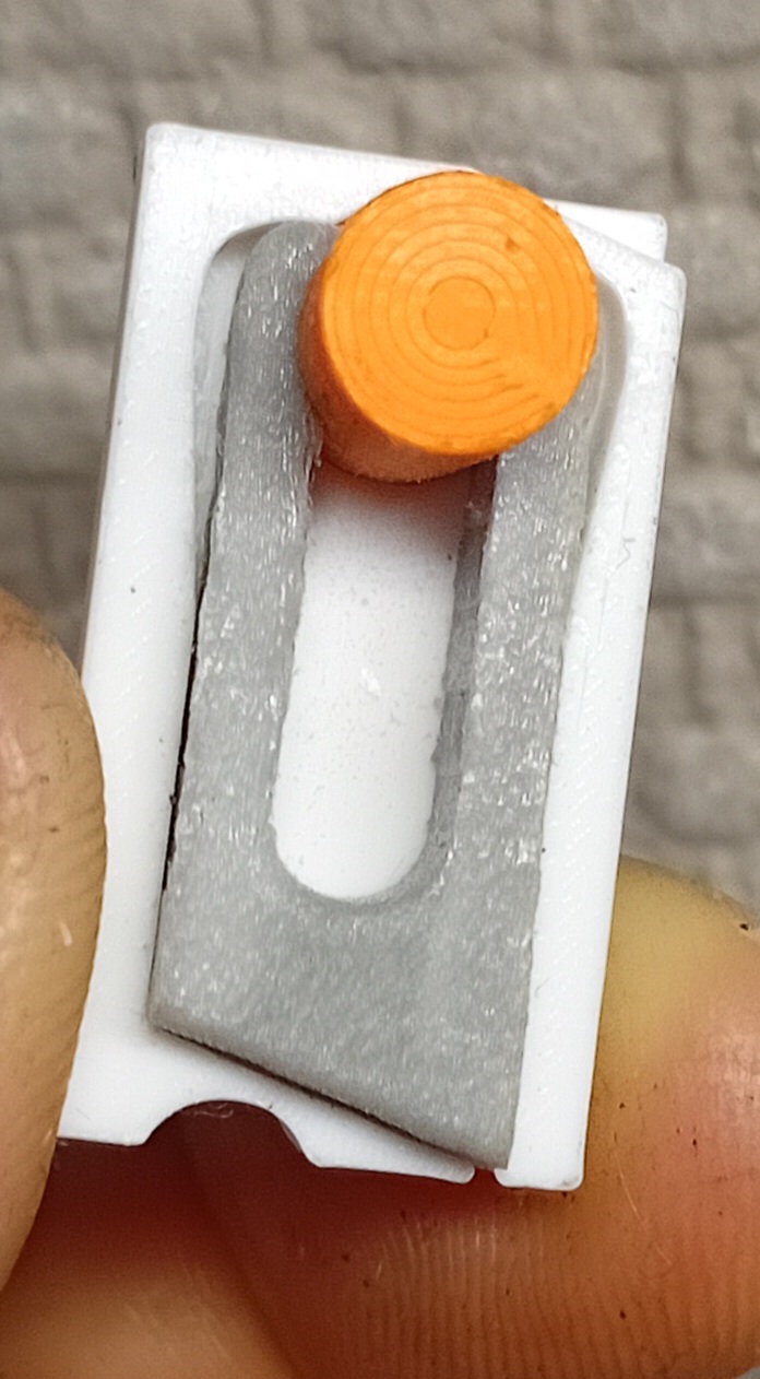

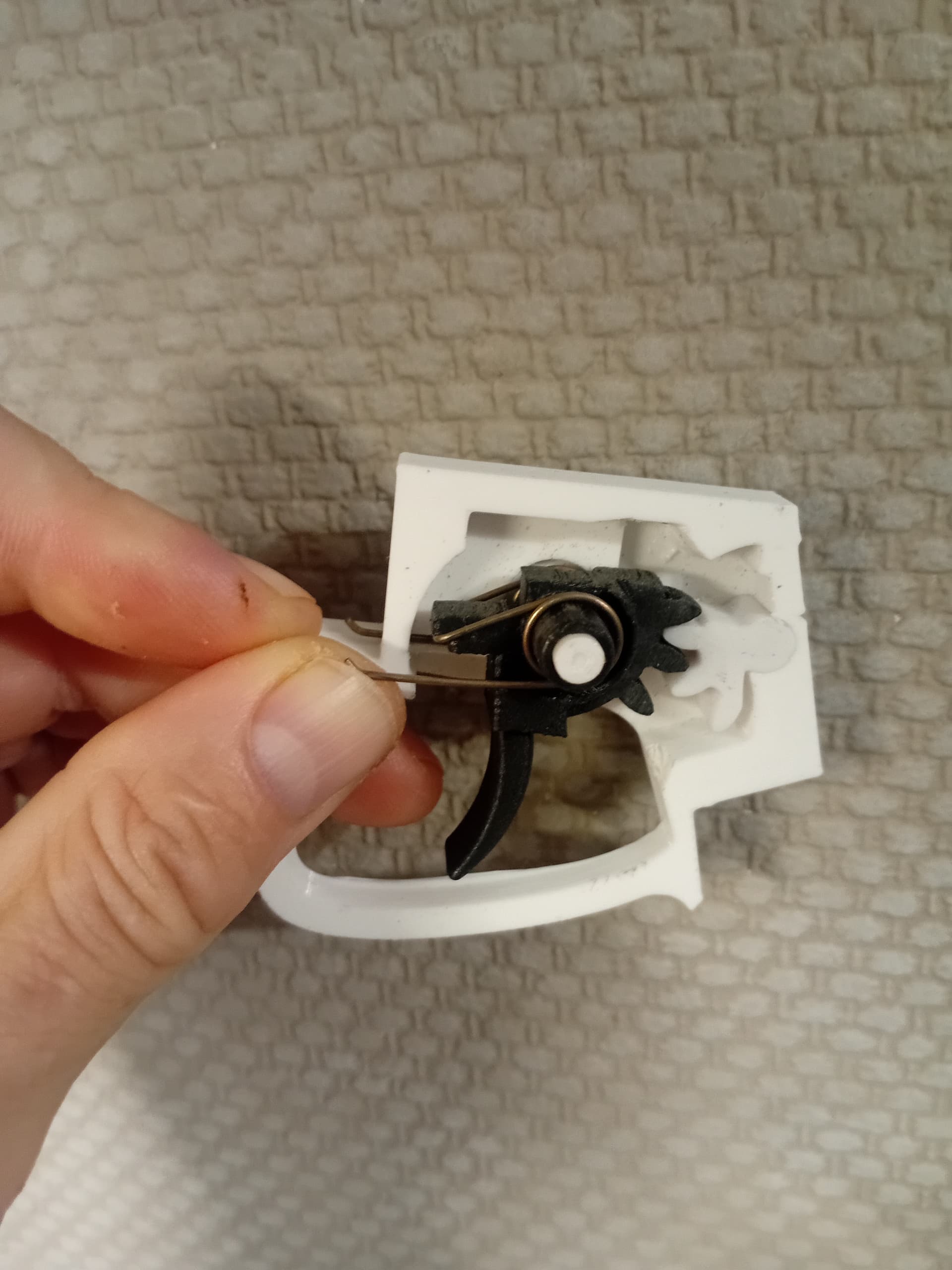

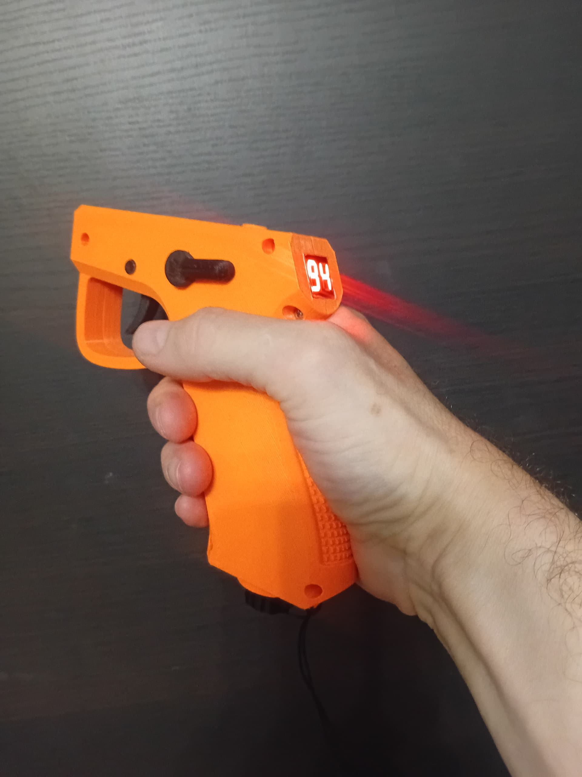

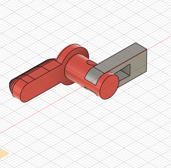

I decided to continue working on the Bremote V1. After all, I already have five kits, and the fact that they haven’t turned into finished remotes yet is quite disappointing. One of the reasons I decided to stop was my uncertainty about the reliability of the printed springs. Torsion springs at least worked somewhat, while other types invariably ended up in the trash. However, torsion springs weren’t suitable for me due to their large size. Then I remembered that I have quite a few AR-15 parts (yes, they shoot bullets, how awful). Without much thought, I made a trigger model adapted for this spring, and it works perfectly, exactly as I needed. This spring has withstood several thousand pulls, and I’m sure it will withstand several tens of thousands more. The only problem remaining was the selector spring. So I decided to seek help: I ​​couldn’t decide which spring to use because the internal space was very limited. If you have any ideas or examples of solutions, I would be grateful for them.
I finally found a use for the old batteries 8s3p from the foil assist. Two batteries connected in series last me almost an hour of tow-boogie riding.
My personal messages are overflowing with various options, but due to my rigid thinking, I decided to do everything myself. This “spring” works perfectly.
This time, everything worked out with the Bremote, less than two years later. My mistake was using the internal ToTo mechanics. Now I’ve made a new model, maintaining the original Bremote’s parameters, and everything works as expected. However, the range is still insufficient and significantly inferior to the Maytech and Flipsky, reaching no more than 15 meters. Any tips to increasing the range?
