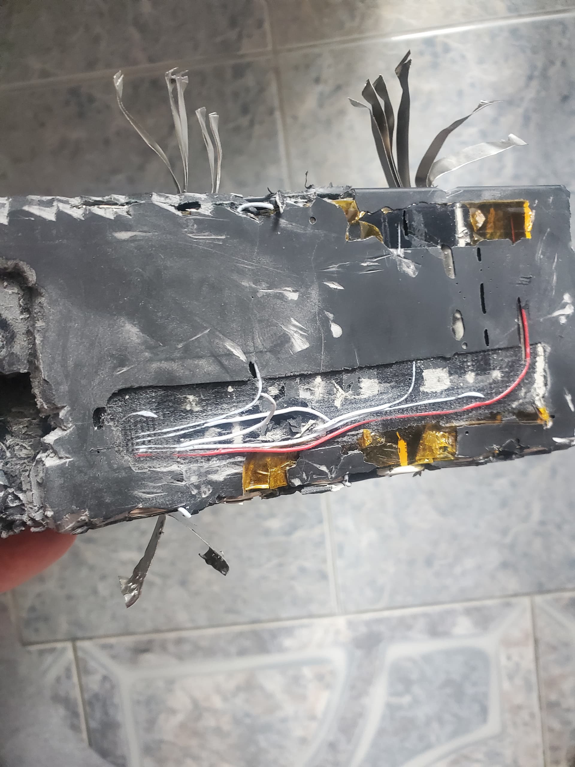

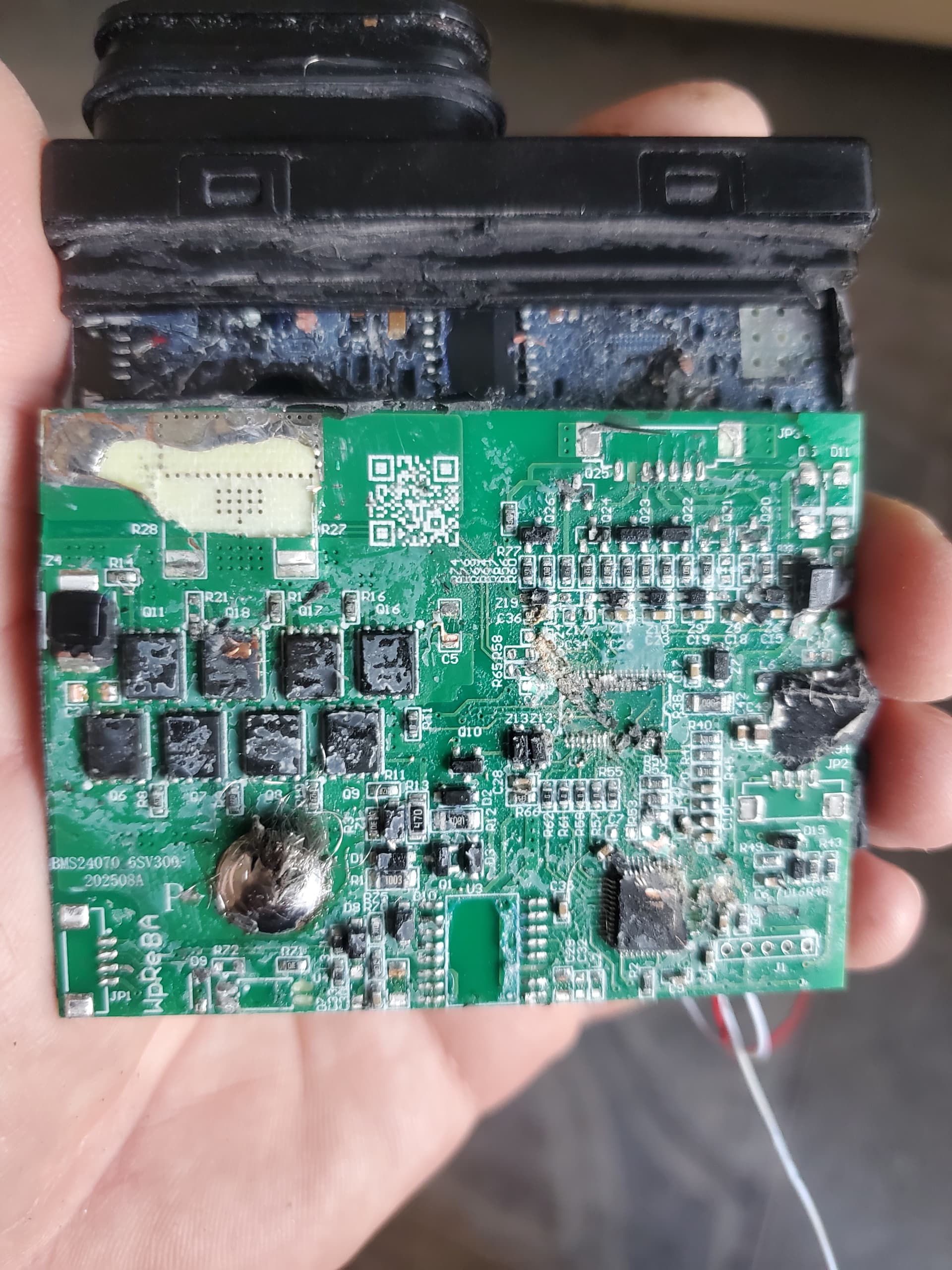

Continuing the autopsy. The busbar. The BMS was slightly damaged.
Did you understand what went wrong in the first place? In my experience trying to weld too thixk nickel with strong welds create internal damage to the cells, and very high self discharge after thermal cycles of the cells.
I have no doubt that everything is exactly as you describe, but I think the underlying cause in this case is different. In each pair of two batteries, one is completely discharged and the other is not, and the voltage readings are the same in all four pairs. If self-discharge were the cause, I don’t think the readings would be the same.
However, I am not a expert and could be wrong.
By the way, what are the welding recommendations in this case?
If this photo is what we’re talking about, it’s a busbar made up of 6 layers of 0.15mm tape. The elements were welded together using two 0.2mm thick layers.
Without any hope, I took one cell from a disassembled battery (P42B) with a voltage of 0.7 volts and tried charging it. First, as a Pb battery to 2.4 V at 0.3 A, then as a Li-Ion battery to 3.7 V at 1.5 A. I expected a lot of heating and a high internal resistance. However, the cell charged and was slightly warm by the end of the charge. Internal resistance measurements with a YR 1035+ showed 6 mOhm, which is typical for these cells. I’m surprised. I’ll leave it for a few days and monitor the self-discharge.
If you are lucky, its just the bms billing the cells, but with 6 stacked layers of nickel, heat damage to the cell during welds is possible.
BMS. Solder a couple of transistors and it’ll be good as new.

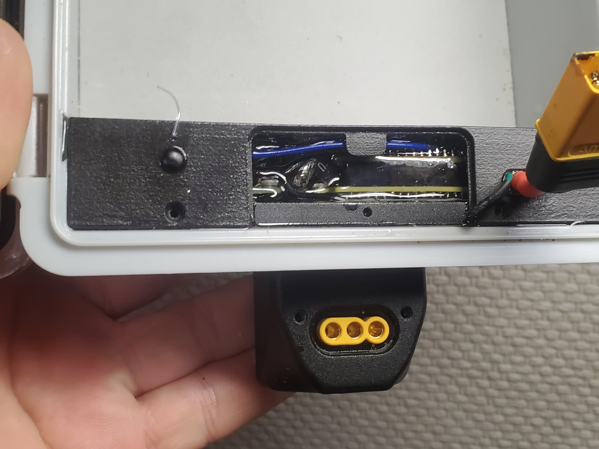

Can anyone identify the model? The board looks like a standard BMS.
Manta pron.
I think I figured out why four sets of batteries died.

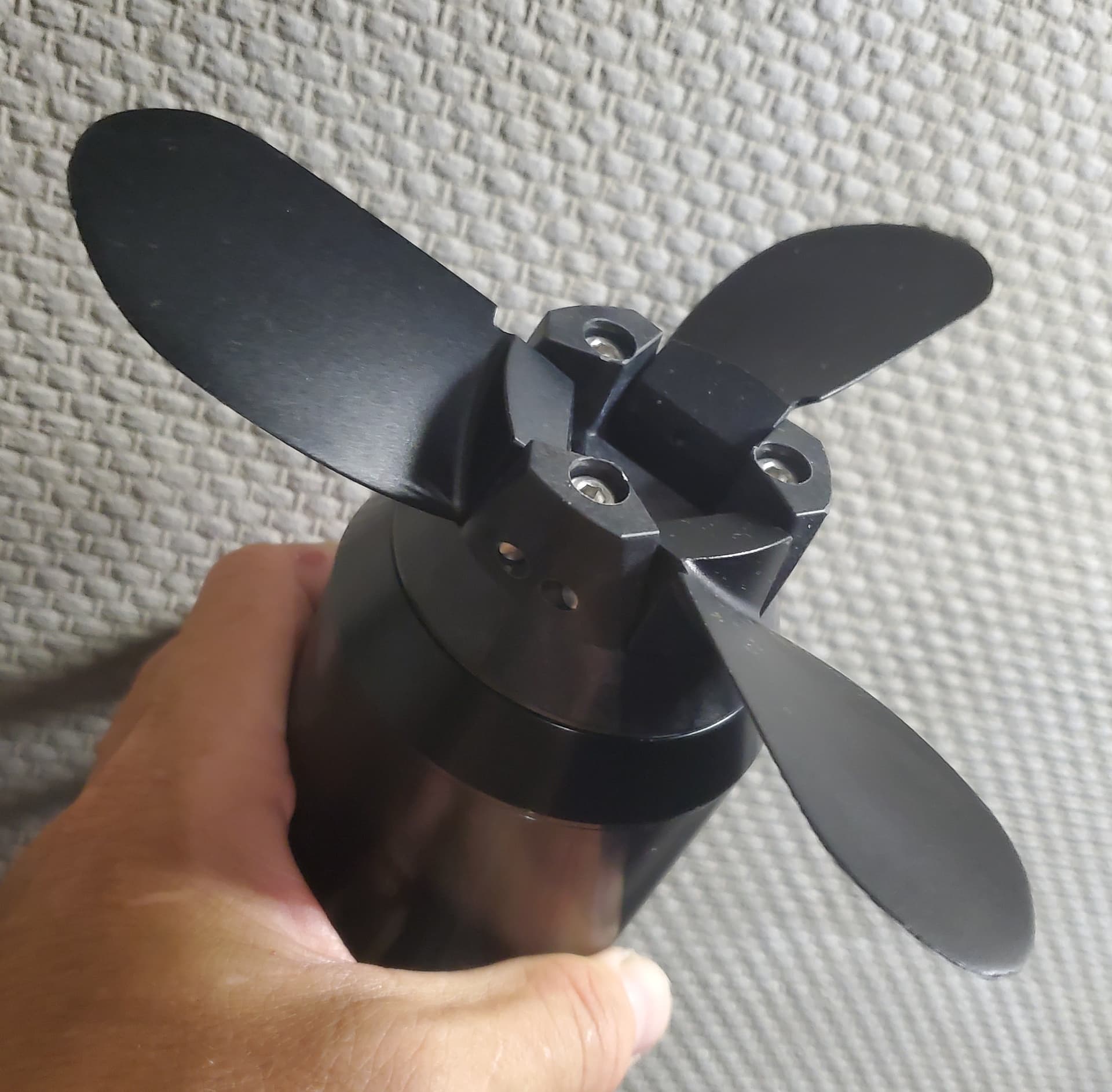

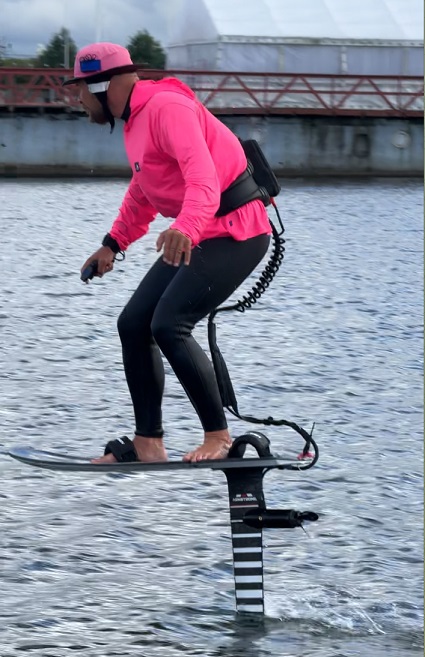

Today I had a chance to take the new foil assistant for a spin. Overall, I liked it. The lightweight, specially designed, coiled cable with a soft braid is the complete opposite of the Manta cable. The belt is comfortable. The Manta Performance motor has plenty of power, accelerates confidently, and the three-blade propeller runs smoothly, with not even a hint of cavitation.

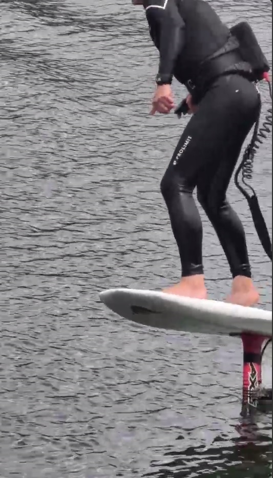

Taking off on a Wkt122? No problem!
What hub are you using?
Thanks, I assumed you would be using a plastic 3d printed hub. Is this one a custom machined hub or off the shelf? What is the source?
https://eushop.mantafoils.com/takeoff/parts-accessories-takeoff/3-blade-propeller-v2/

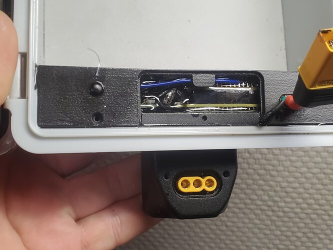

Inside the Foildash box. The controller and transmitter are completely sealed with epoxy. A massive aluminum socket acts as a heat sink.
foildash uses the same motor as manta ?
is it possible to find this motor for DIY project ?
I tried to find them, but haven’t had any luck yet. Definitely a Chinese manufacturer and wouldn’t be surprised if its one of the usual suspects.
