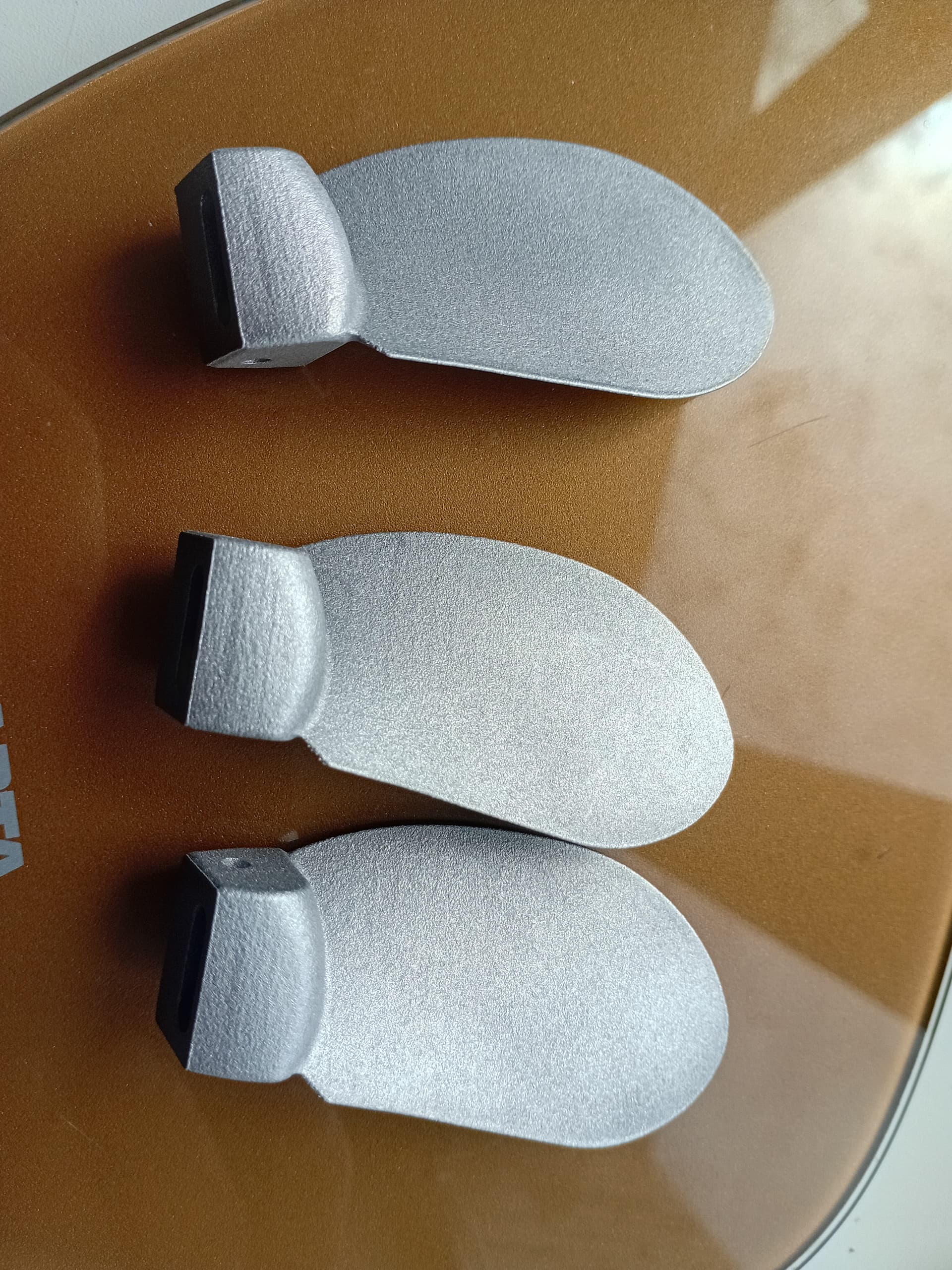

I’ve been meaning to do this for a couple of years now and finally printed out some metal blades.
