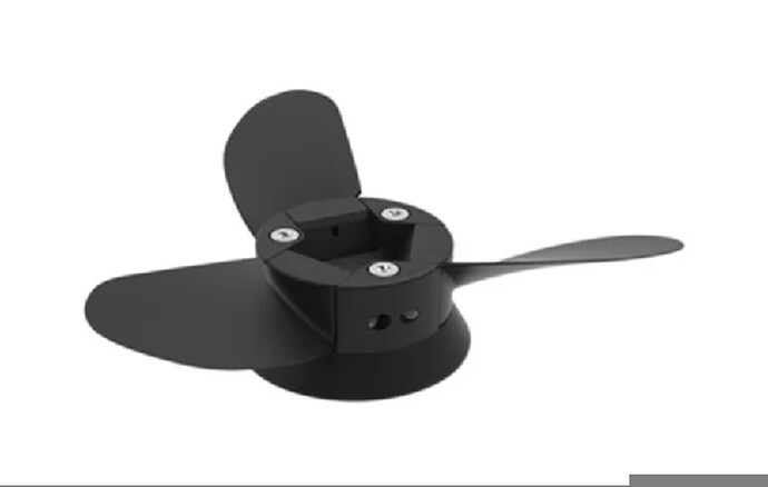

-Flipsky 2 folded aluminium prop
Apart from cables and plugs, are there other things I am missing? Would it be reasonable to change motor to flipsky 6384 and ESC to 75200, to keep more parts from the same manufacturer?
Saite is a good choice, not the cheapest option but it’s of better quality than the BDUAV Ali Express motor and has thicker cables. It also has a longer stator and rotor magnets which means more torque. If you purchase it directly from Saite (or from them over Alibaba) you can get it with the cut shaft. You can also get it “waterproofed” with epoxy and ceramic bearings. I got mine just with a cut shaft. The inside of my rotor is coated, although I did not ask for it. The stator needs some coating. I swapped the bearings for stainless steel, they last longer than ceramic.
For the prop I don’t know how good the flipsky performs, 3 blade original FD is best according to people Inknow and tested differen folding props. Unfortunately it is also the most expensive one @ around 300$.
The Flipsky prop is allright if it stays submerged, but doesn’t like breaching at all and is best use for light efoil rather than assist duties (Motor low and not motor high).
The FD 3 blade prop is indeed the best assist prop so far, I use a carbon prop molded of it and it is smooth and silent, breaches well and does not over torque (high phase amps) on the 120kv / 12 S setups.
You are both right. Looks like FD 3blade prop is the way to go. For this build I just want to go after what is working, so I will order that.

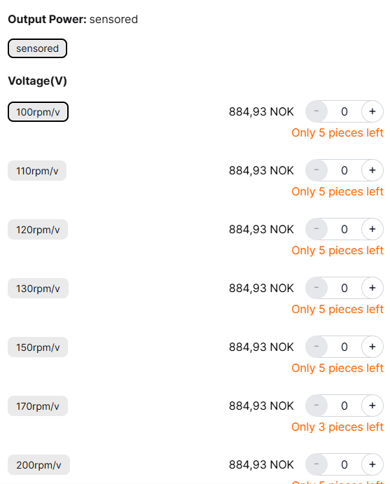

When it comes to the saite 6384, I understand you recommend the 120kV. That equals to 120rpm/v option that shows up in Alibaba?
And do you have to specify shaft diameter and length when ordering, so it matches FD prop?
Thank you for all the help :slight_smile:
The Foil Drive 6374 Saite motor is 130kv. Not sure what the High Power is but it’s really just a 6384, not sure of the kv. Chris from Saite knows all the details on cut off shaft etc.
It’s pretty easy to replace the cables on the cheap Aliexpress 6384 120kv.
I’m light weight but the 6374 Saite actually has heaps of grunt. Foil Drive need the three blade prop because they current limit to protect Gen2 VESC and to presumably ensure good battery life.
I’ve have an old setup with 6374, 10S3P and HobbyWing Max5 Gen2 esc. That setup with twin blade foil drive props will get 100kg beginner up on foil on a 5’7 x 28” ‘soap-bar’ wing board.
130 kv sensorless, you don’t need a shaft, you can ask them to cut it. You mount the prop directly to the bell (rotor of the outrunner).

Maybe someone is willing to try the Manta 3-blade aluminum prop? $250 including the base.
https://www.shop.mantafoils.com/takeoff/parts-accessories-takeoff/3-blade-propeller-v2/
I have the flipsky prop, but now you saved me a session testing the ventilation :grin:

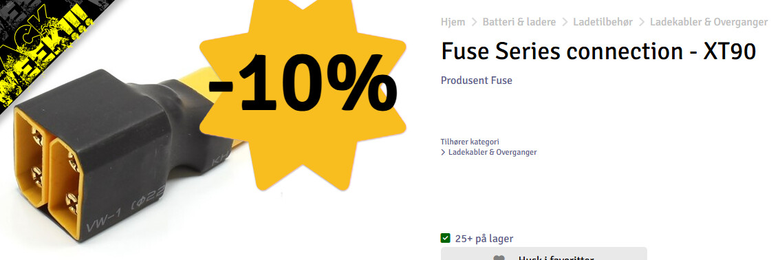

Just one question regarding connection batteries in series. Could I use this:
And should I have anti-spark XT90 connectors on battery side?
Do I also need to have a bms?
75100 has inbuilt bec, so nice and easy. You could certainly use that connector if it all fits physically. There isn’t much room left in the smallest Camdenboss box!
Definitely anti spark connectors
You can aslo build a wire harness yourself with just th two male connectors to connect the batteries. Like that you can adapt the lenght of the cables and positions of the connecters for optimum fit if space is limmited. Antispark on battery side is recommended.

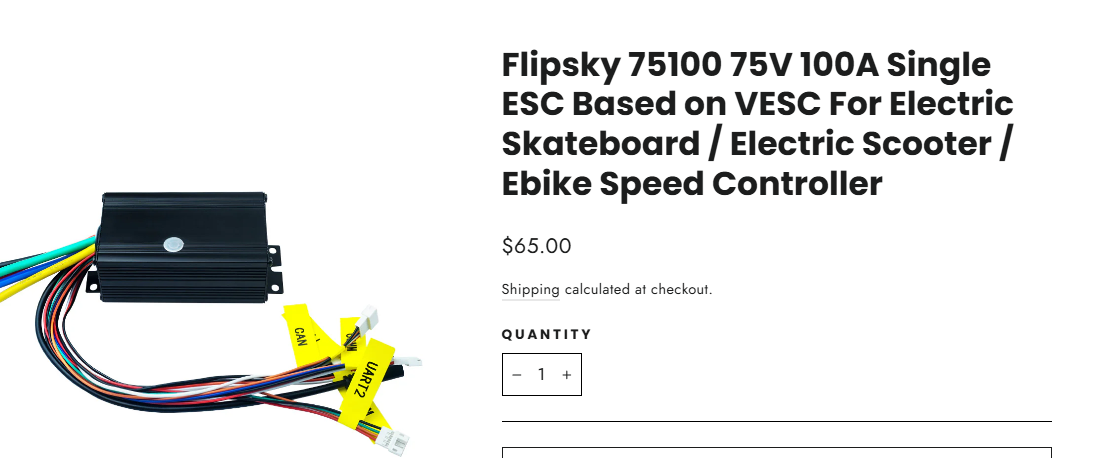

Could you just confirm me which 75100 you are using?
Is it this one:
or
And what is the minimum thickness for the wires from battery to the VESC and VESC to motor?
I have started modelling everything to get an idea and I agree that a custom harness will better. Thanks for the tip!
I’m using the bottom one, but buy it without the key. The non pro version will fit into the Camdenboss box. Make sure you get the version with the aluminium pcb
Like this one
I just found this on AliExpress: AU$277.47 | Flipsky 75100 With Aluminum PCB Based on VESC For Electric Skateboard / Scooter / Ebike Speed Controller
https://a.aliexpress.com/_msn1PHP
Just start ordering and went for the 75100 from the link :slight_smile:
