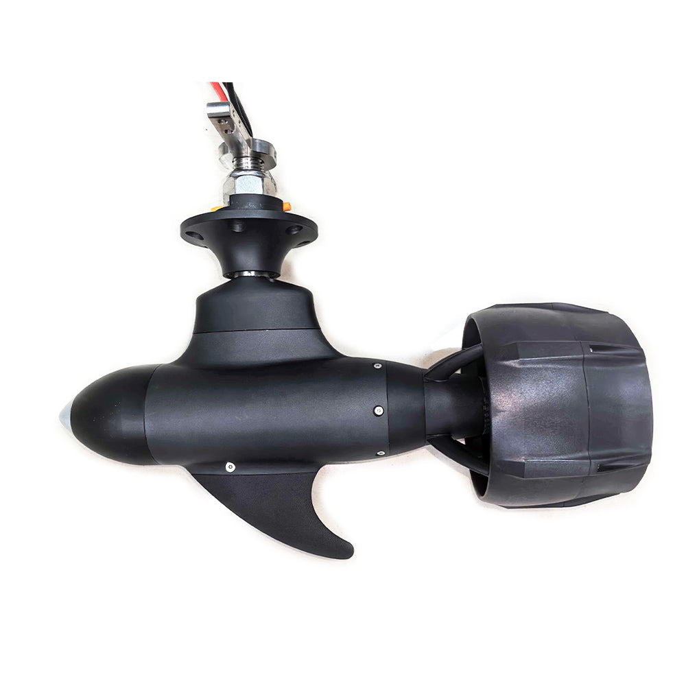

Look whats new :slight_smile: Solves every problem, esc built in, steering possible, i like it
That does look interesting. What servo would be powerful enough for this? I’ve read in other posts that the servos used struggled with the power required.
I would go for something between 50-100kg. I believe that when you are not behind in a tow the force with some leverage on that connection is quite small.
And while towing yourself the servo should not be in use since you can control it from behind the tow wire with pure tension. Never tried but its logical to me.
The power supply is an easy thing to solve with an external BEC.
