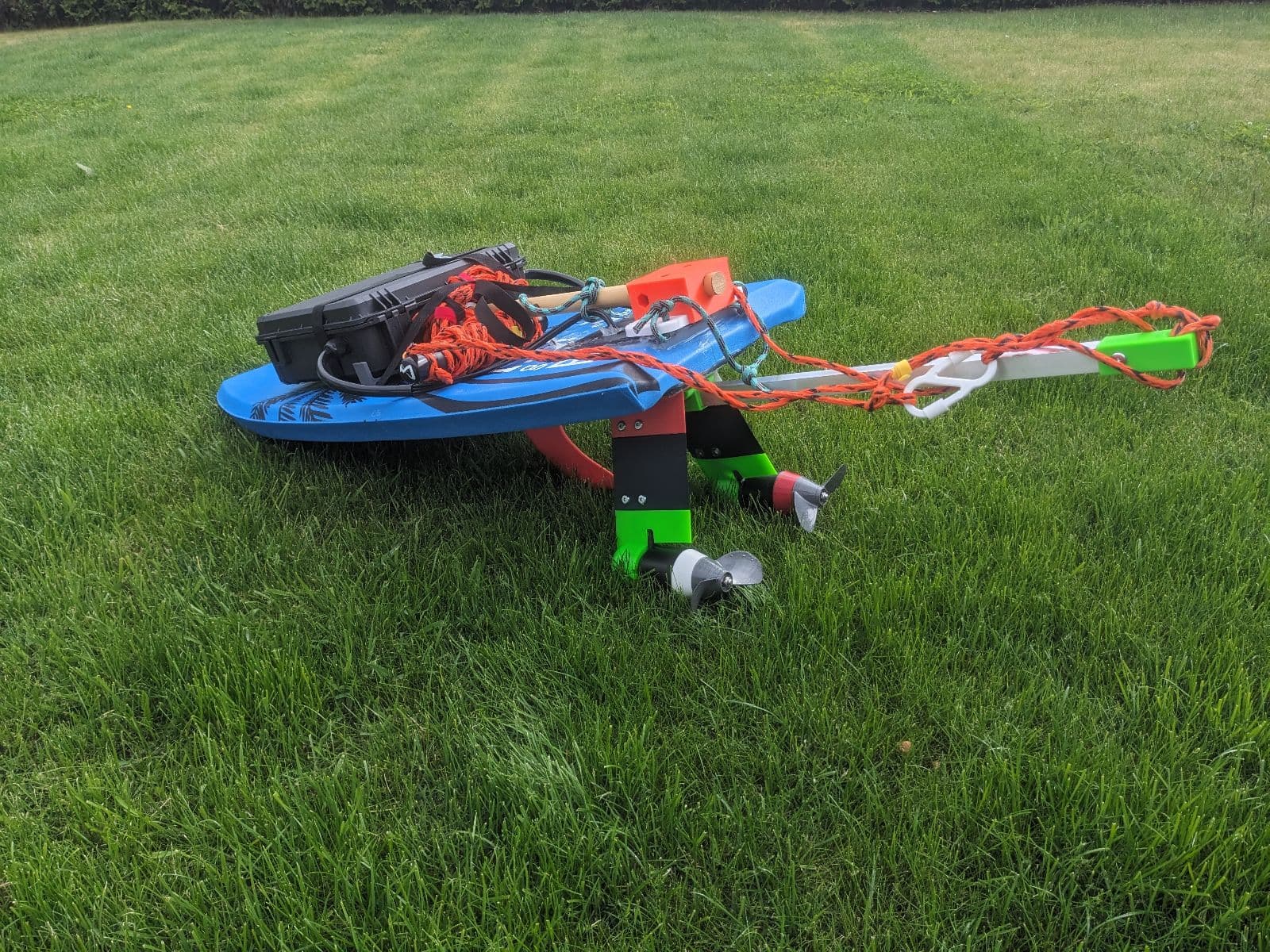

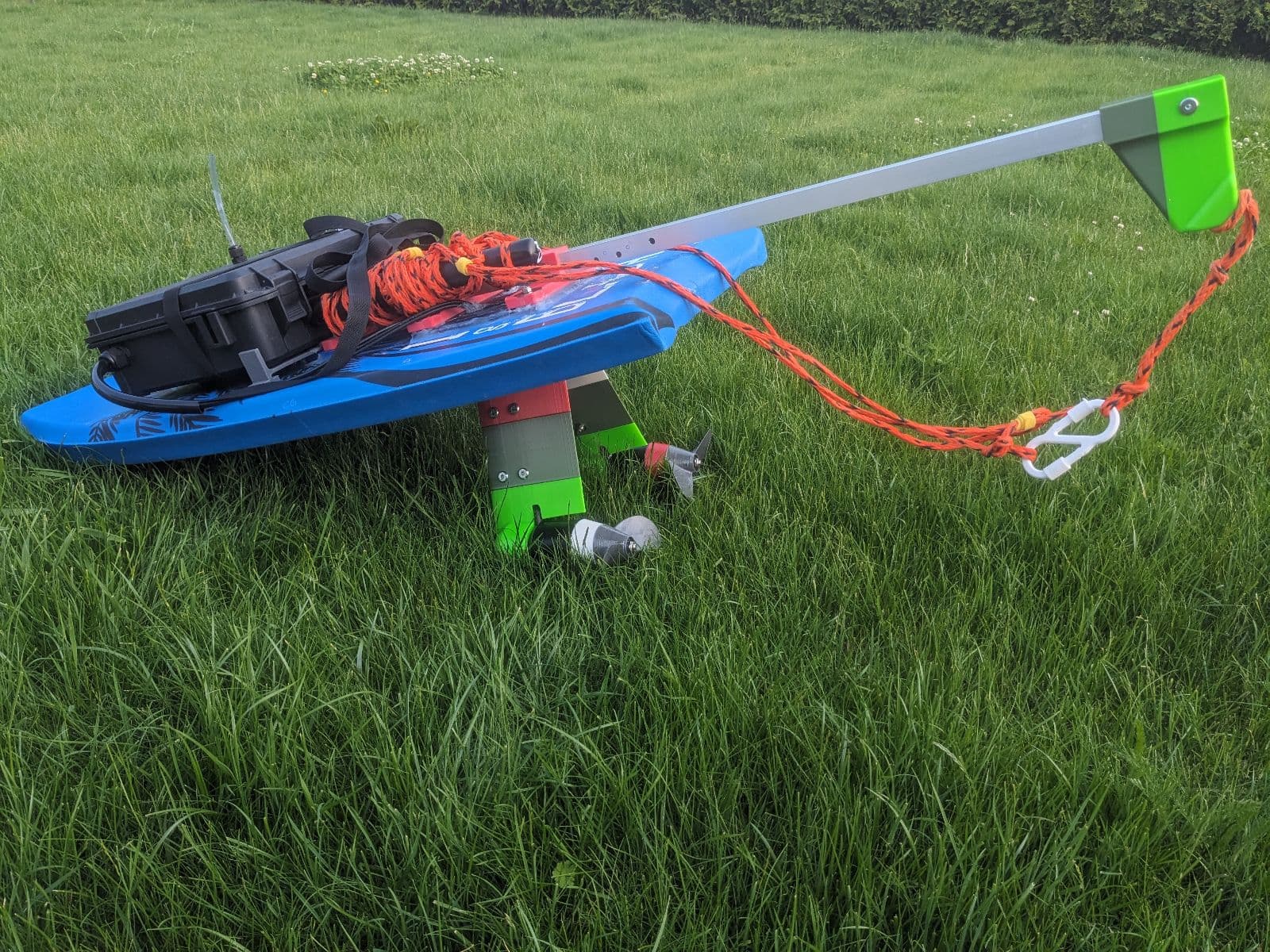

I started with motor position in the middle and only got around 6~7kmh until the board made superman and came out of the water.
I put it on 2nd try 18cm more in front and got even worse results.
The best position is what you can see on the picture, at the very end of the board.
The next problem was the hook for the wakeboard rope. I started of course on top of the board but that pulled the board up. So I designed/ printed a hook underneath the board and voila I got good results, but less efficiency in terms of power consumption.
I started with a 28mm wide wood rod and attached my rope there. But the forces were concentrated mostly on the mast base plate and I think in the long term this would lead to a failure or worn out mast/ base plate board connection.
Thats why I chose an aluminum profile with a 25x25x2 mm size and 1m length. This suits perfectly to create a very stiff connection with the rope and also stabilizes the whole tow boogie itself.

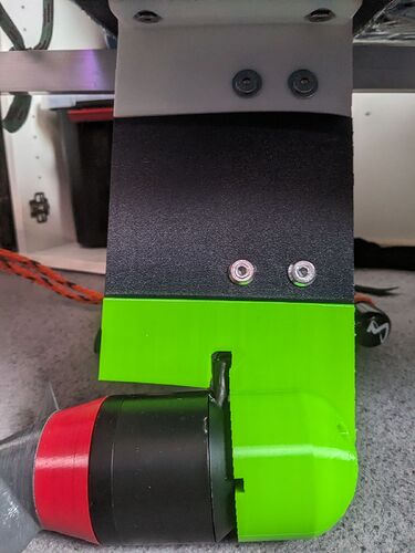

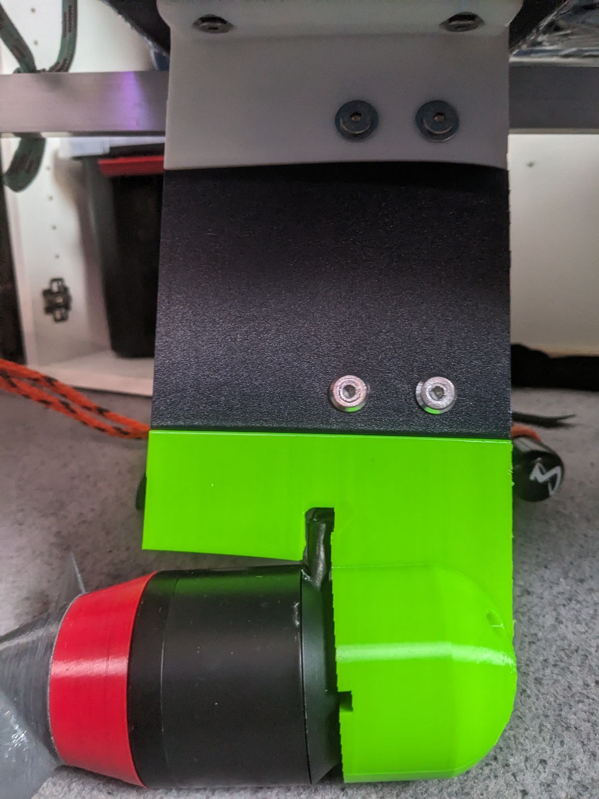

Another major point was to add a 5 degree rotation to the motor pod holder, as this gives the board a slight pitch down when powering the motors and less moving up out of the water. Check out the available motor pods (0, 5, 8 degree).

This leads me to how to steer this thing. I found out that I can make relatively fast/ forced turns when I am high on mast and pull the rope towards me. This may be because the alu profile is controling the whole board.
One problem is to find the right balance on roll axis. As I only have 2 “small” 6S4P batteries in series, the weight is relatively low for a heavier rider with 80+ kg and therefore if the COG is slightly off you will see it especially in curves.

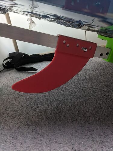

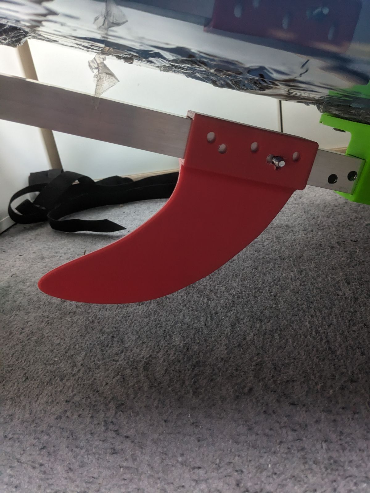

I added a fin to stabilize especially in turning.

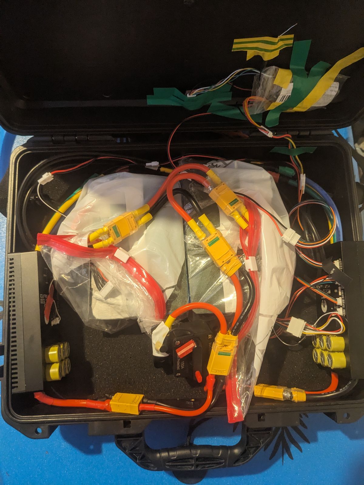

Electronics
Fairly easy, as I already did a dual motor mountainboard build. Just setup each VESC with its motor and then setup communication via CAN.
Both VESC setup nearly identically:
Max Current: 100A
Max Battery Current: 40A
I should have put the batteries to the outside for more weight stability, but it is what it is now. My next battery pack will be 12S6P and will get put to the outside.

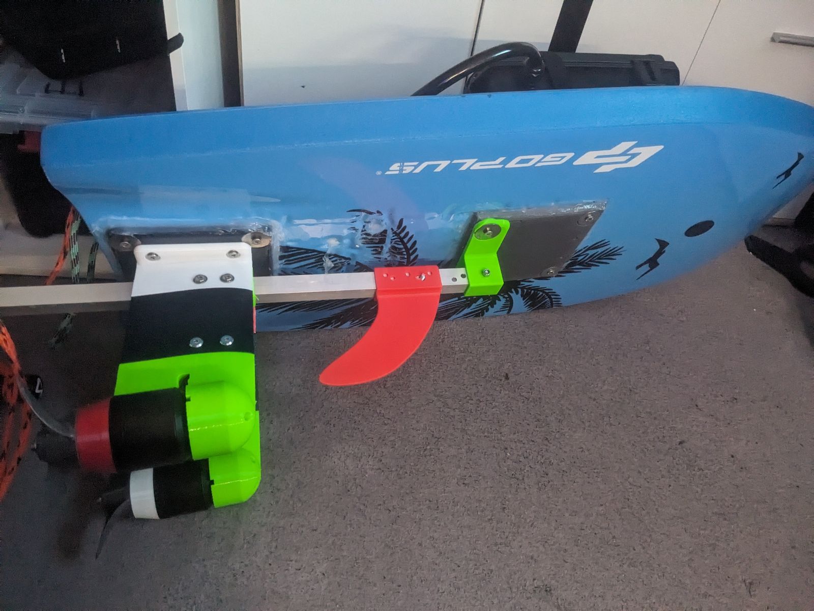

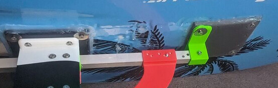

Interesting on the relative positioning of the masts and fin. (picture above).
I found the balance fine with the mast in the middle, and a fin at the back. I wonder if there is a general need to have two vertical stabiliser surfaces, and in your case you have the mast at the back, in mine the fin at the back.
Also interesting that you have angled motor mounts. This was something I was hoping to try, including angling to reduce the motor induced roll. I wonder if you could remove torque roll at cruising speed by tuning the pitch and yaw angles of the motor mount (in your case dual motors remove the yaw need)
I found out that I specifically need a vertical distance between motor and alu profile where my hook line is, to be around 22-24cm to have pitch stability and enough force to get me on foil.
I have a solution with alu profile on top right now and an additional end cap with a lowered hook to regain my distance I mentioned above, again.
Will test tomorrow and post pictures.
And I moved the motors forward by 18cm. Im curious if I get more roll stability then.

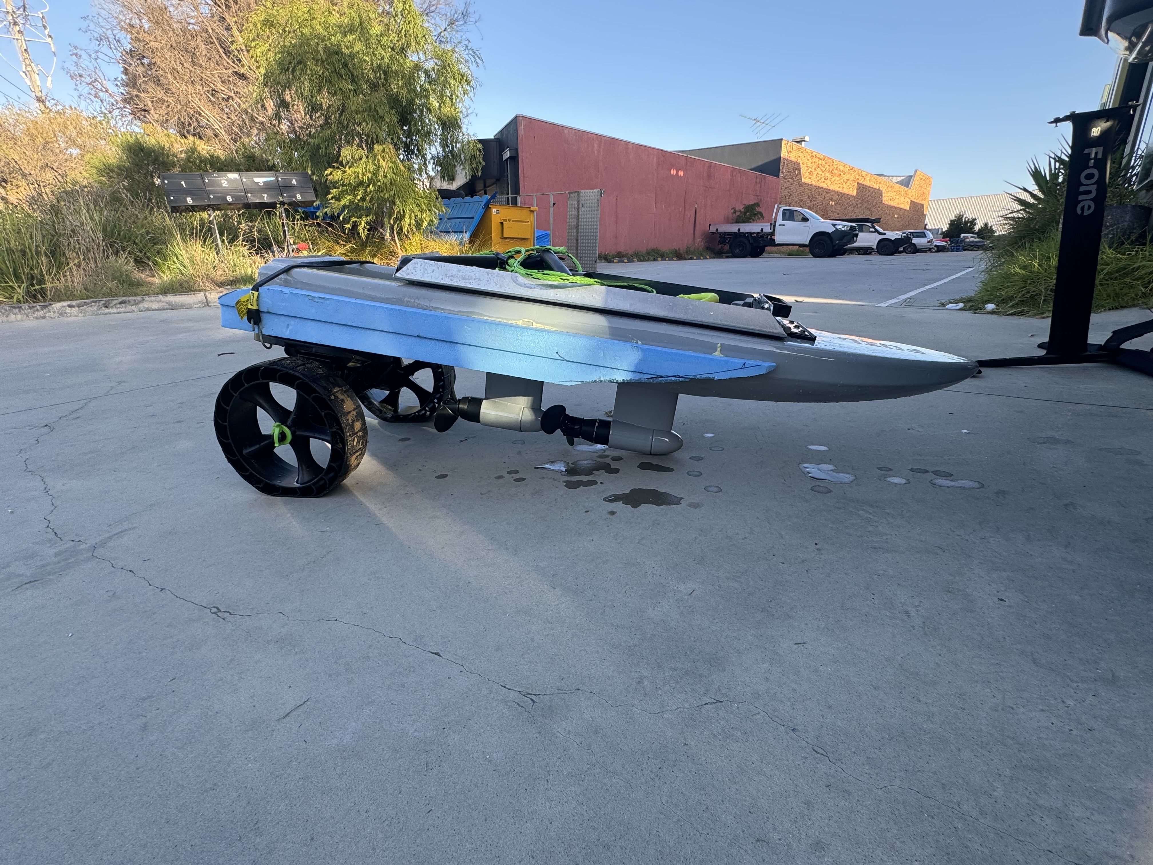

Continuing the discussion from My Tow Boogie Build 2025:
Hi Chris - great job on the build .
i have been on my own build for a couple of years now with 47+ tests on water for perfect displacement/planing hull design in choppy conditions and have come up with a great hull …
Im building moulds for it now…
i have beaten the stability issues / cavitation isses as well as designed an effective prop guard that protects the props and allows the unit to sit flat on the ground… ive been testing it by driving the boogie up beached and boat ramps at full power - hehehehe-
esc overheating issues recently overcome using flipski motors with buikt in vesc 65220 - robust and powerful motors for sure… so far so good with these
some early version pics of the build before the prop guards were installed here - Its been affectionatly named as “The bogan”
