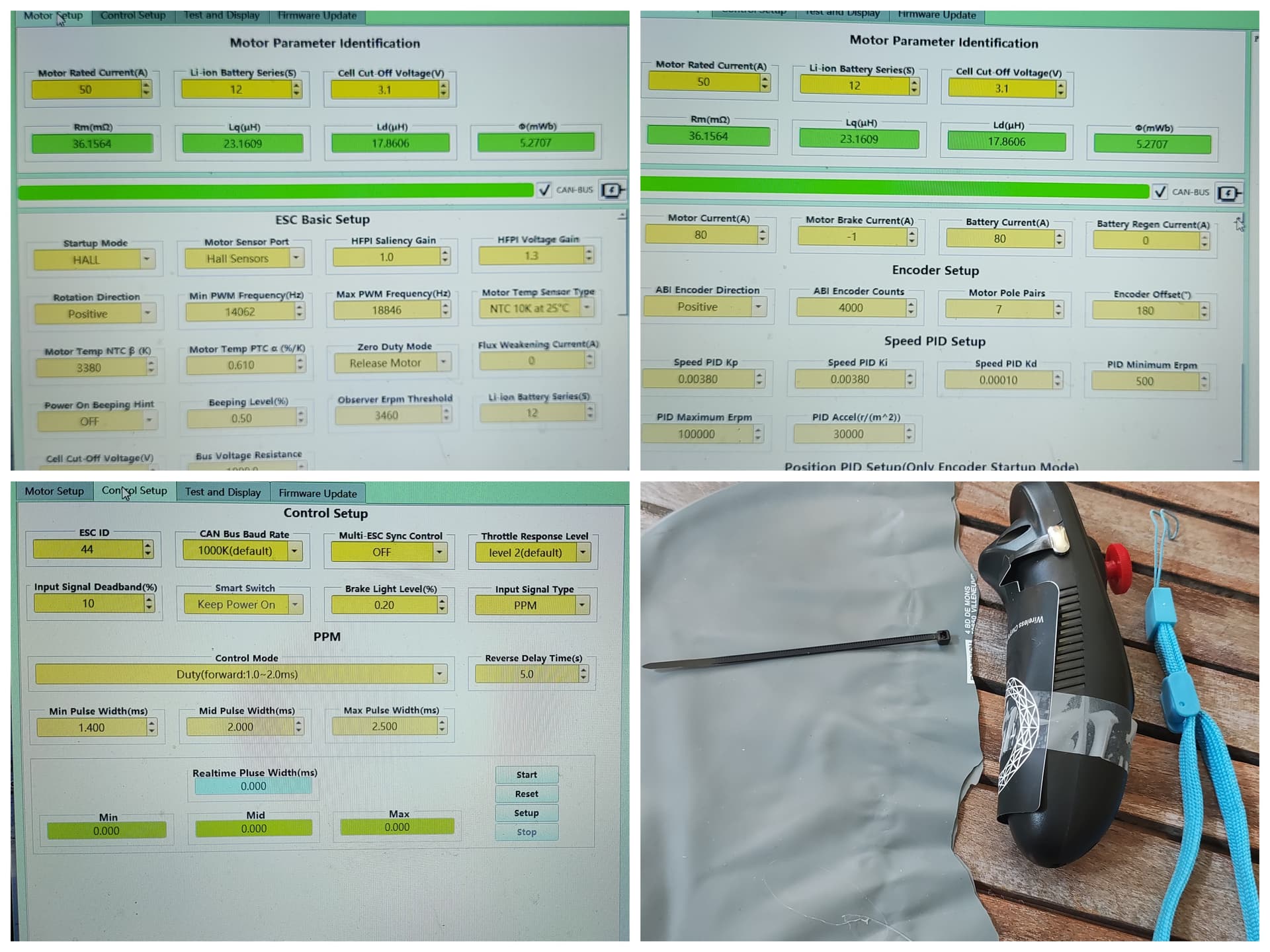

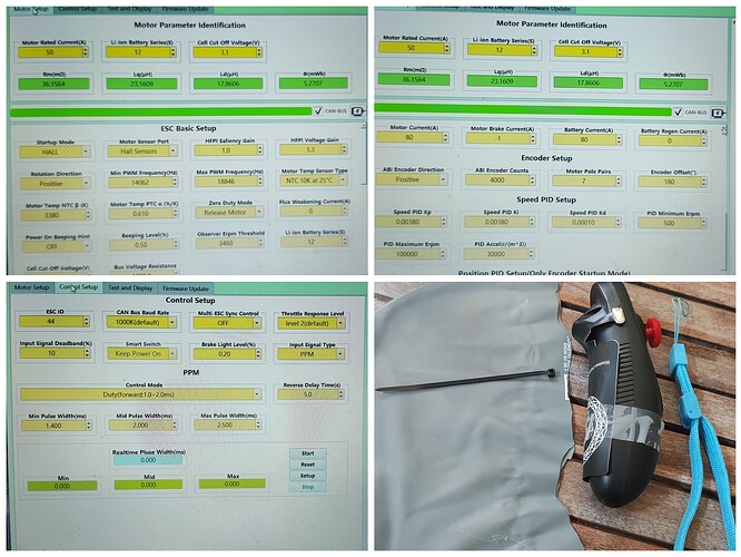

@Youpi : I did buy the same hardware : Takuma battery, ESC FT85BS, W6 and 6384.
However, the speed is not enough to take off. Maybe it come from the propellers or from the setting on the FT85BS. Which max current did you set in the ESC ?
Did you find good propellers design (with one inverted ?)
80A,

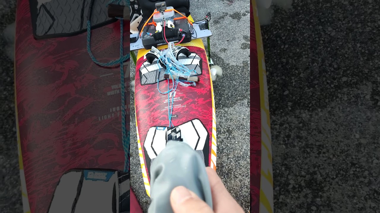

I am now using DS600 remote control with swimming cap !, far more better than W6.
PPM settings are special for this remote.

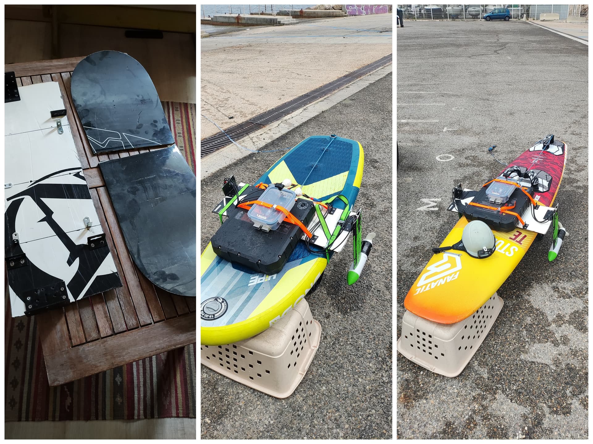

last update, I am now using a snowboard, I did try on a inflatable board, but my fanatic is far more better.
How is the performance in waves and resistance to rolling over? I’d like to try a windsurfer as they usually have a very flat tail and nice nose rocker.

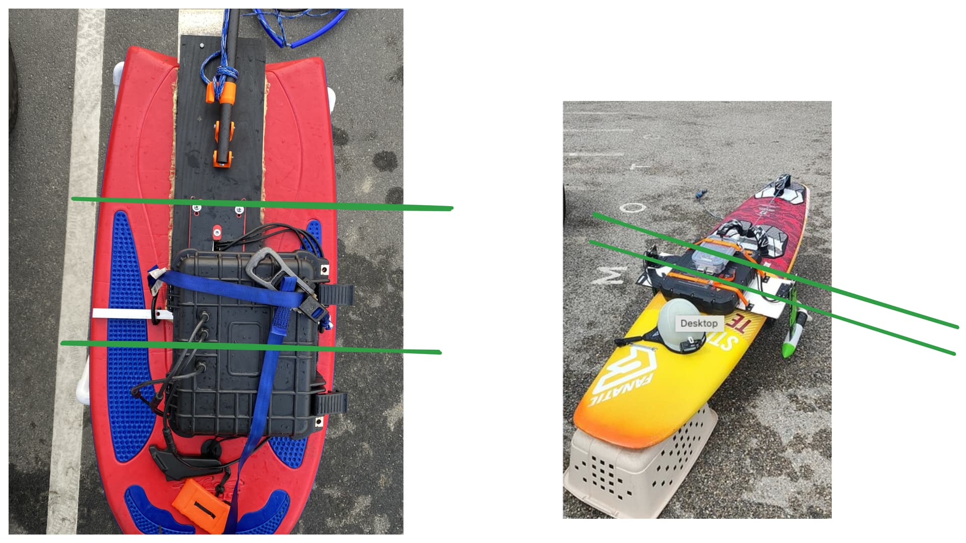

You have the COG over the motors, have you needed to trim at all?
I think that’s the easiest boogie to build if you are a windsurder.
I tested a 55cm (plate) width, it was very unstable, better like maybe +65cm, the board is 55cm wide.
I haven’t really tested it in the waves yet, maybe this summer, and I still have things to improve …
Thanks, I’d be interested to hear how it works in waves. In principle, the windsurf board is designed for going 25-30 km/h over chop, so I am hopeful that it could be great in rough conditions. In your videos. it looks very stable
Centre of Gravity, I mean this distance, between motor and battery
Is this remote used for steering? Looks like an interesting choice
I use 10 to 5kg batteries, no need to pay a lot of attention of this part on this setup.
Video of the remote control in action. It needs to be set correctly.
There’s a button that allows you to hold the throttle !

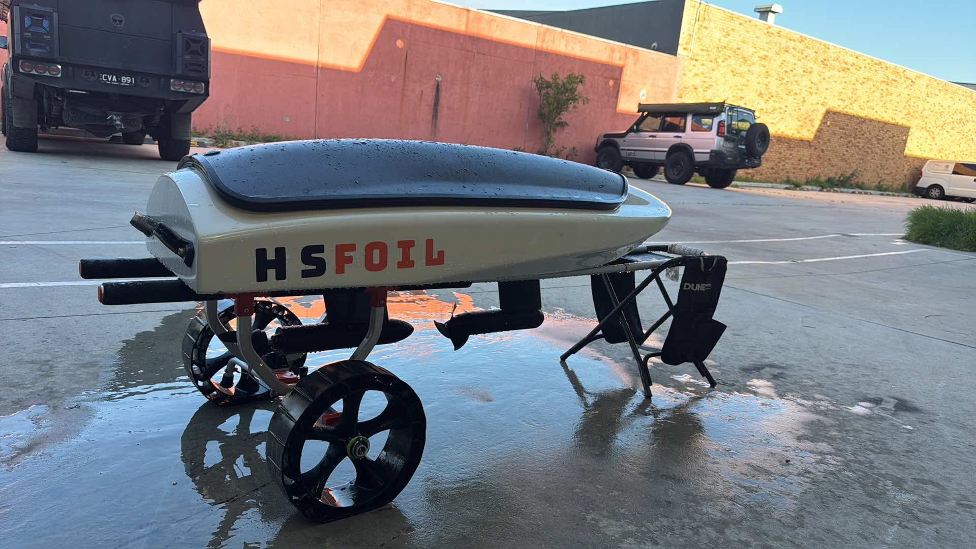

Ive ended up having to draw up my own props to get matching cw and ccw for my etow tow boogie project…
just impossible to find any thing matching from any aupplier it seems … im all ears in this one too.z
ive buikt a test tank - so i can test my ones this week in 3d orinted abs first…
expensive to metal print!!! But hopefully over time new tech wilk allow us all to get affordable access to metal printers …
