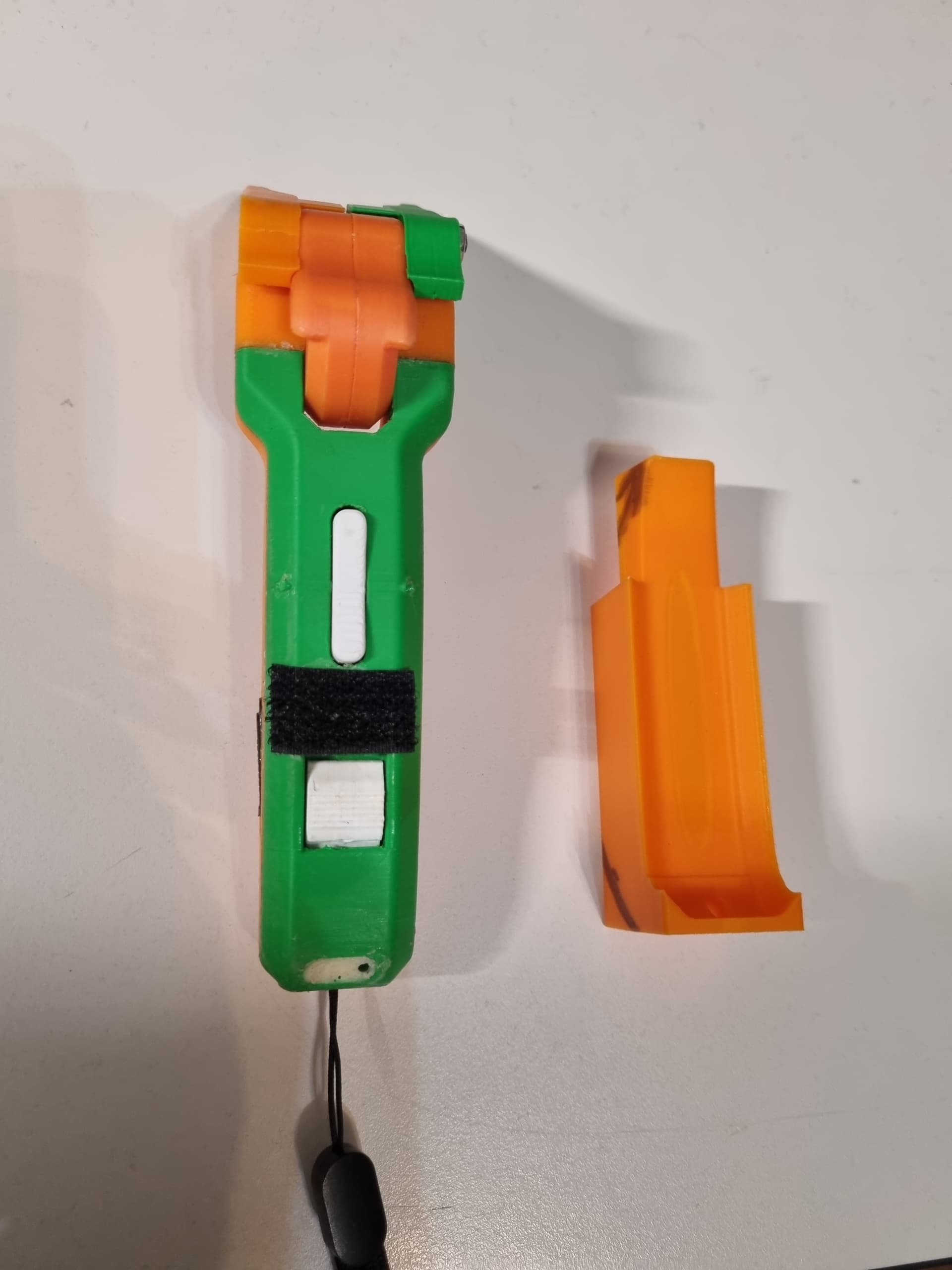

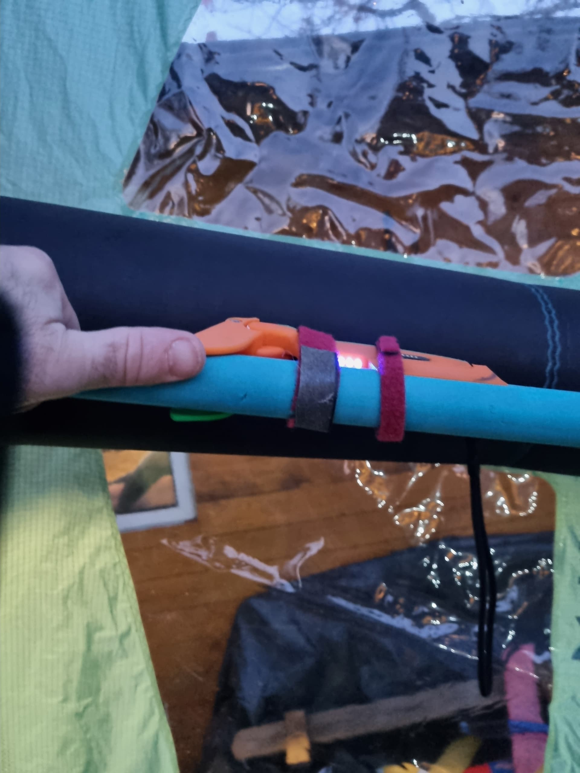

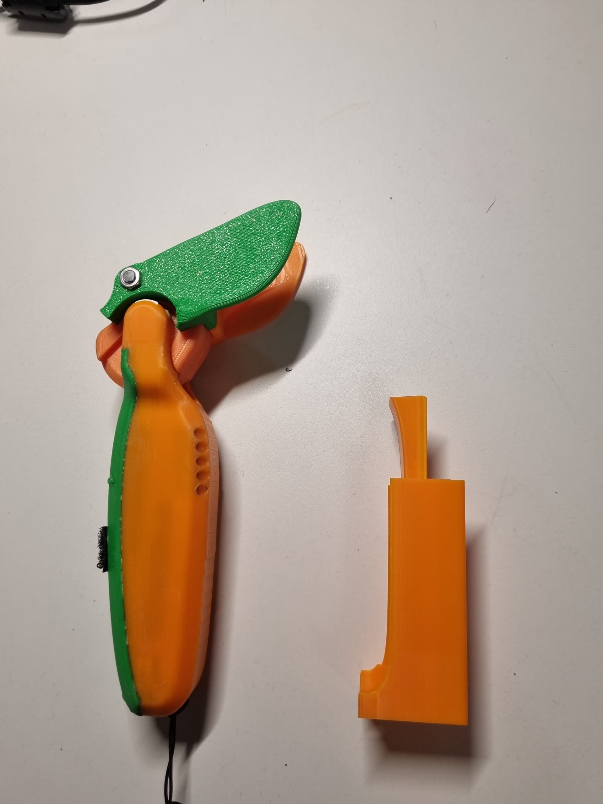

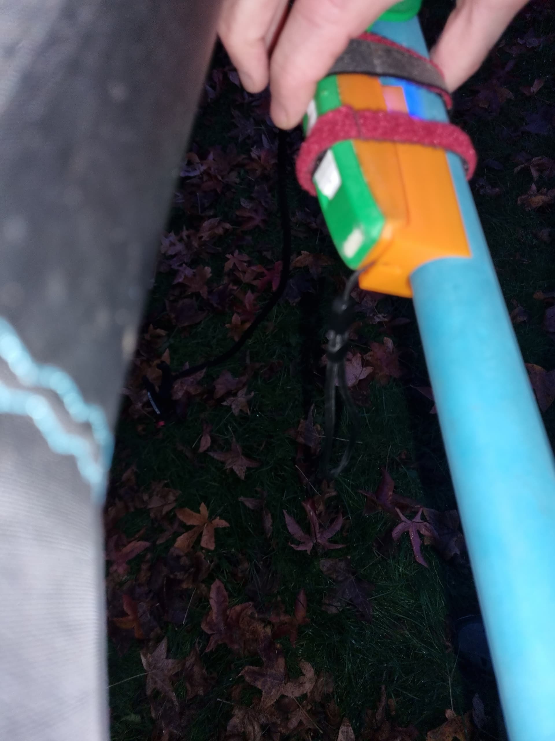

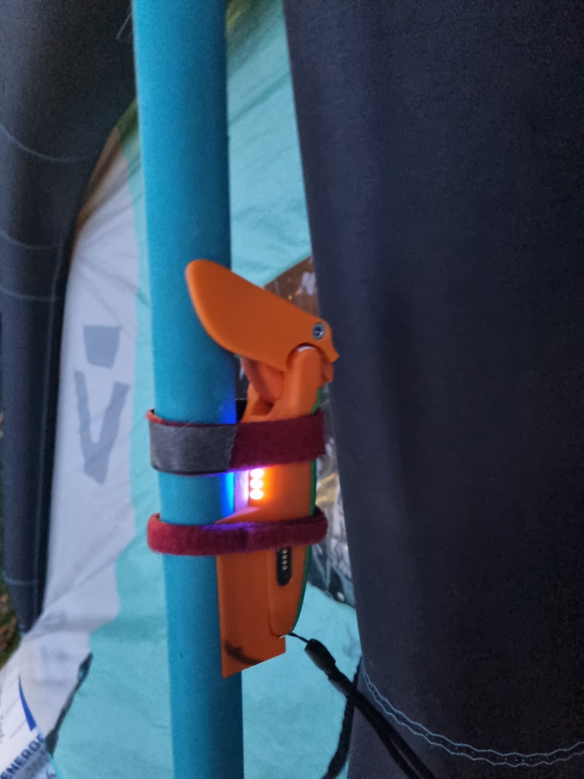

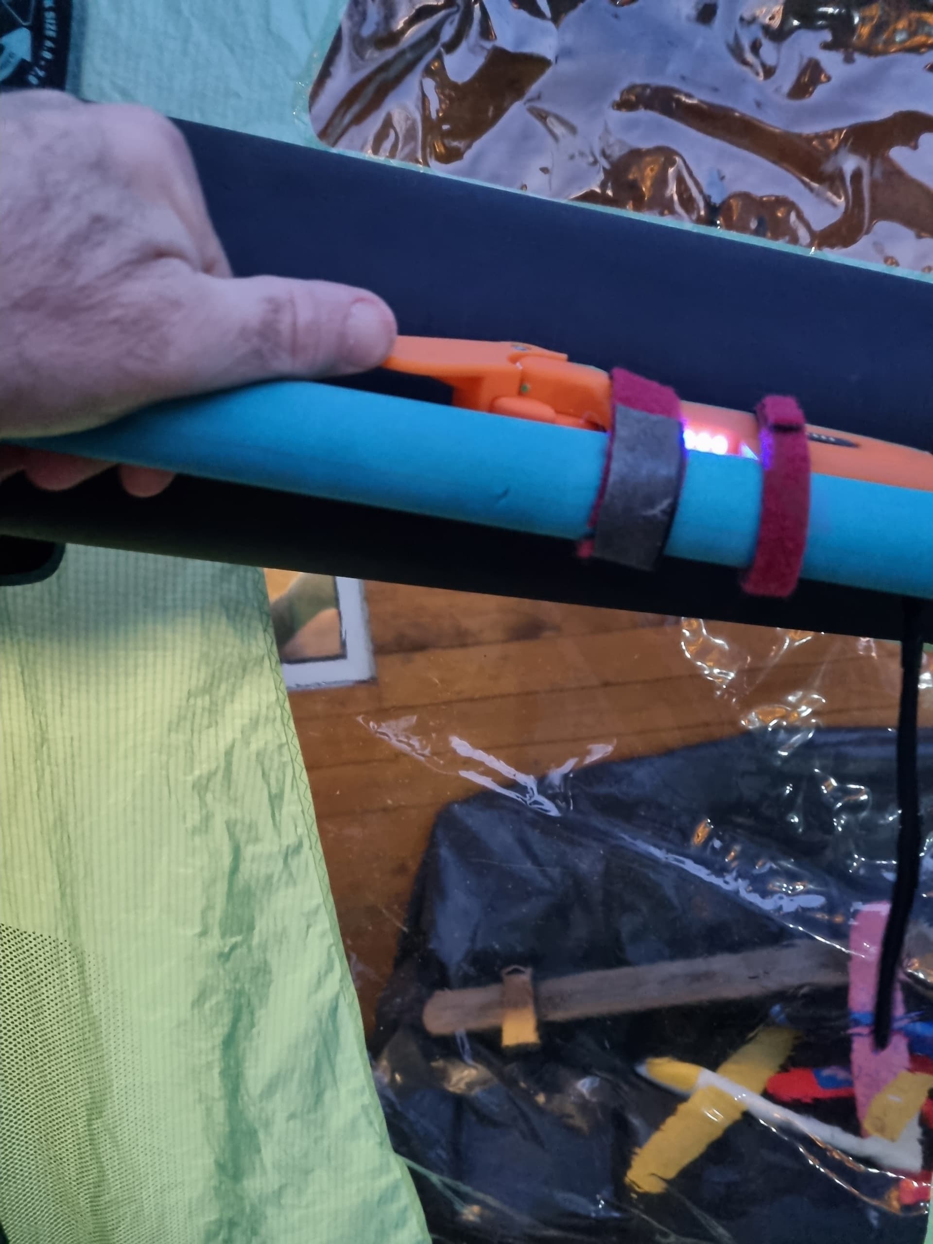

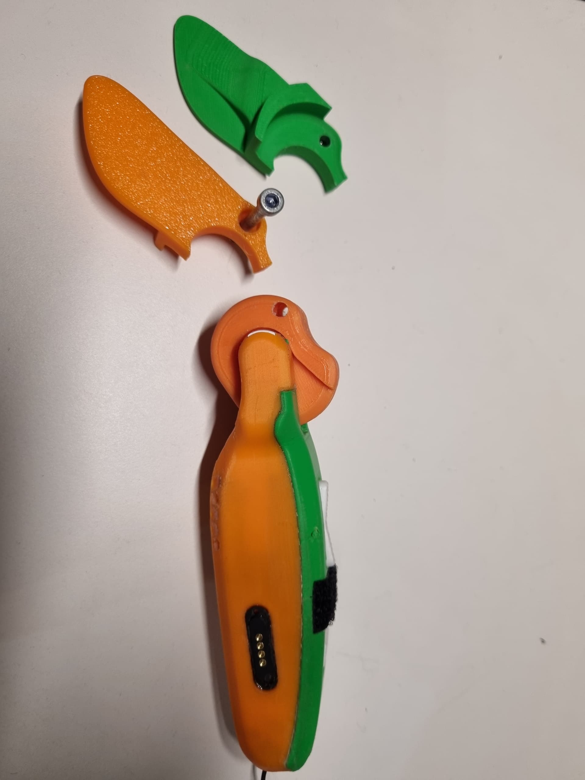

I wanted to use my foil assist system with a Wing to be able to get up on foil at lower wind speeds. Regular remotes are rather clumsy and difficult to hold and manipulate if you are holding a wing at the same time (see my post Foil Assist with WIng). I found the magnificent Nano Version of the Bremote and made an adapter to attach it to the boom of my wing. I also made a bolt- on special lever for winging that allows you to manipulate the remote with your thumb only. The upper part of the remote body is optional. It has a slightly modified on- off switch which I think is easier to use, especially with when wearing gloves.
If one already has a Nano Bremote no changes are necessary except for a 4mm hole to bolt on the special levers.
