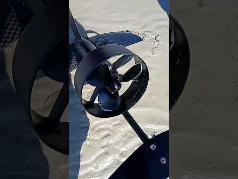

Hello, I just bought a used E-foil and it seems that I have an issue with the motor. I’ve just disassembled it; it’s a Maytech 9KW MTI65162-SF. I’m not sure if it’s really the motor, but from what I’ve read on the forum, it seems that there are recurring problems with it. Please take a look at my video to form your own opinion. I’ve completely disassembled it and it’s ready to be replaced. I’ve seen some recommendations to switch to a Flipsky motor because it’s cheaper and supposedly has fewer issues, but I’m a novice and I’m not sure which one to choose, and I don’t know if it will fit in the same location and accommodate the screws in the right places. I also noticed that the model similar to my Maytech only has 3KW, which seems low for an E-foil. When the Maytech was working well, it had good performance. Anyway, I’m feeling pretty down because I’ve only been able to use my board for 3 days, and now I’ve completely disassembled it and will struggle to put it all back together. Any help would be appreciated. Thank you.

You also can’t post video directly here just photos so your post does not allow anyone to view your video. Perhaps edit your post to include a link to the video.
The video seems like either a phase wire is missing or shorted, or the ESC has some problems…

I guess your issue is loose magnets inside the motor just based on the sound. If it is then don’t run it anymore, you can damage the esc since then, effectively, it’s not a motor anymore to the esc.
