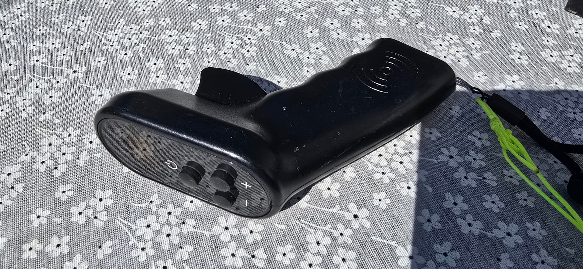

Need to find a replacement for ErayFoil remote control
I have now replaced my ErayFoil remote control several times. But what should I replace it with, that last longer? Reciver I guess needs to be replace even if it is OK
Allways been carefull with the controller… but they does not last

Actually, the repair isn’t a problem. Replacing the battery is easy, as are the two magnets on the gas button. You can also order a replacement. Notneasy to find another one with 50 gears
But if the battery has 4.3 V and the display still only blink with empty batteri when you try to power on… wires look good… What to do?
