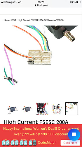

Good point about the remote - I do have the Maytech remote with a display so will use the uart port for that. Having trouble to figure which cable from the VESC to connect with though as there is no documentation to speak of describing what all the unmarked cables coming out of the rubber sealing is to be used for. Any tips on which cable I will have to connect to my TXD and RXD pins on the receiver?
Okay, got it working once I figured out the logic behind all the cables, thanks for the help.
This is how the setup looks, and now I can get full info through vesc in the remote controller window.
