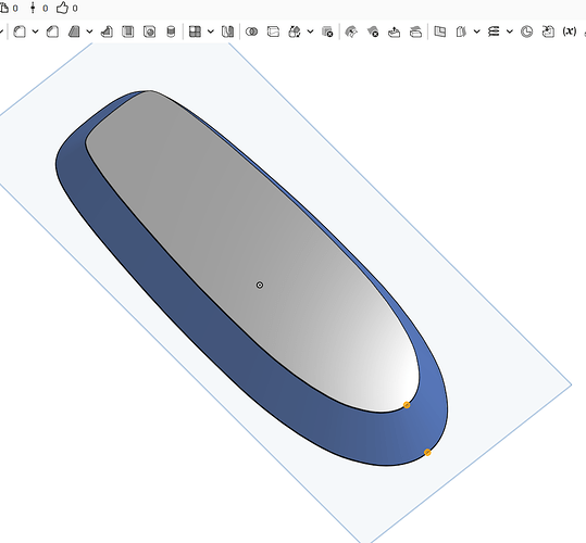

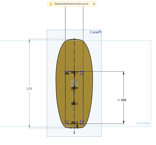

Redesigned to 5’x24.5" or 153x62 cm. Thickness same. Volume 90L
Also shape contour taken from fliteboard. But without nice rails and etc its still look ugly but I hope it will work

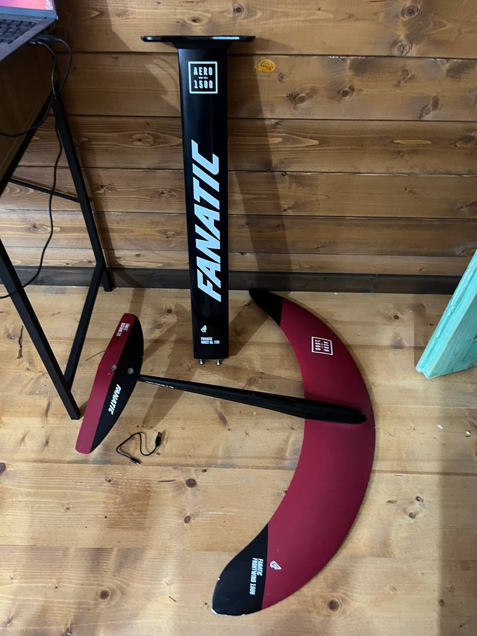

Found this set 1500 front and 320 rear. All together for 150 euros. Seems like a good option

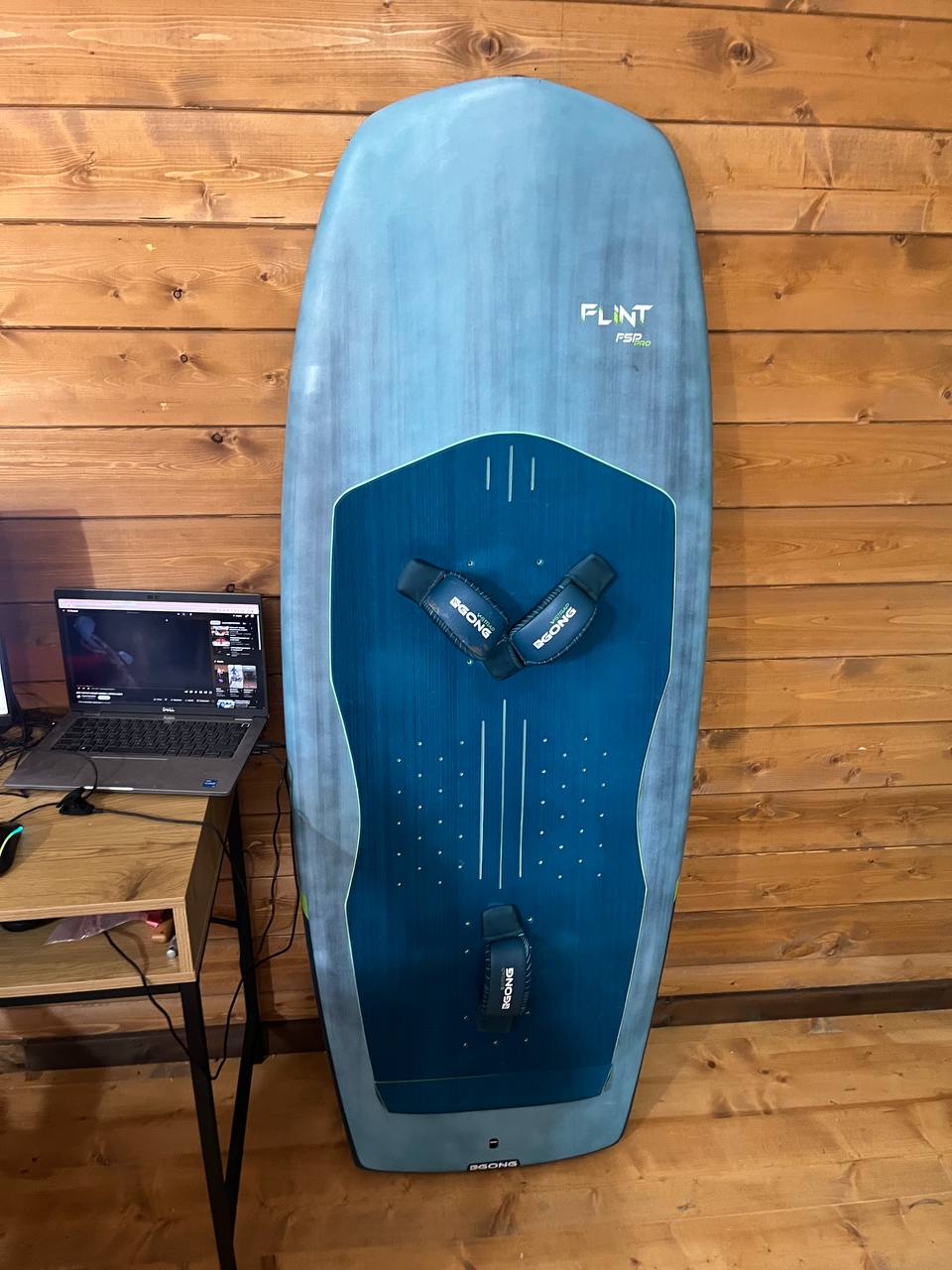

Got used 95L board for 340 euro

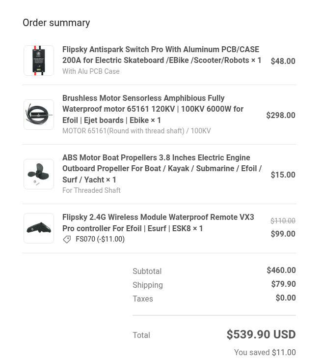

Also made order from flipsky. ESC and some other stuff on the way from aliexpress
The prop is definitely no good.
Try to change it to the white Yamaha prop. It’s the same price.
