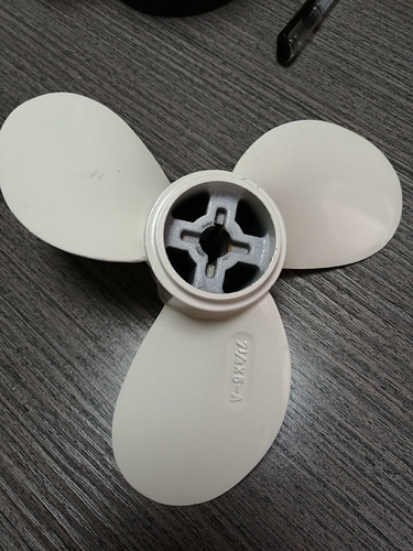

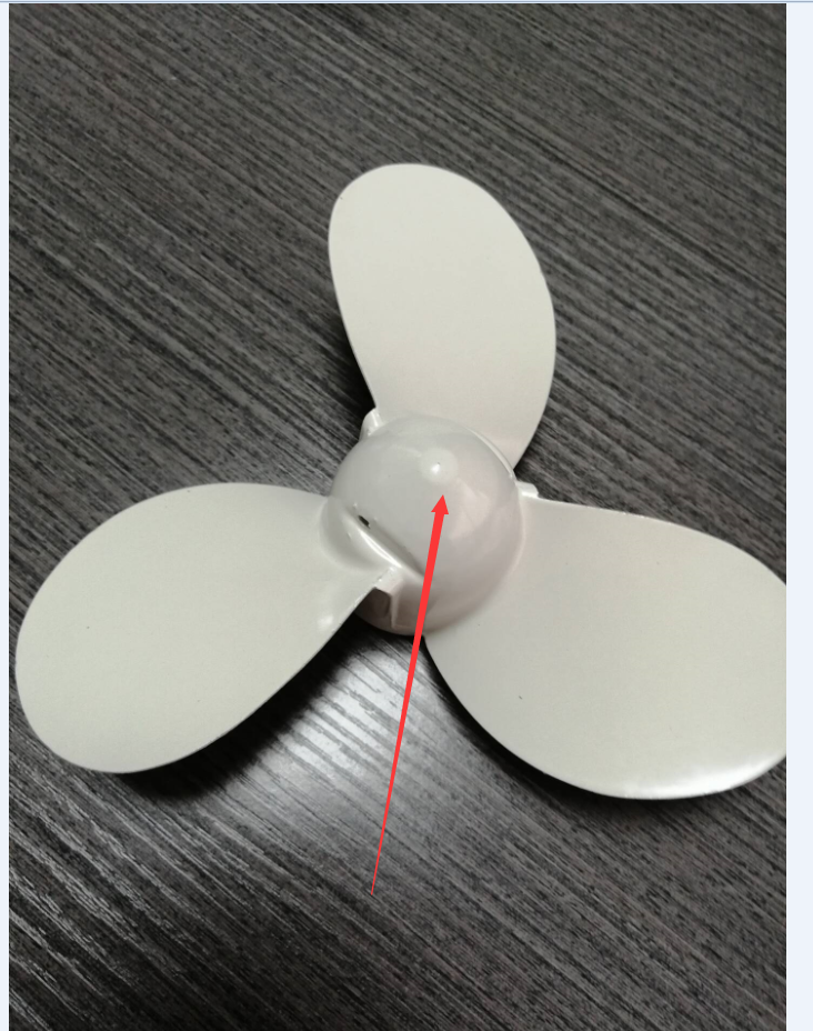

Hi,virus. Why is my 140mm diameter yamaha propeller different from yours?Is the fixing hole processed by you?
Hi Benson 7 1/4inches = 184.15mm which is what the propellor is when you buy it. Virus then cut his down to 140mm.
Same. Put painter tape over blade to trace outline. Peel off, trim, and use as template to cut with dremel. I also drill the hole to use airplane prop adapter for 8mm shaft.
@chilepin, you should use left hand thread, otherwise the nut might open, as the torque is not transmitted by a torquepin.
@virus, you make such beautiful parts! Please fill that gap between motor and prop with some conical part.
https://www.rcgroups.com/forums/showthread.php?919392-Left-Hand-Thread-Prop-Adapter-for-Pushers
The nut hasn’t been an issue. I have some torque slippage but it’s from the shaft coupler.
