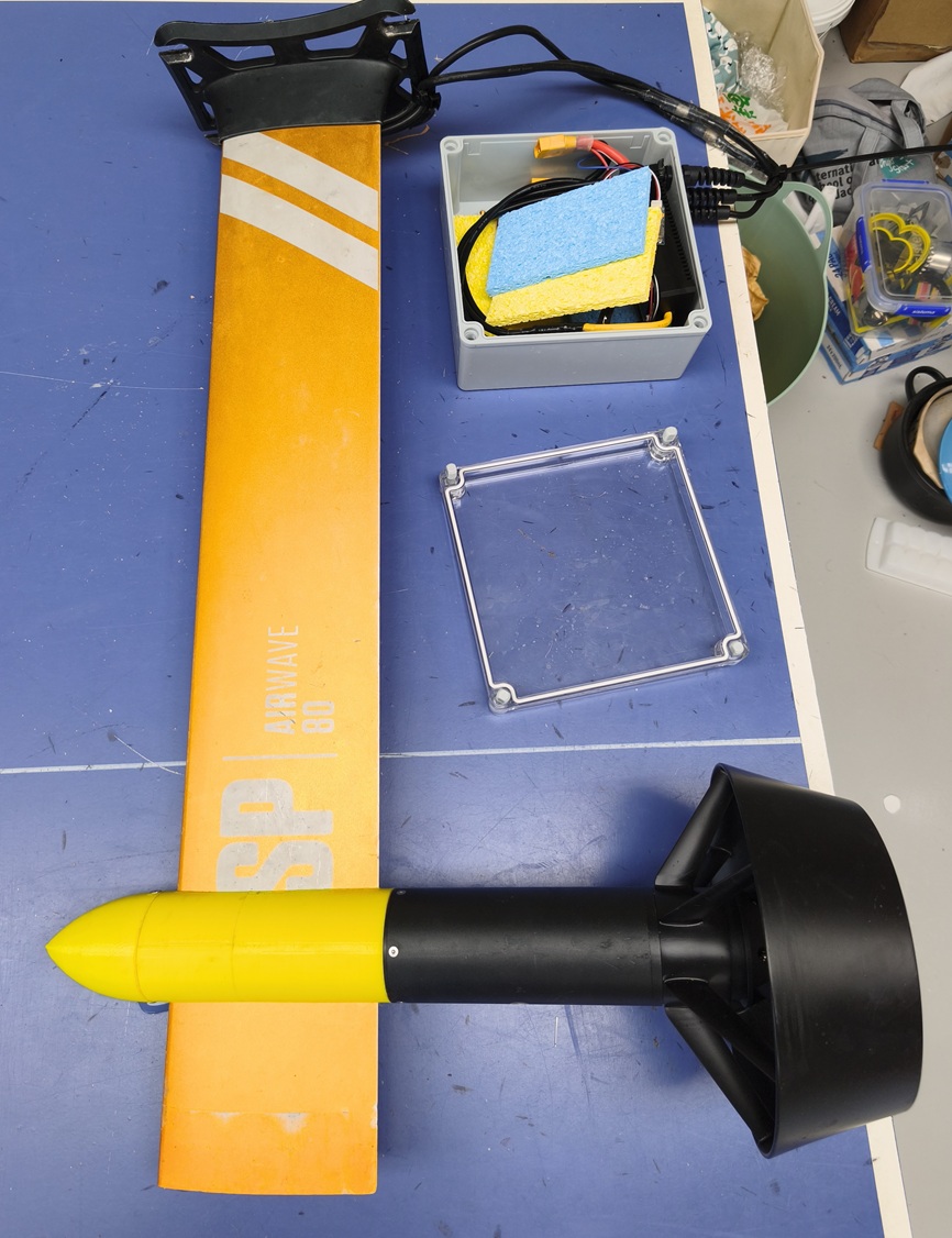

Couple of pics attached.
Tow foiling with this setup balanced well. Feet where the foot straps bolt holes are (Not installed) and slightly more pressure on back foot.

Actually another change is the weight of the motor and batteries, esc box which is all at the back. Maybe another 6-8 kgs right at the back.
Pitty I have run out of room on the mast track. Just feels like it needs to go back another couple of inches.

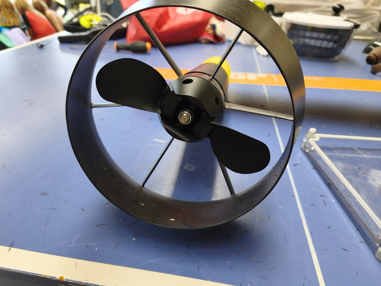

Looking at the photos, it looks like the prop guard pointed downwards?
Choice of duct and prop are not good for full Efoil use.

Take the duct off
Buy a good three blade fixed prop (Flite)

I would try without the prop guard first and also consider getting a smaller foil.
Will take the guard off and try my 3 bladed prop next time for sure.

The white aluminum prop from Flipsky is too big so not worth trying as is.

Yes I will remove the prop guard. I put it on for first test. Letting the throttle go is a natural thing so not worried about hitting the prop.
