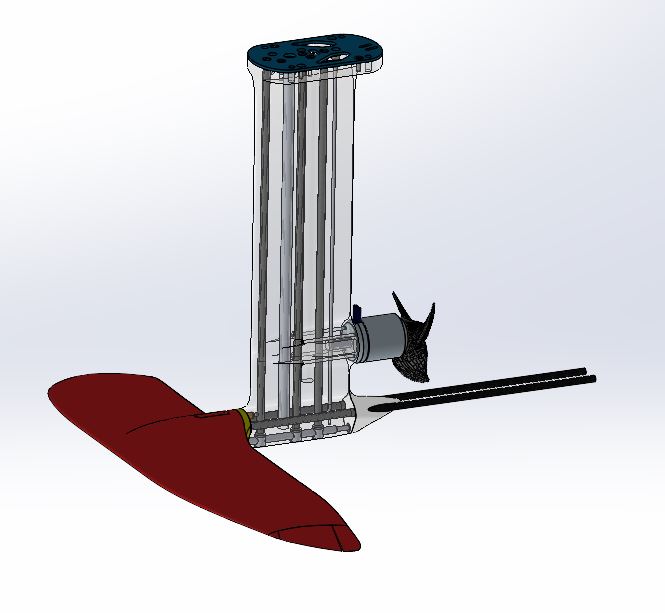

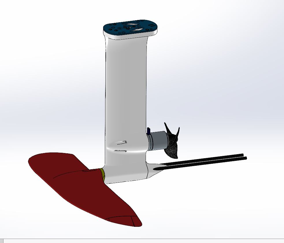

I designed the mast and the wing so they can be 3D‑printed. The fuselage will be integrated into both the mast and the wing. The wing is around 1300 cm², but my 3D model is scalable, so I can still change my mind and increase the surface if needed. The mast is only 55 cm long because I already have some 55 cm carbon tubes in stock.

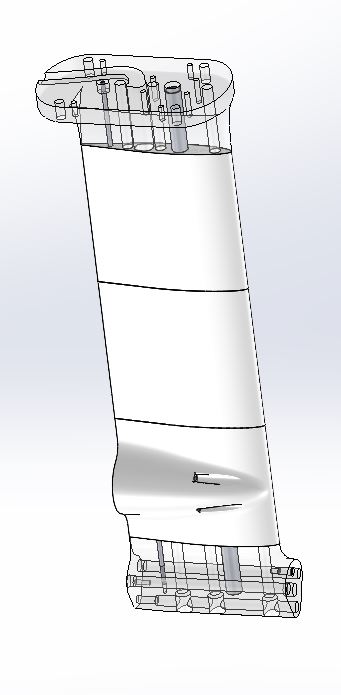

The mast is made of 5 (or 6, depending on the final length) parts. The three central parts will be glued together using a Ø16 mm and a Ø5 mm aluminum tube. The 16 mm tube provides rigidity, while the 5 mm tube is only there for alignment. Once the three pieces are glued, I will laminate them. The base and the fuselage will be laminated separately.
The mast will have 3 carbones tubes Ø10 and a Ø16 and Ø5 aluminium tubes insides. Only the aluminum tubes will be glued. The carbone tubes will screwed from but side in order to dissamble the wing for transportation

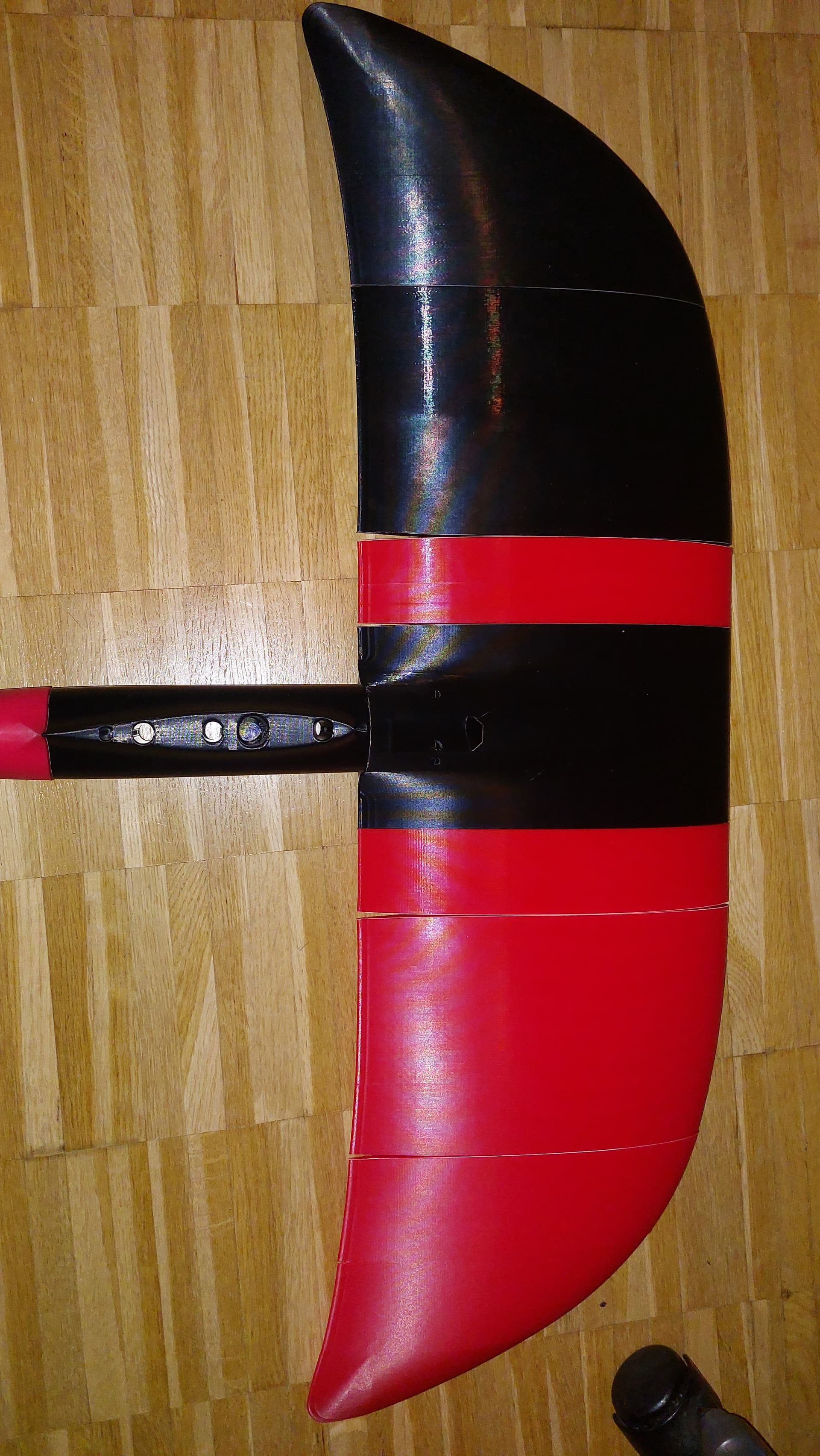

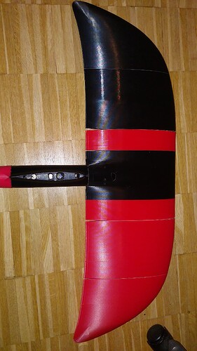

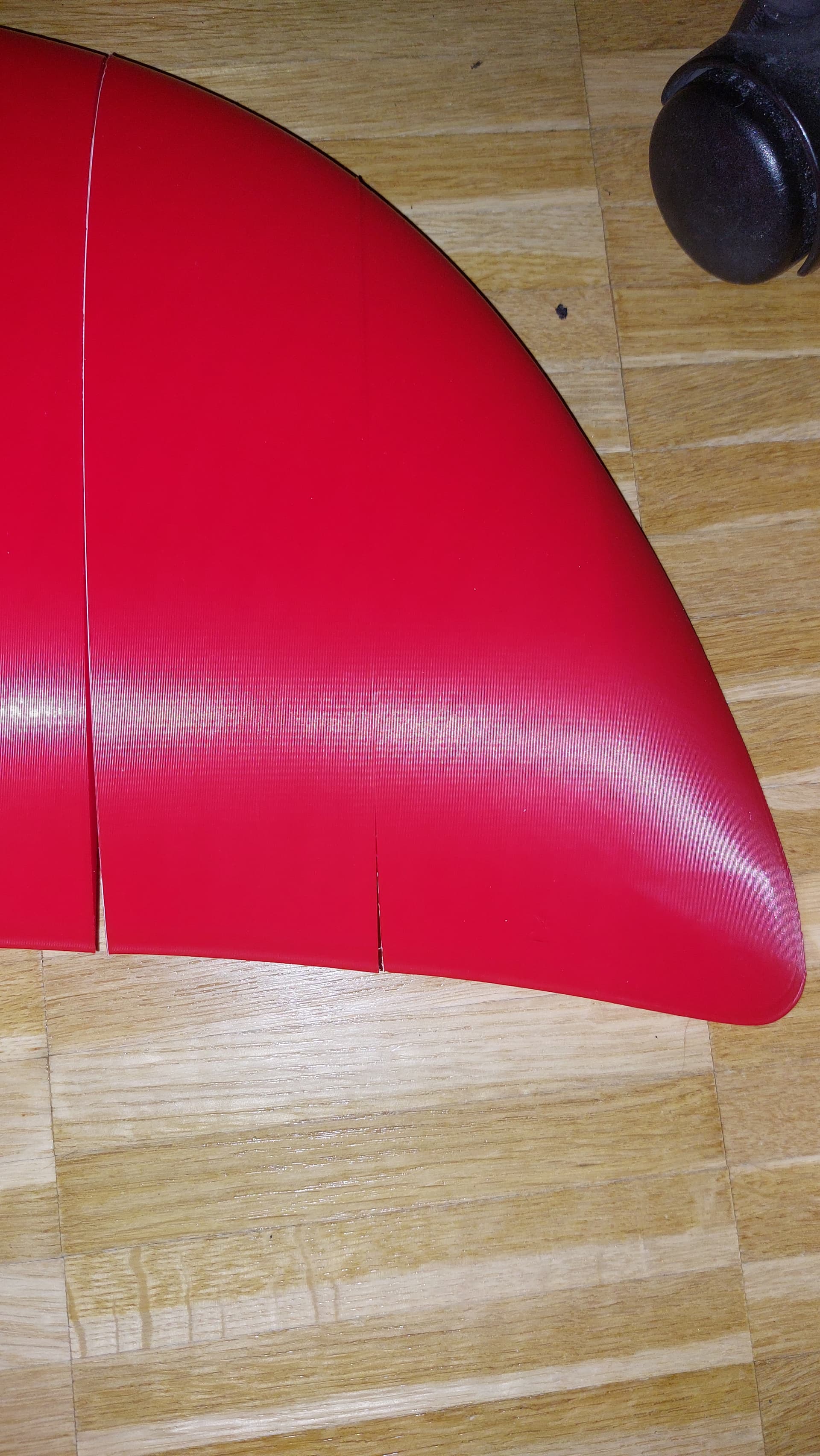

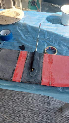

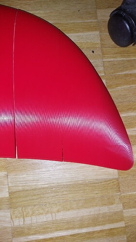

I finished to print the wing, the surface is 1600cm2

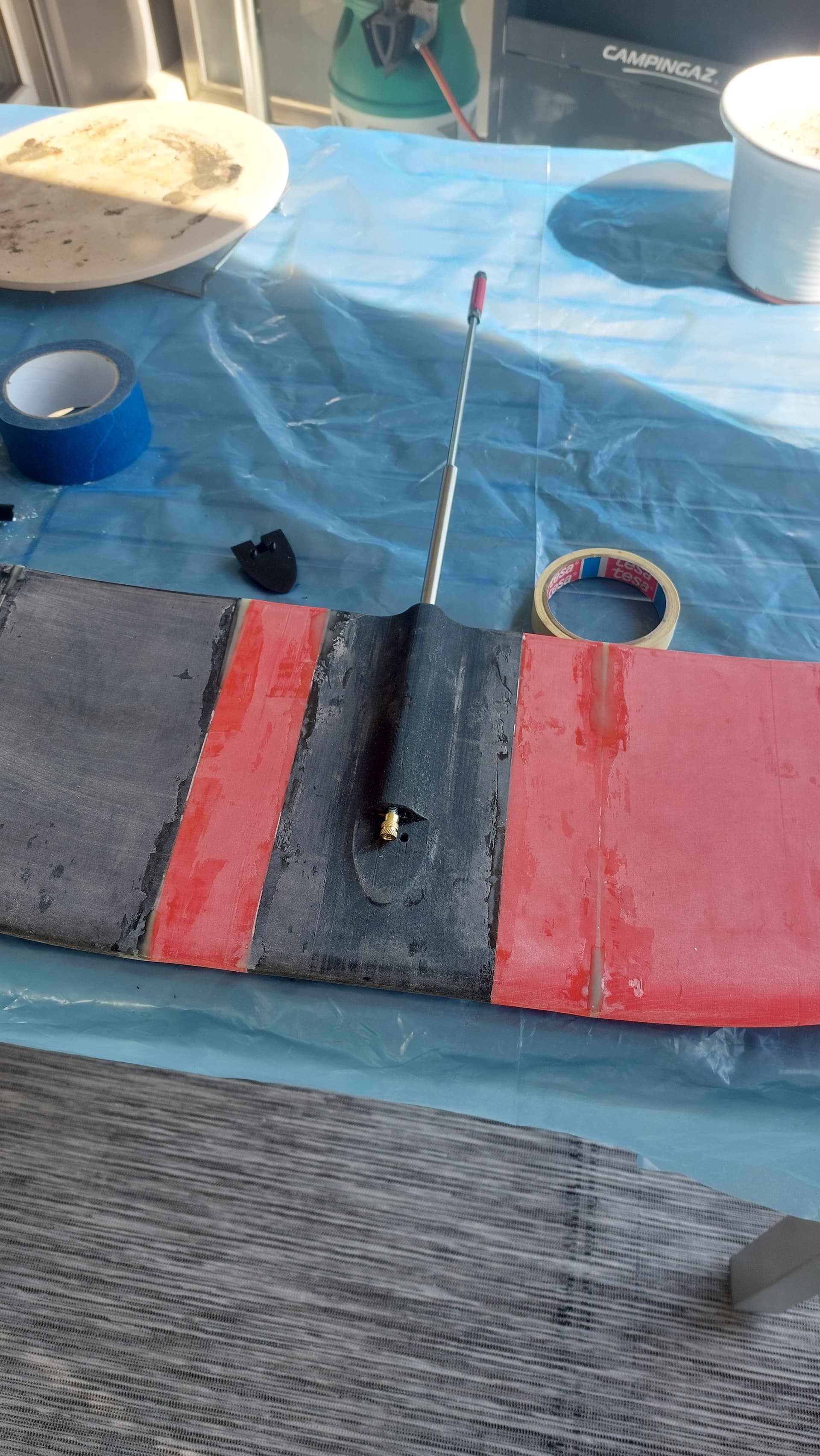

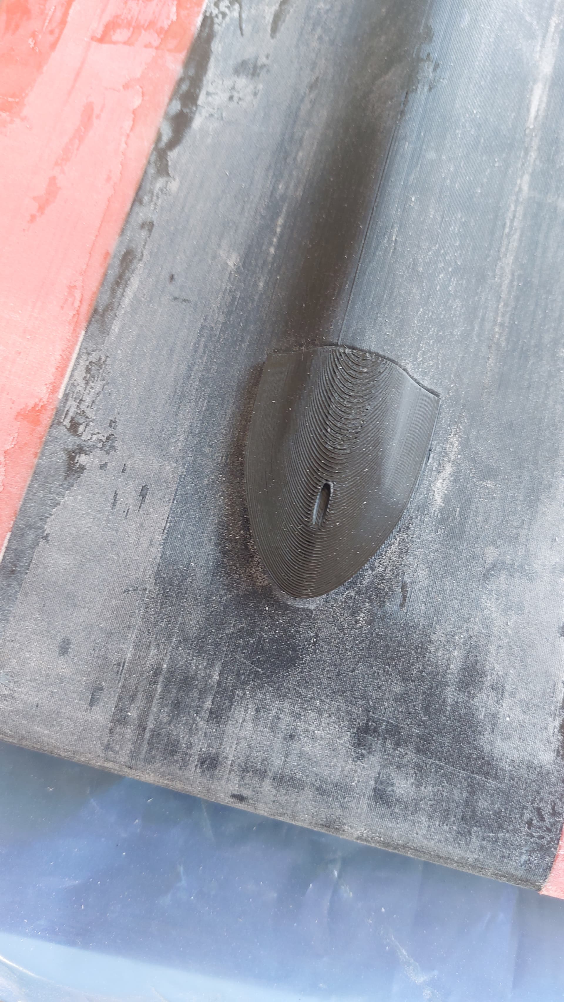

I printed it with my Bambu Lab P1s using ABS. ABS makes printing too difficult. It smells bad and warps. One part even broke.

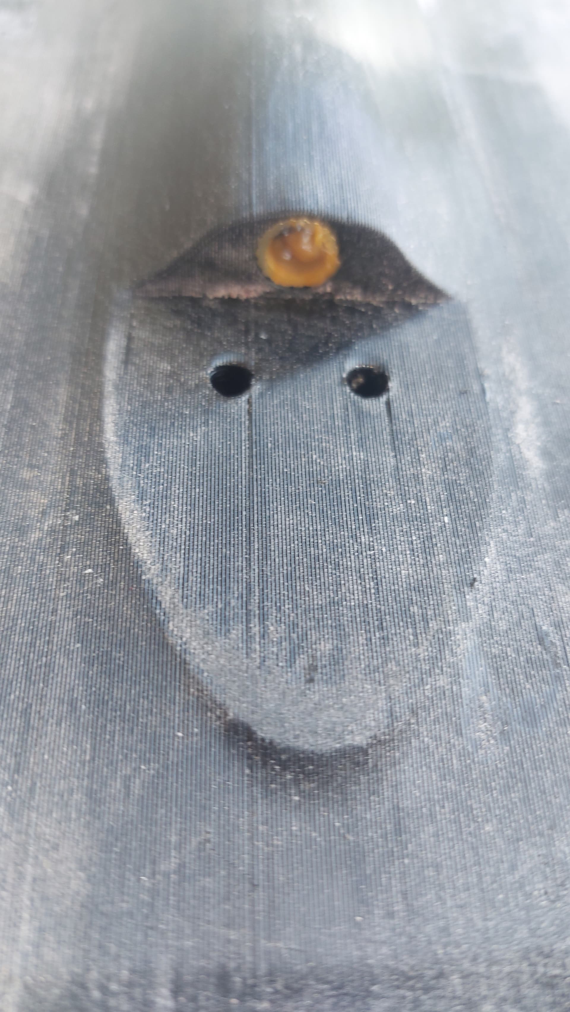

I spent too much time sanding and applying filler before adding the two M6 inserts
