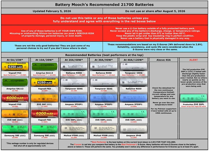

Why the EVE’s? There’s been an insane amount of critic on the cells on Facebook forum. I’ve had a batch too which discharged itself to 0 within a few months, luckily I was able to return them. Got the Reliance RS50’s instead.
There were some degraded eve 50PL pre production cells on the market, I also got some from nkon. I got a refund and ordered reliance rs50 instead. The price for rs50 is quite reasonable if you’re outside EU (like CH), 2.6€ plus shipping and tax. I haven‘t built the pack yet but the tests from mooch are promising.
Grade A 50PL production cellls are supposed to be ok regarding self discharge. I think it was those bad cells that somewhat ruined their reputation. I blame it on nkon for selling them, although they must have known.
Yeah there were quite some bad cells out there, read many bad stories on them everywhere on the facebook pages, that even Mooch (you can search him up) removed the 50PL’s from his charts/lists. Same for me, bought the RS50’s too, ive built two packs now, but havent had the time to test them in the water (well, actually, its just freaking cold). The RS50’s are one of the best cells out there right now with great lifecycle numbers based on Pajda his testing (see patreon / forums). Also, they arrived perfectly in balance and were pretty cheap if you ask me.

https://www.patreon.com/posts/removing-eve-143282155
https://www.reddit.com/r/18650masterrace/comments/1p6e1qi/difference_in_voltage_of_eve50pl_cells/
https://www.reddit.com/r/ConvoyFlashlights/comments/1r37j3r/eve_50pl_from_convoy_selfdraining/

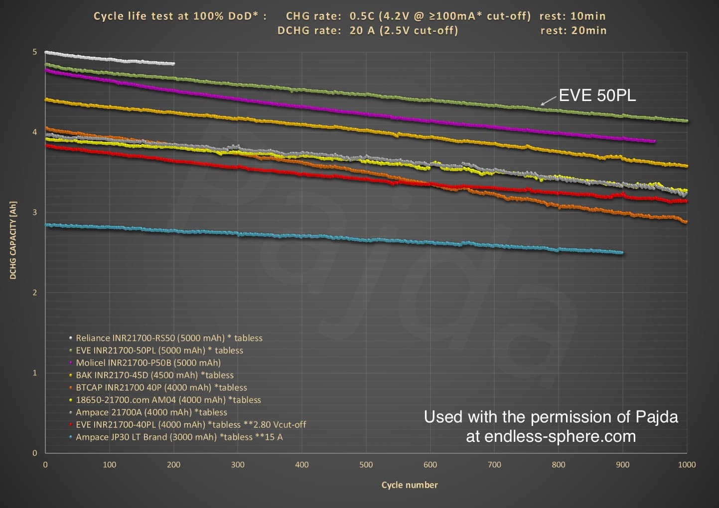

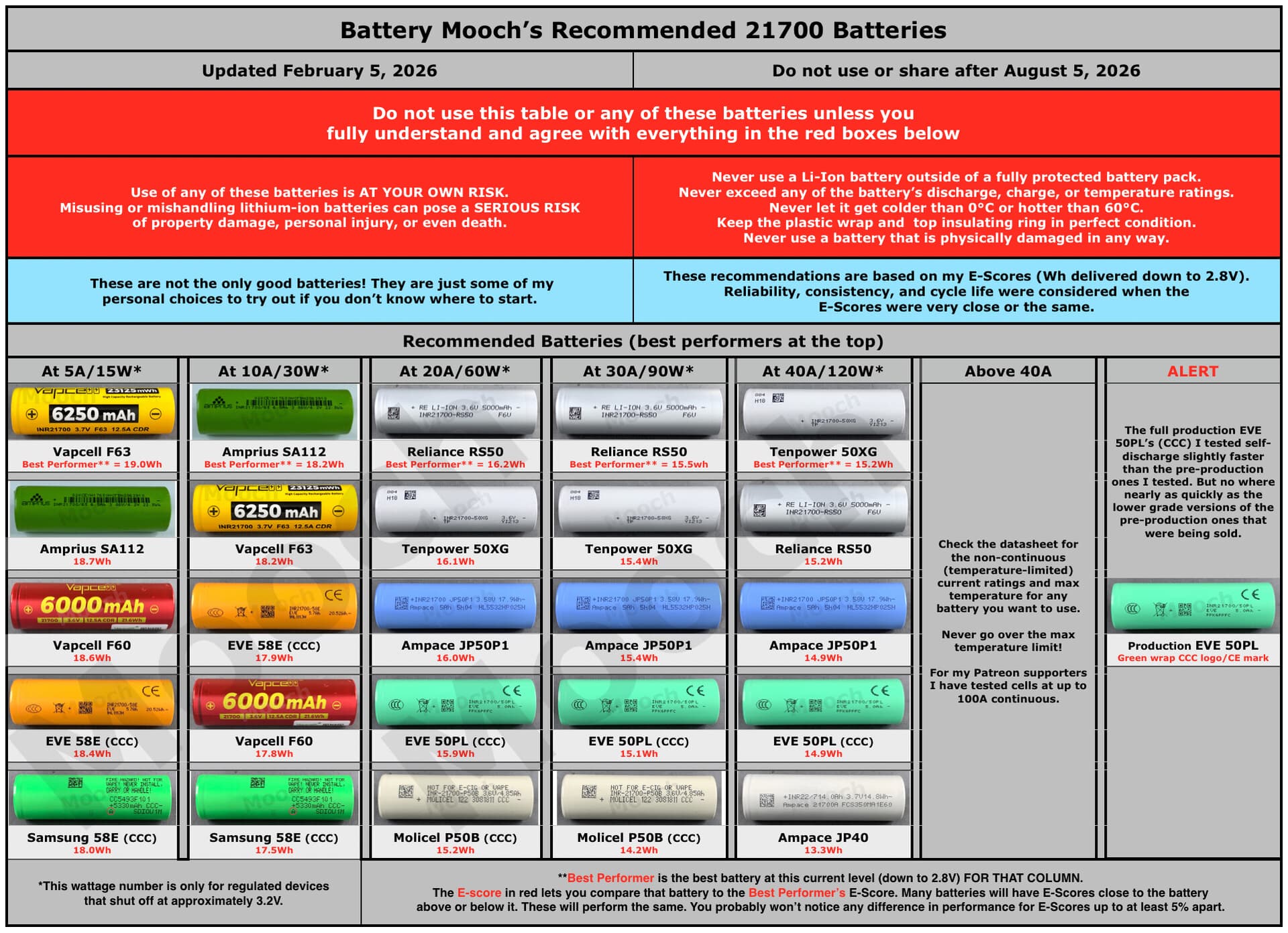

The Reliance RS50’s can do 30A continiously, but i doubt youll be pulling that, in a 14S10P config that means you are pushing 300A (10x30). THe most ive seen with battery current is like 100-120A. Battery current isnt the same as motor current!
See below a littel data sheet with the RS50.
Big credits to Pajda for the testing, I copied this from google pictures, but this remaisn intellectual proerty of Pajda.
And def check this sheet out:
