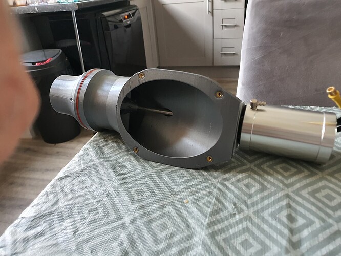

@JetboardCologne That looks great You have done a an amazing job with that the impeller is my other target that I need to look at as I’m not convinced 6 blade prop is efficient looking at space between blades and pitch.
