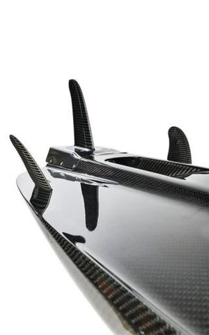

Ah I see. Yeah put some futures fin boxes in. Fins are a huge plus when turning and you can also experiment with different sizes.
Yes so true about the fins. but where do we put them?
Same with the foot straps. We would love to put some on… but again. where exactly.

Like the look of that. Now I need to find fin boxes (whatever they are called).
Any suggestion where to get them from?
These are the ones I use in my surf as they are quite a bit stronger than the FCS.
