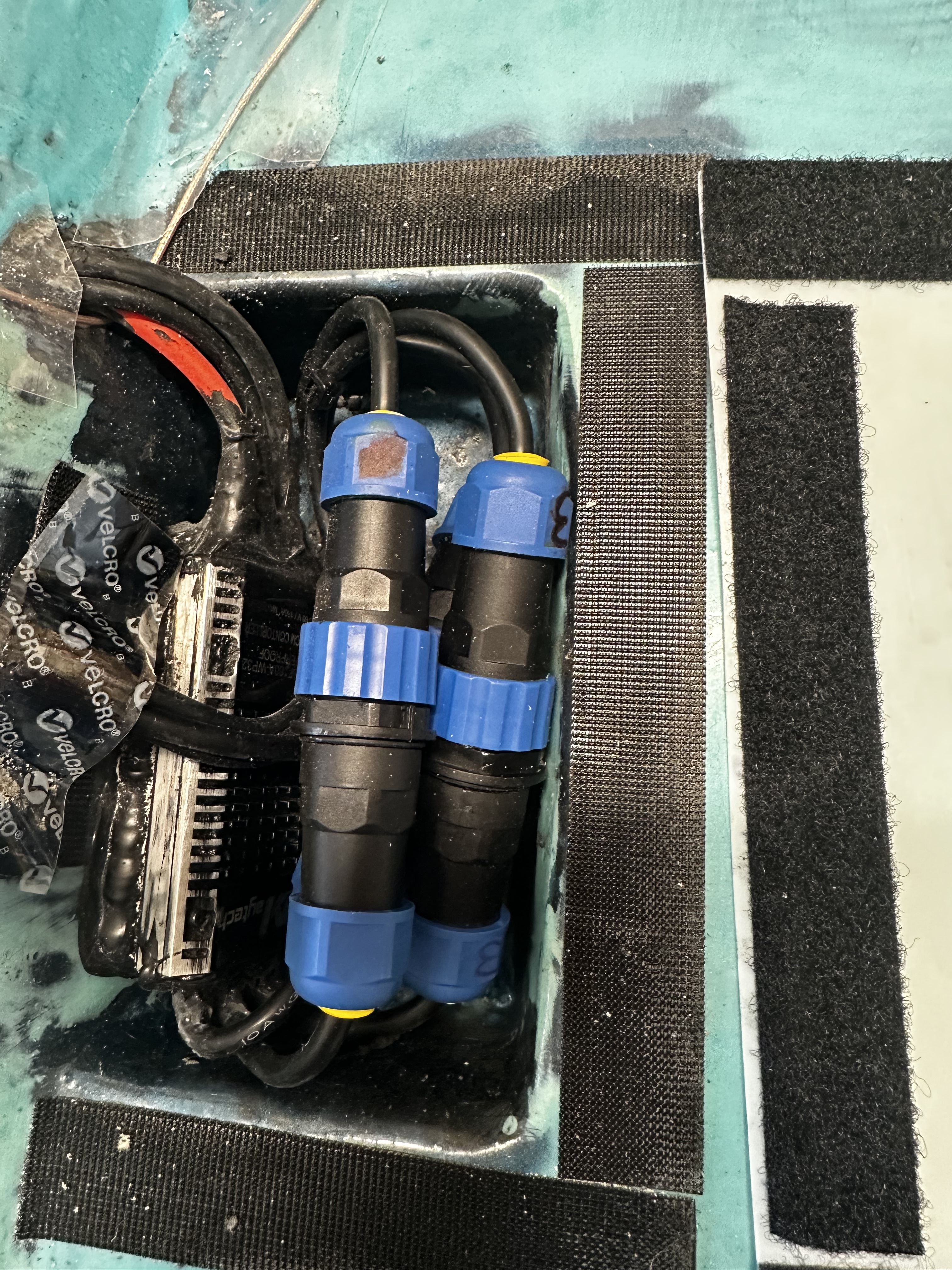

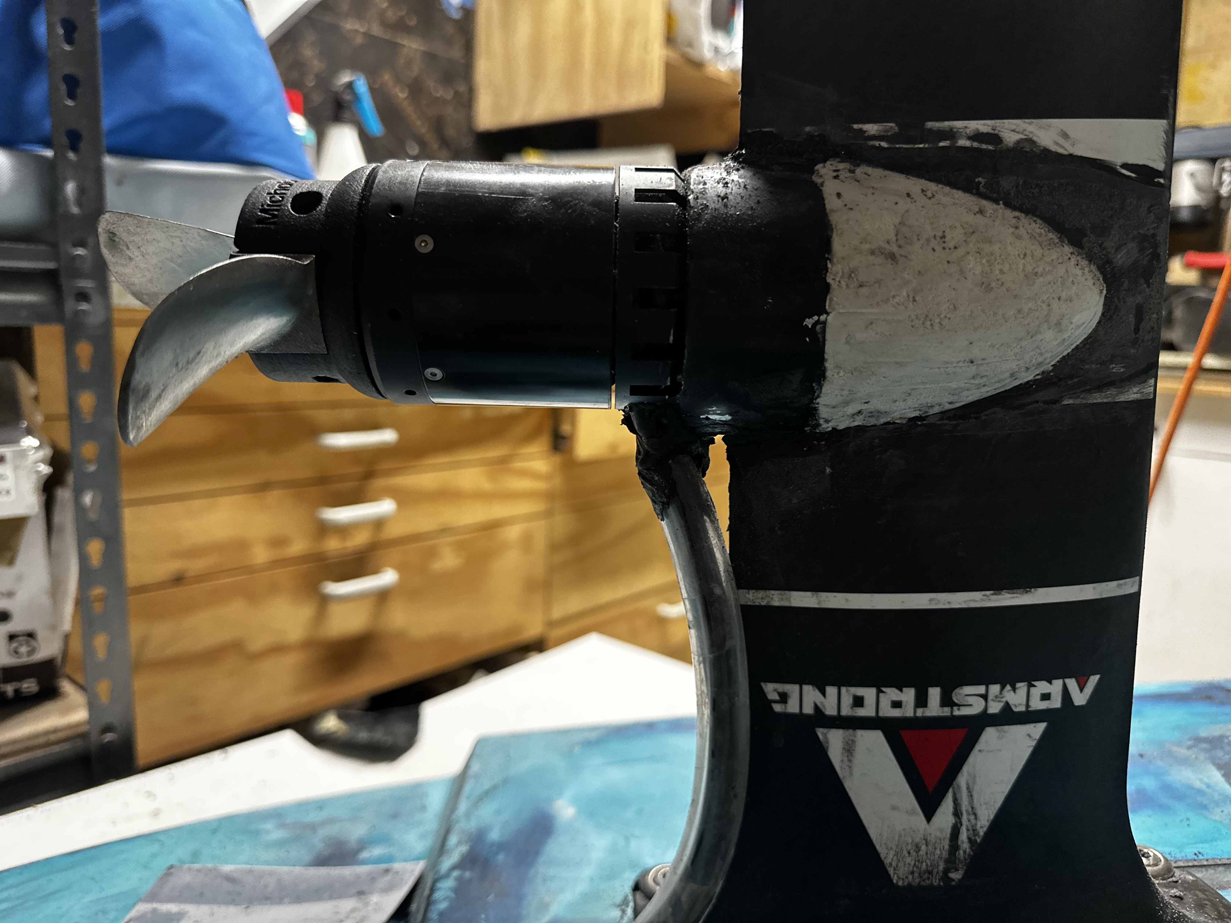

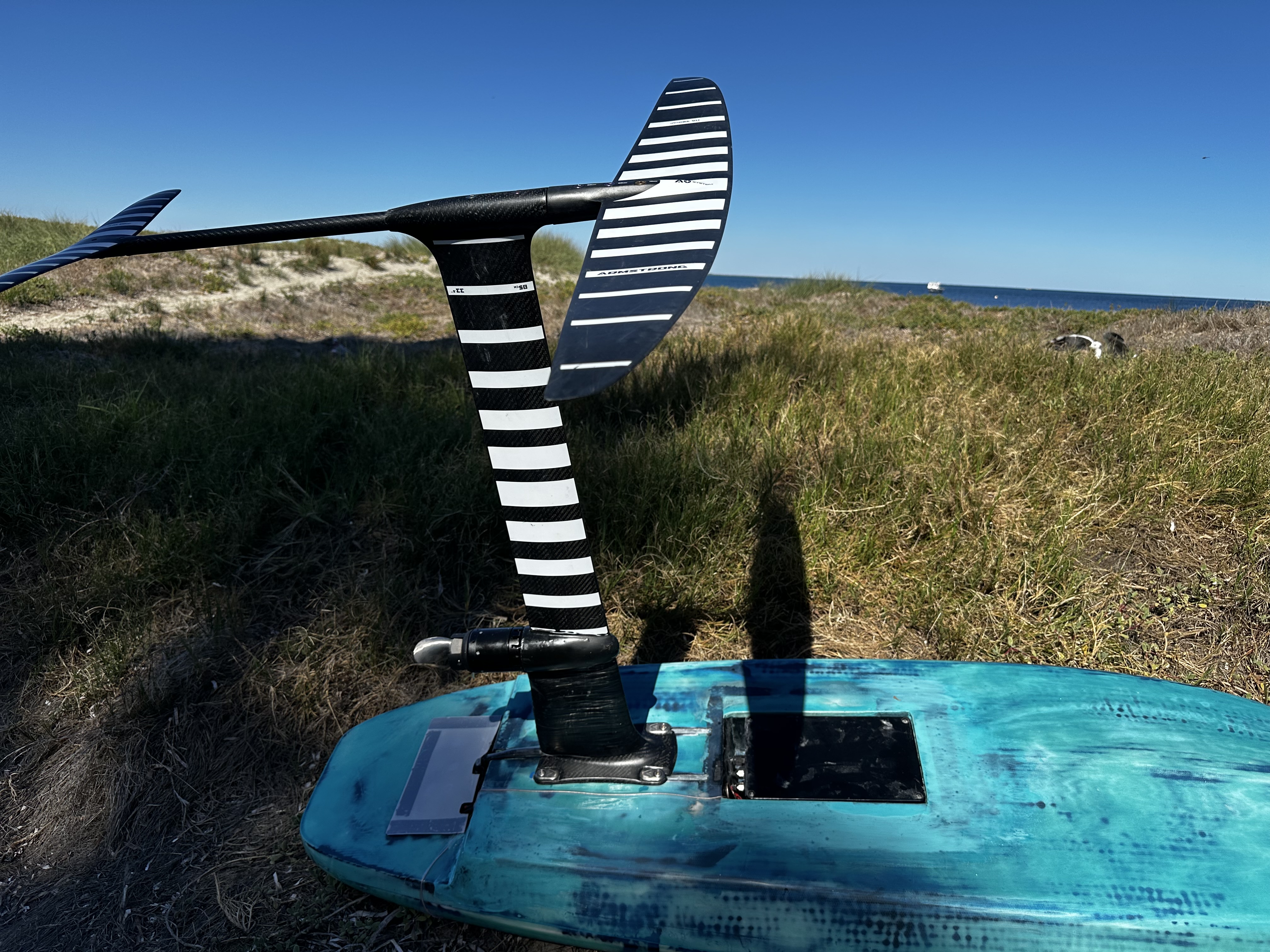

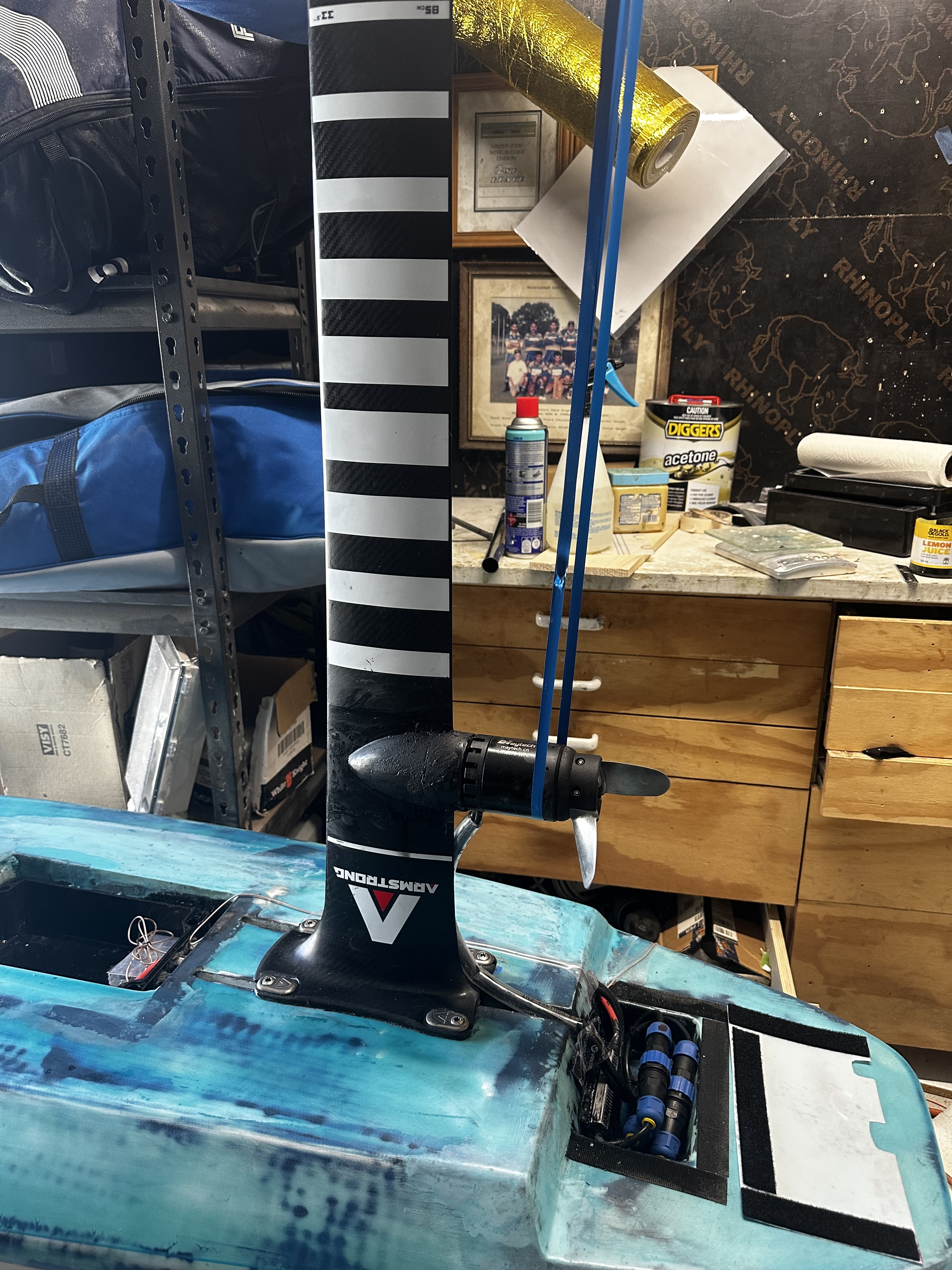

I’ve built my assist with this setup and it’s great. Mine is built into my own designed board with a solid IP68 rated box esc is out back everything is accessible from under board. Only two test runs yet needed extended antenna outside on front of board and now I’ve also changed pitch angle of motor so it drives board forward and maybe down
to see if I can get my feet to stand back further where I usually stand when winging

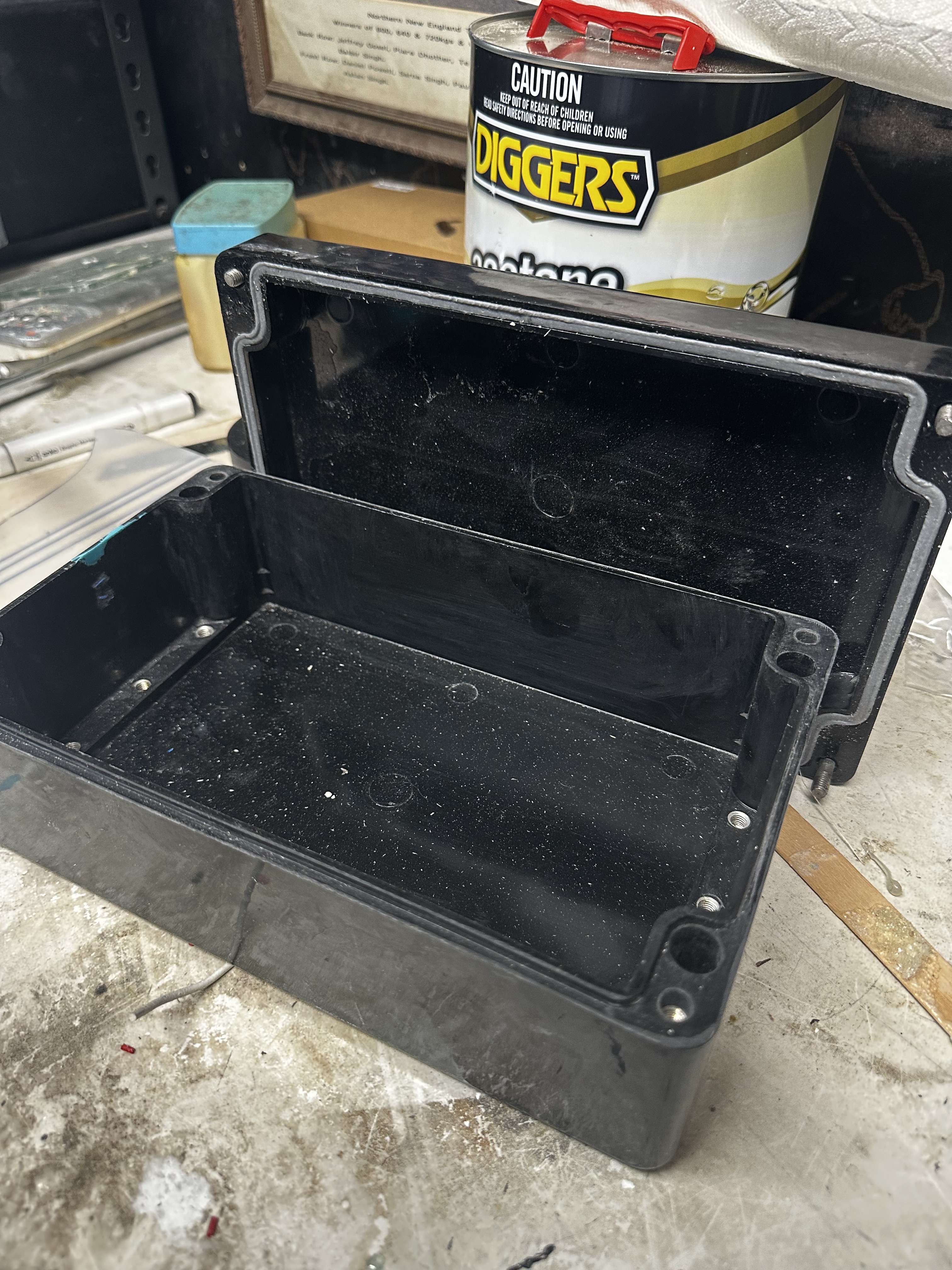

IM finally getting around to this again and I’m stuck. The plan is the encapsulate the battery inside the board (foam). Will I be dealing with battery overheating issues if simply used for foil assist? The BMS should manage temperature for safety correct and cooling will take a long time due to no ventilation I imagine?
Anybody out there done this before that can report how troublesome this build is or by a stretch ppl having no issues with this?

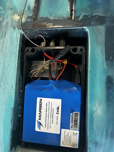

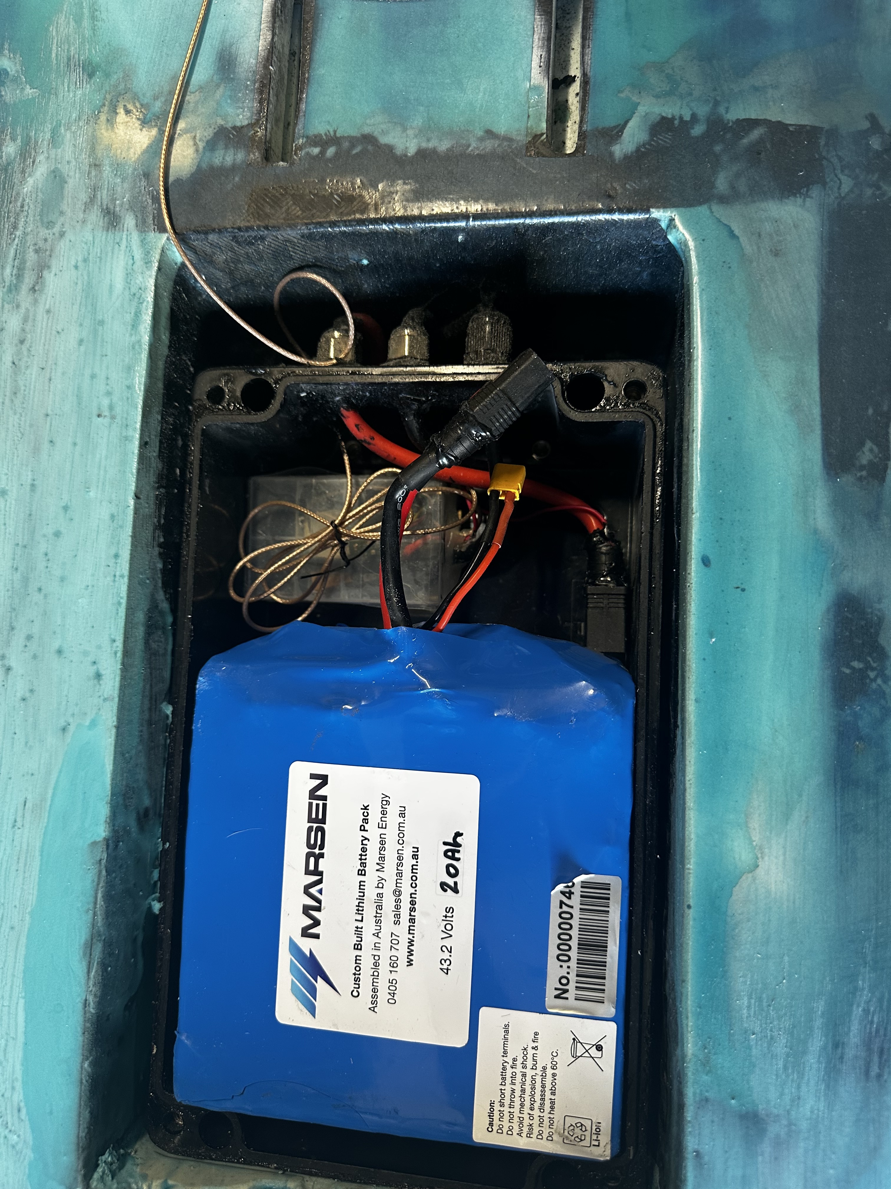

I have 10guage wires from motor to esc and 8 gauge from esc to battery. Battery is in this box totally sealed and nothing gets hot battery is bairly warm after full efoil run.
I have the same 10awg to esc and 8awg to battery. I’m worried in a box it atleast gets fresh air and water splashed on it. sealed in foam the heat will have no escape. its just so easy to just put it in the foam so really trying to get away with that unless anybody confirms its a bad idea. :).
What size battery and how long run time you thinking?
I’m running a 12s3pack 50p 21700 molicel 20ah I’m getting 20 to 30 full efoil. Even in foam I can’t see them getting too hot. But your right my box is thick but does get wet being fully submerged when board in water so yes it will stay cooler.
