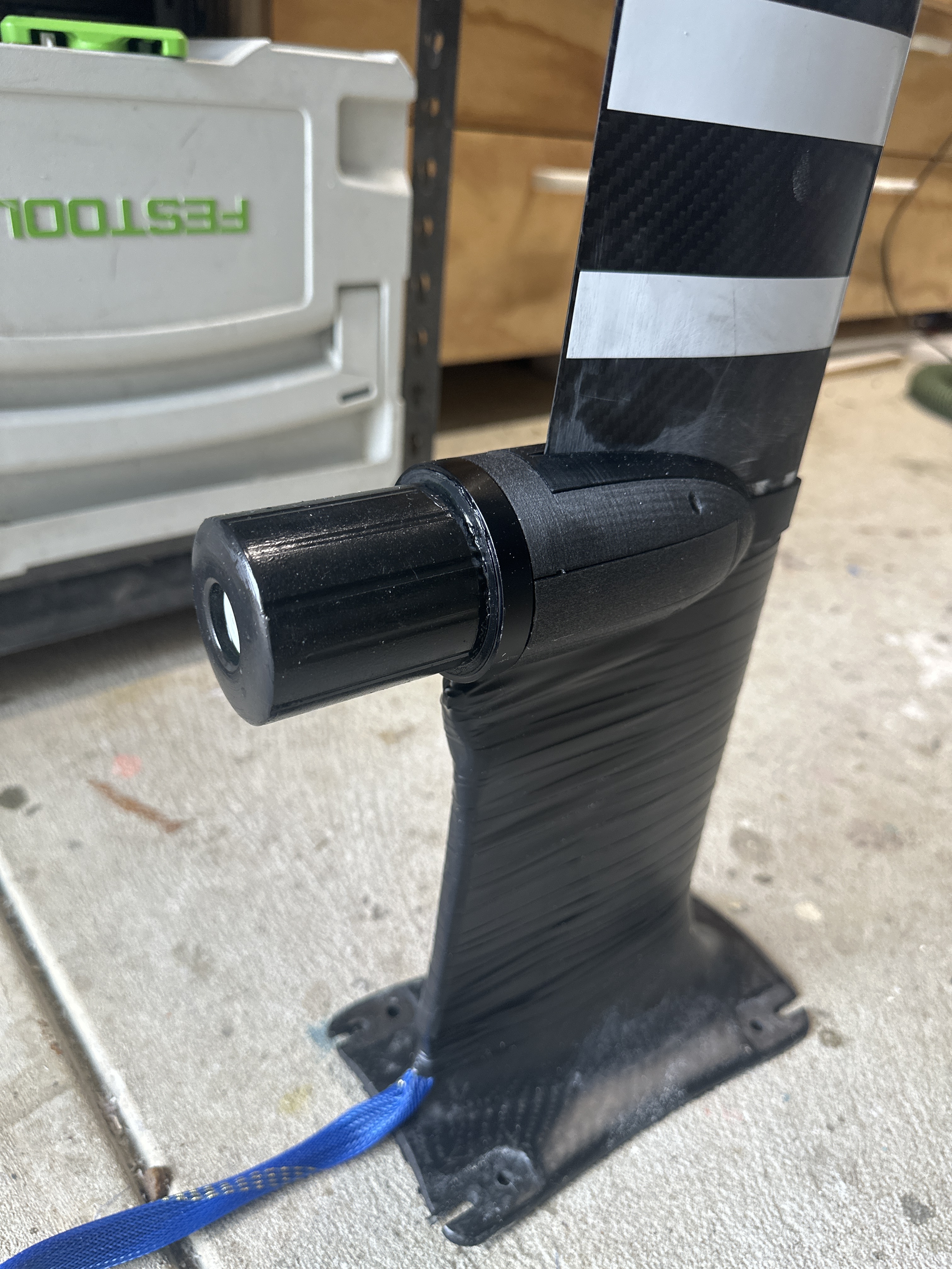

Airtimeasto, correction i bought all this a while ago. Take a look at the link i sent you. Its for the propellers that he adjusted screw inserts for the maytech motor. For the pod you will find he has a spacer that does the hole adjustment for the pod. He made this spacer after I had already ordered but it looks really good. I just drilled out new holes in the regular pod to fit the 6579.

since Im only really using my set up for full efoil, I’ve just drilled a hole in the mast to run wires through for a more efficient low motor position.

Ive just commited to drilling a hole in my cheap F-one aluminium mast for efoil low position with less drag. For an aluminium mast, f-one are quite light. 2.07kg inc foot for 85cm (only 200g heavier than sabfoil 82cm carbon mast & 500g more than Fone and 750g heavier than No limitz)
15mm thk is decent for speed and can feed 5.5mm bullet connectors through. Hopefully not too much more flex.
I can have high position integrated mast also by removing just 1 bolt and feeding wires through.

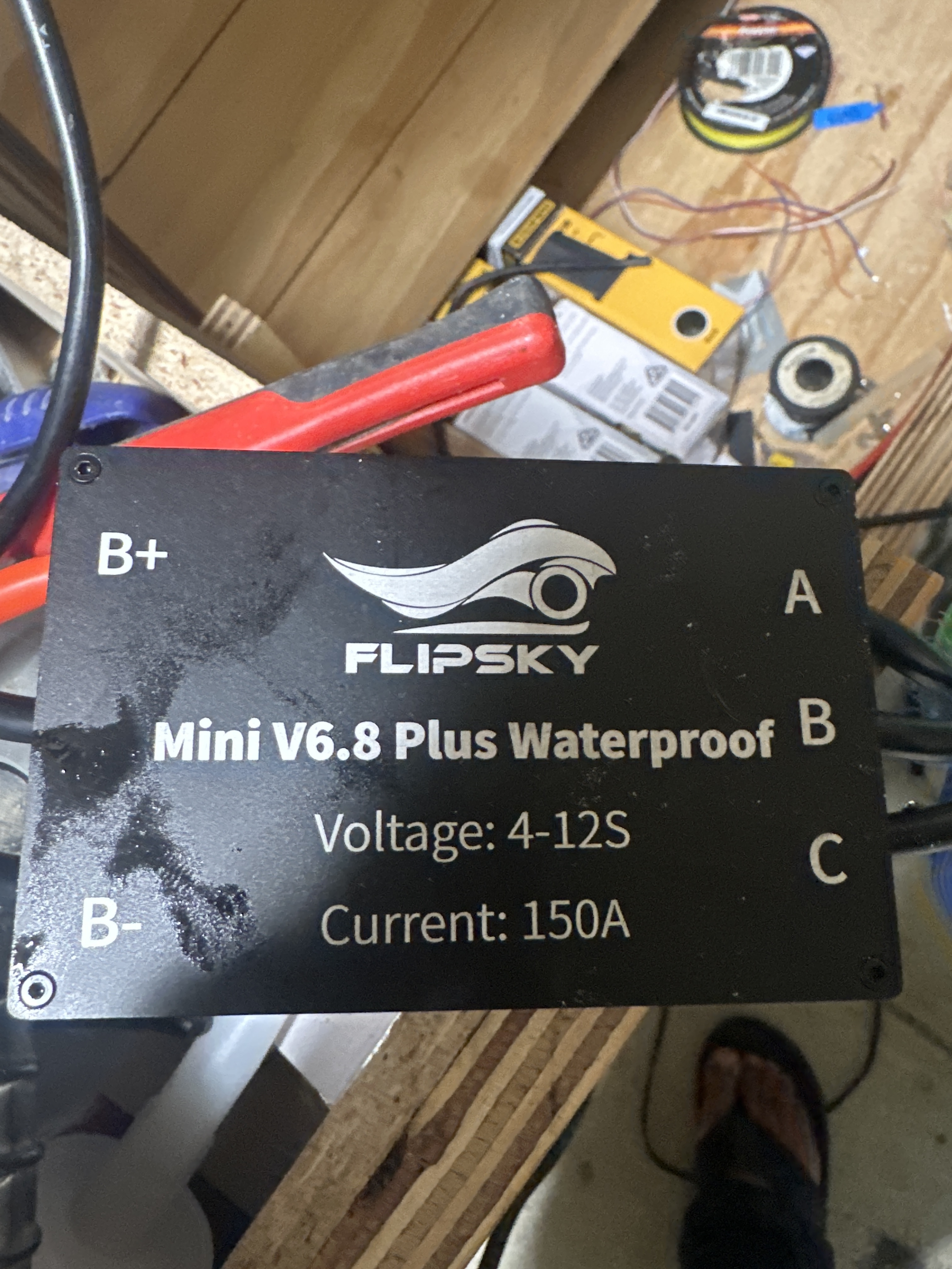

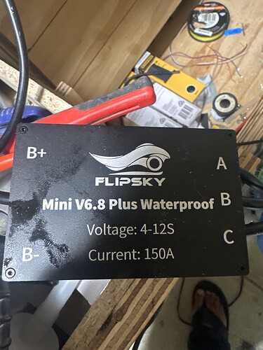

Well my backpack setup was finished and programmed vesc and motor everything was working fine when I left home as soon as I powered up in water it stopped and I can’t seem to get it running again I think it’s vesc I bought from flipsky something somewhere has failed

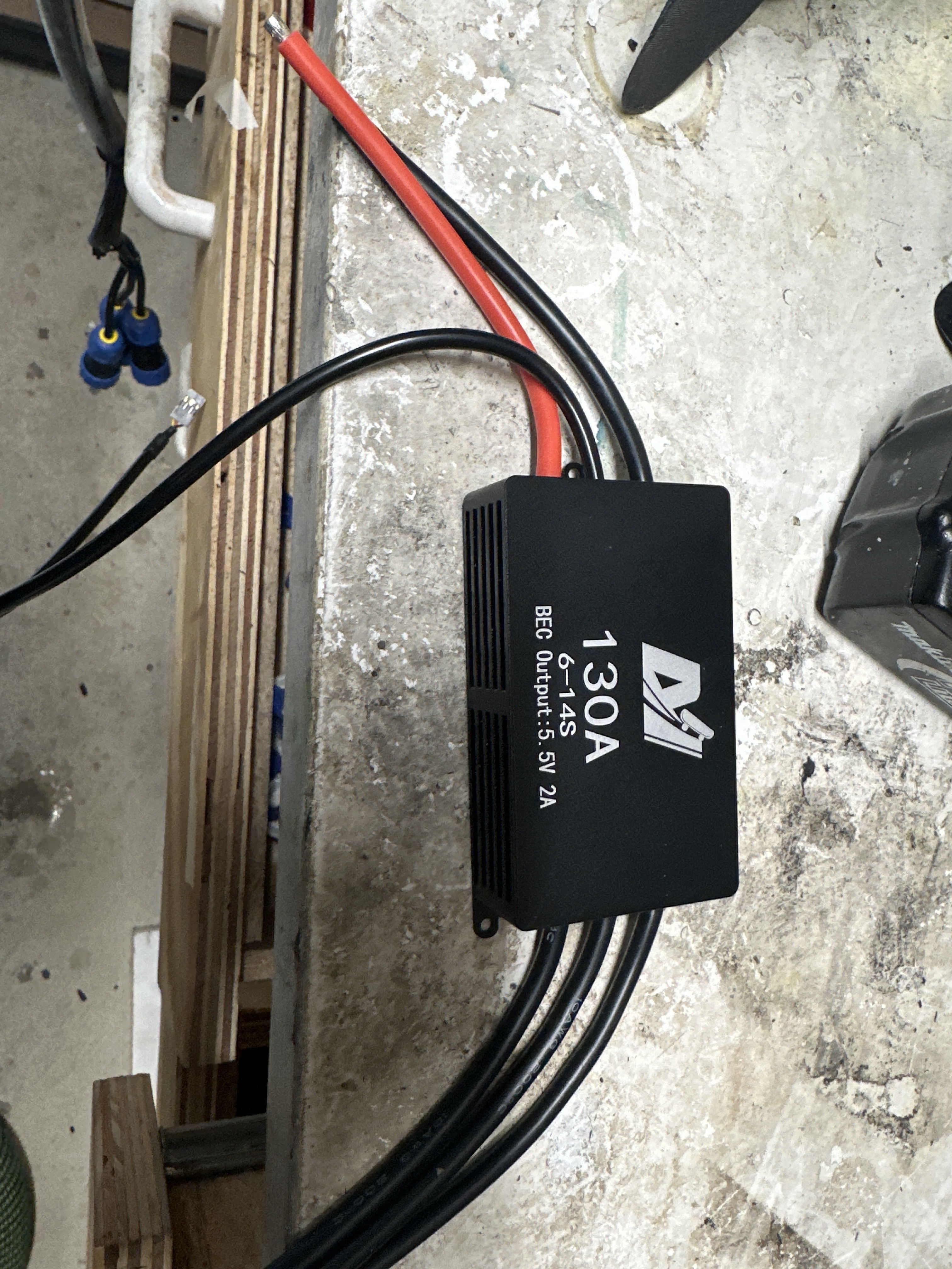

I think I’ll go back to esc they are much simpler. Has anyone ran a 160amp esc on a 6384 motor before or should I get a 120amp esc?
So does it not even spin on land anymore?
Can you still connect to the VESC?
If the ESC got water inside, then Flipsky should replace it as its rated ip68
it wouldnt even work on land at all i thought it was a signal issue but no.

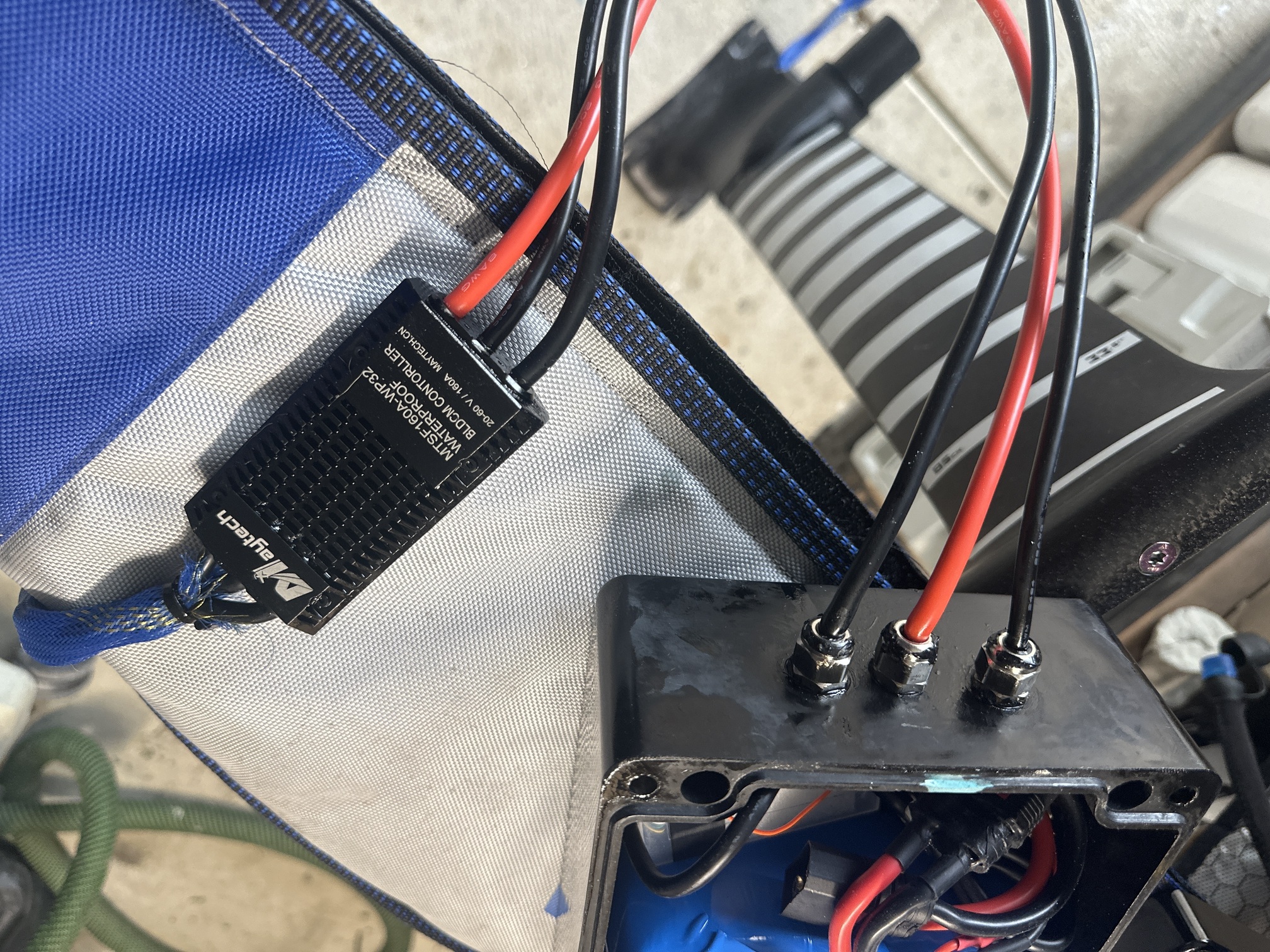

I got rid of it and replaced it with the Maytech 160 amp waterproof esc and it works fine. Still need to test it under load in water but seems to be working again now im looking forward to testing it maybe Sunday
oh also it cant get water inside the box is fully potted with epoxy.
motor is potted same as foil drive as well
I assume other than the FETs touching aluminium so that they have some cooling…
The only way it’s getting cooling is that whole esc in in back pack getting dunked in water

6384 MOTOR, 160amp esc all in camel pack
Looks great! I’ve got a similar setup — do you happen to have pics of the drilled holes?
This is my complete setup the box is ip68 rated which is heavy at 2kg without battery but it does not get a spec of moisture in it and it’s strong. Fits in camel pack easy and is really comfortable don’t really notice it. One con is cable can be annoying but the lightweight board riding feeling out weighs the cable issue. I thinking of designing a vest or belt for battery next. Flexible battery watertight.
Oh I want to try this esc to see if can still get up going.? Might get more run time with less current draw.
Also not having any problems with cooling yet
