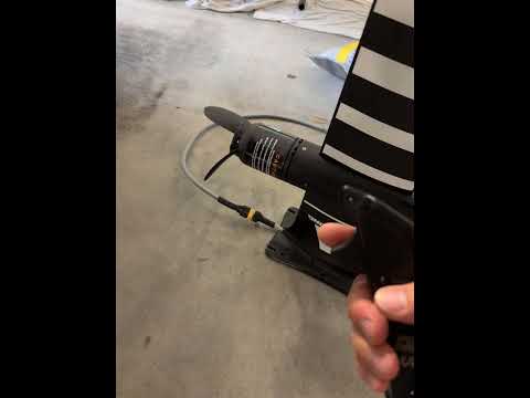

I have a FSeESC 6.7 Pro with 12s3p batteries and FD motor. Occasionally, I am getting a stuttering motor when slowly initiating throttle…but sometimes also when I go 0-100% throttle.
Please see the link below.
I did everything what is shown in the video below. But on the handy app, which seems a bit limited…or I am looking at the wrong place.
Any ideas/explanation what the reason for this could be?

Lower inductance value in the motor config by 50% and try again, alternatively post the motor values tab here to have a closer look
With the newest VESC firmware I find the automatically measured values to all be too high by 30-50% for the motor to run nicely
Seems a lot better without load now. Will check shortly. Thanks heaps!
