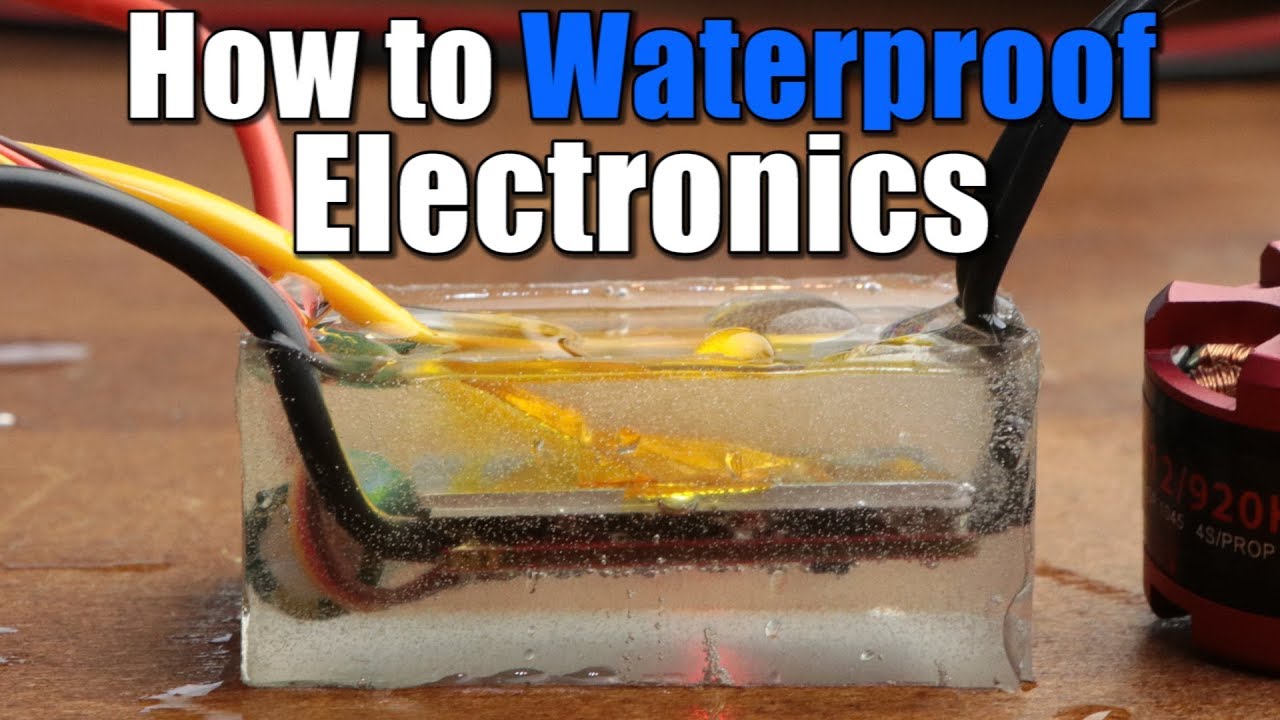

For the pack waterproof ability, I plan to create a jig box around and pour silicone around it. The pack will be drown in silicon. So basically a 3D printed custom enclosure filled in with silicon.
