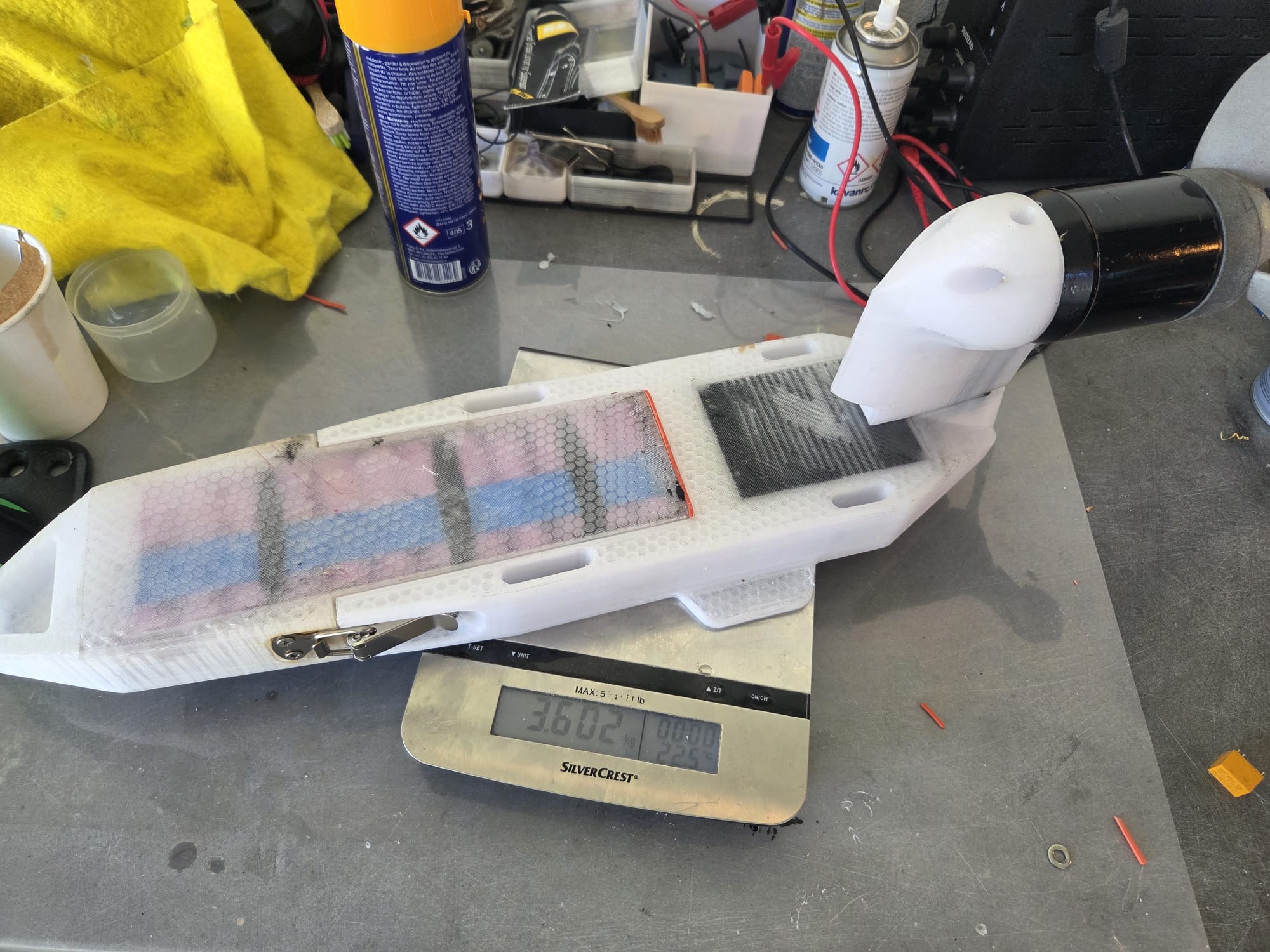

Do you have photos and weight of your board?
Full foil weight is also interesting to compare… big difference between brands.
I do not really know, it is integrated in the board.
40l board is about 3,8kg including ESC, RX, hatch and cable to the bottom of the board. Beyond the ESC housing, there is not much to easily change there.
I probably should get rid of the complete housing.
Its sitting in a more or less watertight box with alu base.
