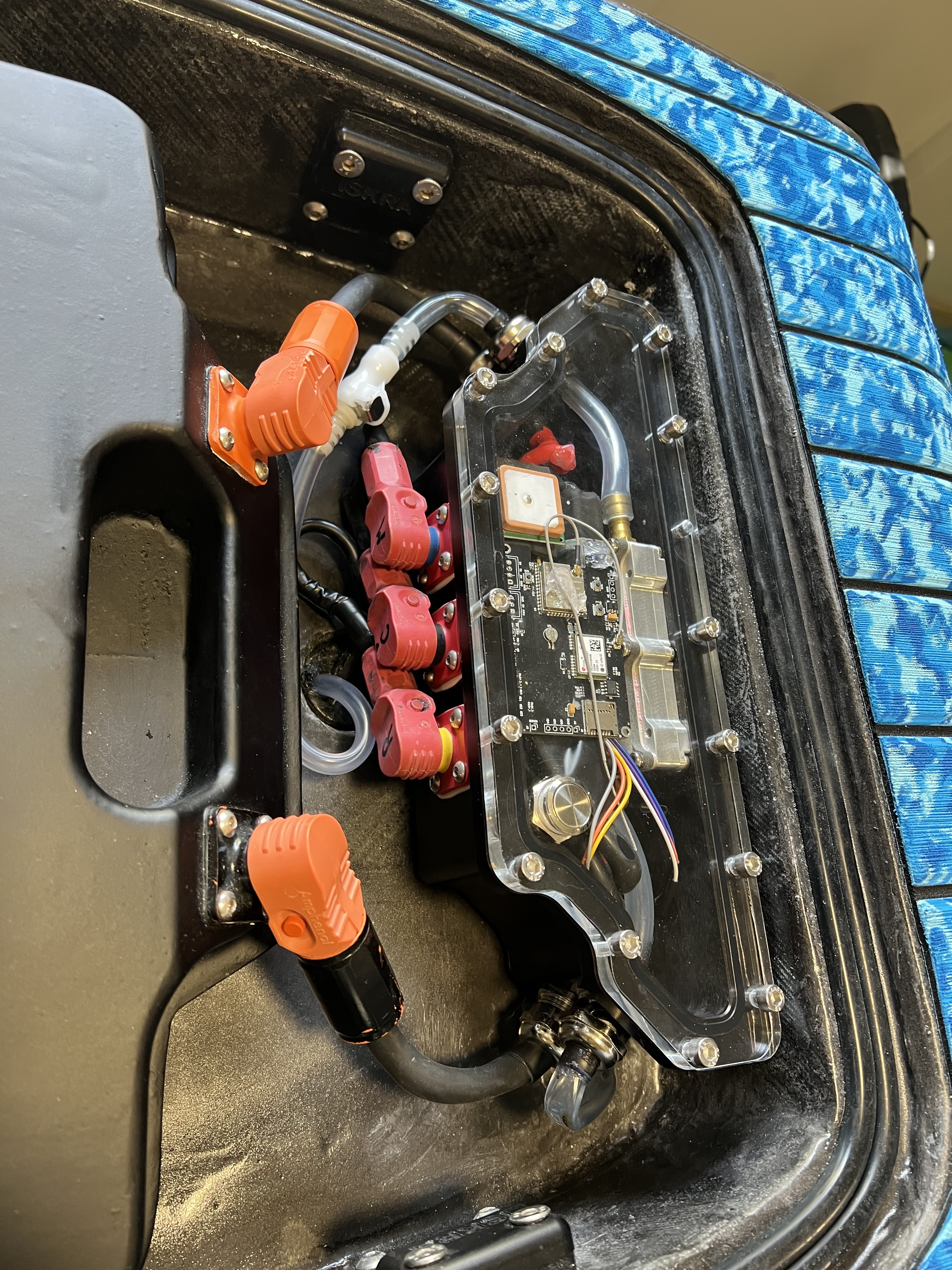

I start building my first foil assist, and I ask myself, how do you fix every component in the box ?
Do you glue it ? To prevent the material from moving or shocking in the box or cable to disconnect, is it possible to use foam ?
What is your technique ?

Hi! I‘m not an expert compared to the pros here.
For the esc to the heat sink, I used double sided heat transferring tape.
My bec is one that is already inside a potted box. I used heat shrink on almost all open connections to minimise contact points.
I have so little space in may box that the rest just sits there and can’t move.
If I had more space, I I would print myself some strap holders and put them in the box with double sided tape(the good and strong one) and secure the batterie’s with Velcro straps
In my new box, all the components are so packed up inside, that they can’t move. You could design box with components in mind and make sure that when inside they hold on
