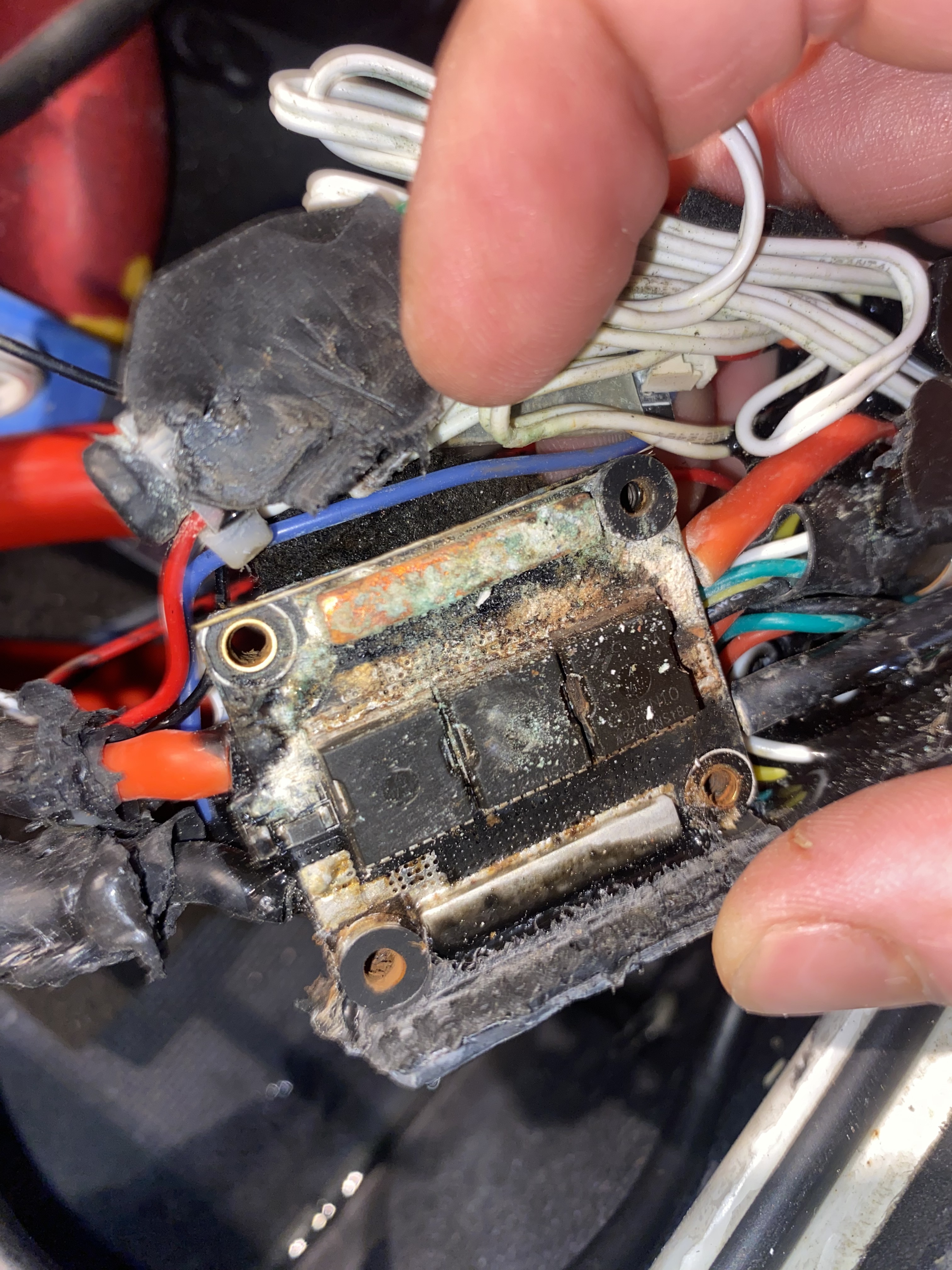

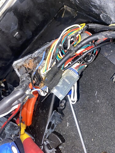

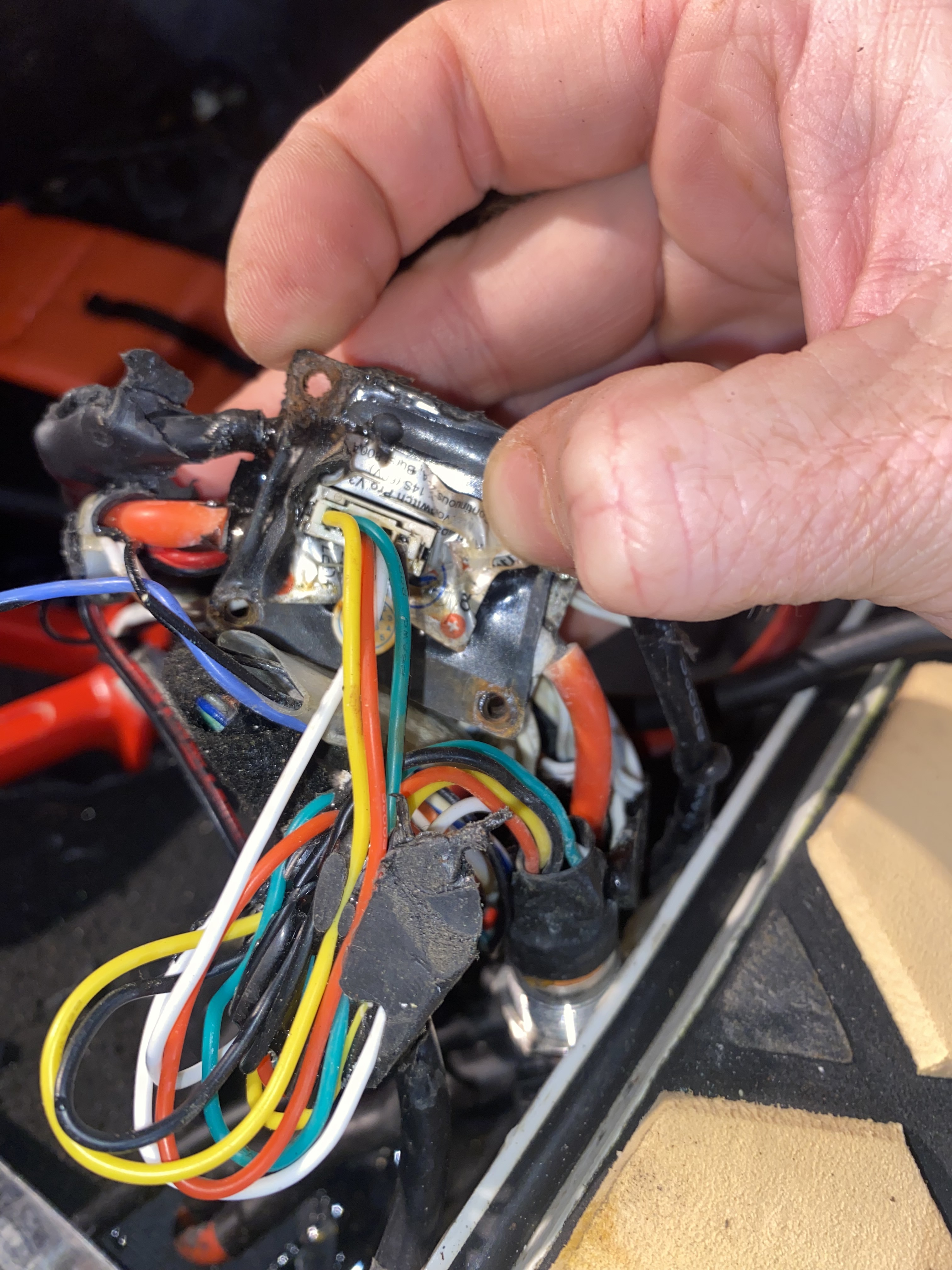

I bought a 2nd hand efoil and am in the process of repairing it to use - I’m Berlin based, and discovered that my foil definitely had some salt water in it at some stage
Today it smelled like burnt wires
Does anyone know of a place in DE I could buy direct from or is it only available directly from flipsky?
Flipsky can be bought off Aliexpress or from Flipsky directly in Germany.
If the broken part is only the Antispark, you can just get rid of it for now and manually hold a resisor in line with the battery + before you plug the connector. I do that all the time ![]()
            For an ESC, I would say Amazon, which normally carries some Flipsky parts, but it appears that they do not carry the antispark switch in Germany.
