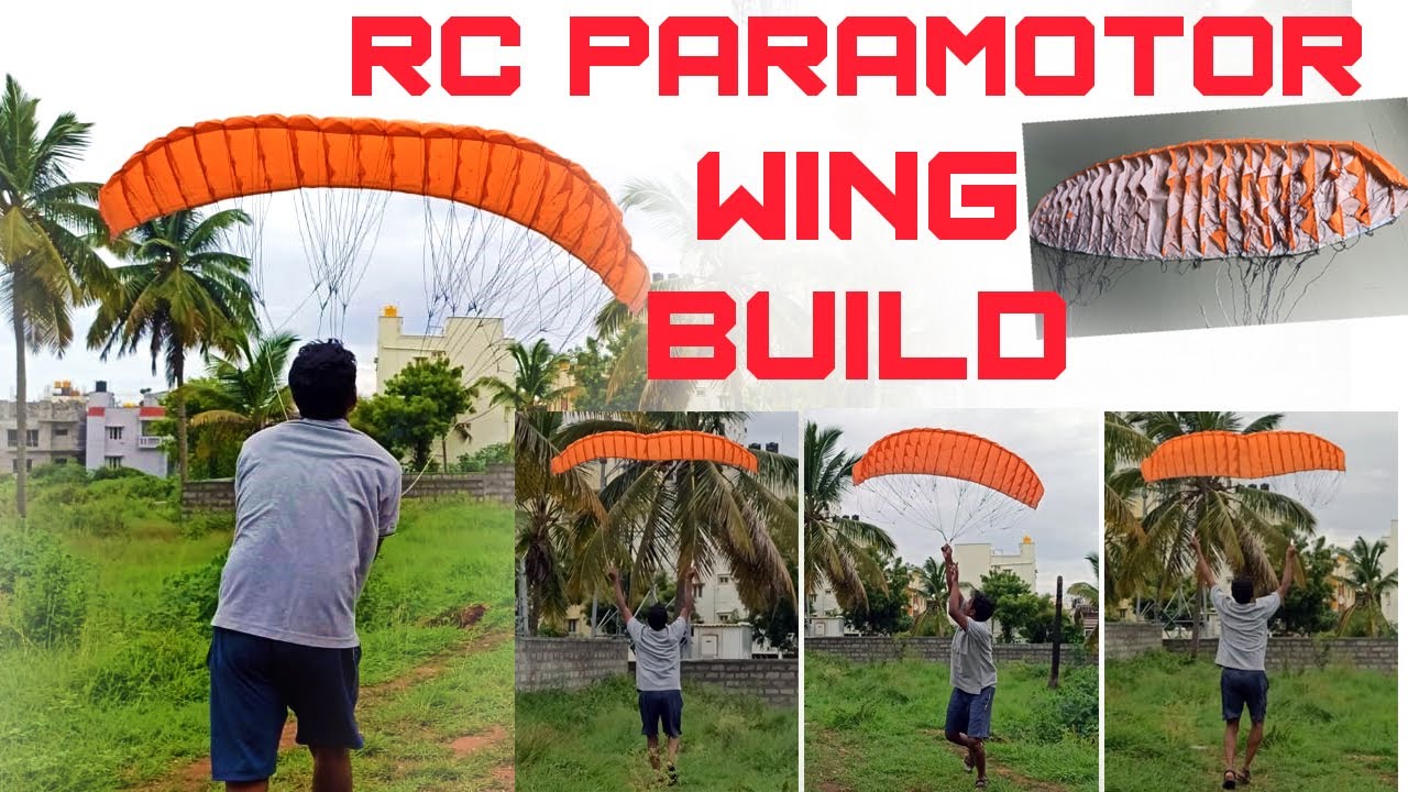

How to get plans and sewing practice ? Single skin paragliders plans measure between 15 and 25m2.
They could be reduced and their bridle tuned to the paraskiflex parawing type bar.
Then there is also RC paramotors wing plans available which are closer to the 3-6m2 surfaces we’re after.
Example:
Plans, credit to RC adventures: https://www.mediafire.com/file/bwy38dacszt4nqx/LuteFisk_Build_Package.zip/file (really impressive, modifications are possible using above open source SingleSkin SW)
Sewing advice: tbc
