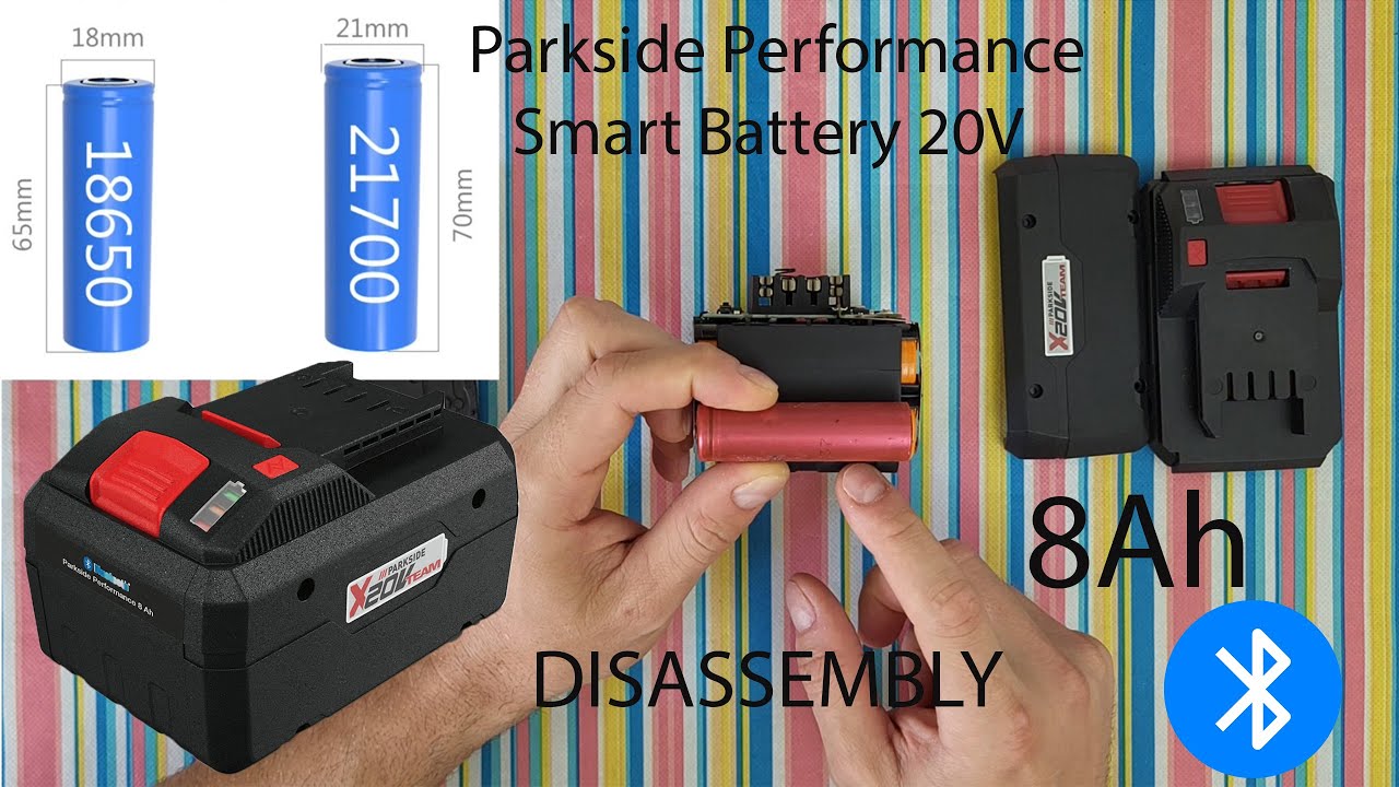

Perfect low cost lithium ion commercial battery for efoil or foil drive assist : LIDL Parkside X20V 8AH
in absolute terms, you’re right, but for those who want to make their own kit quickly without investing in a spot welder and all that’s needed to make a lithium ion battery (with the risks that this represents), + buying and plugging in a BMS, it’s still not so bad.
In terms of quality, there are not so cheap and support easily 60A battery current, 4200mah capacity per cell doesn’t seem overrated (manage to efoil 15-20 minutes) really enough for a faux drive assist.
@nicolasLGM, would you open one of these 8Ah batteries and tell us which 21700 cell reference you find inside and confirm the Serial / Parallel structure as well ?

So we have a genuine 5S2P setup confirmed by
You have to find a cell with identical or higher Max. Continuous Discharge Current.
The Molicel P42A 4000mA with 45A MCDC might be too good for the job :wink:
Not sure what happens if their power discharge capacity doesn’t match that of the group cells they are inserted in.
