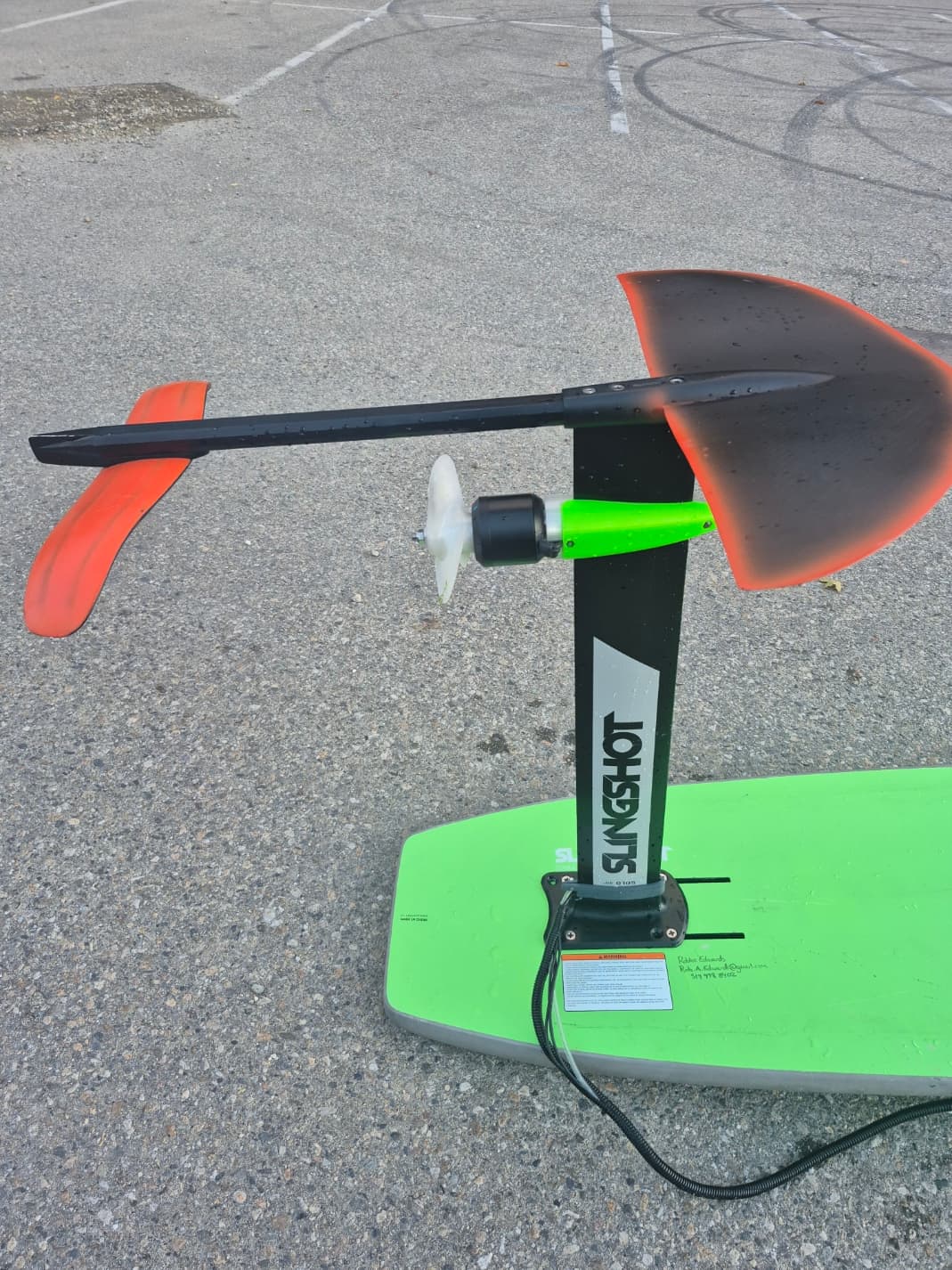

I’m using a 7070 with a lower volume Slingshot kitesurf board. I have to get the board on plane before I can stand up on it and begin foiling. I can’t quite get it on plane with my current setup. I would love more info on the builds that are successful with this motor or any advice!
Motor: FlipSky 7070 110kV
ESC: Hobbywing Seaking 130A HV V3, water cooled
Battery: 12S 16Ah LiPo 15C
Propeller: Custom 3D printed, 3 blade, 160mm diameter, pitched for ~25km/hr
Diagnostics: None.
Foil: Slingshot Apollo 60cm.
This setup worked beautifully with my previous geared motor system.
Next steps: I’m going to try a new prop with a lower pitch and 2 blades. After that, I’m going to look into measuring motor current, battery voltage to see if I’m current limited by the ESC or torque limited by the motor.
