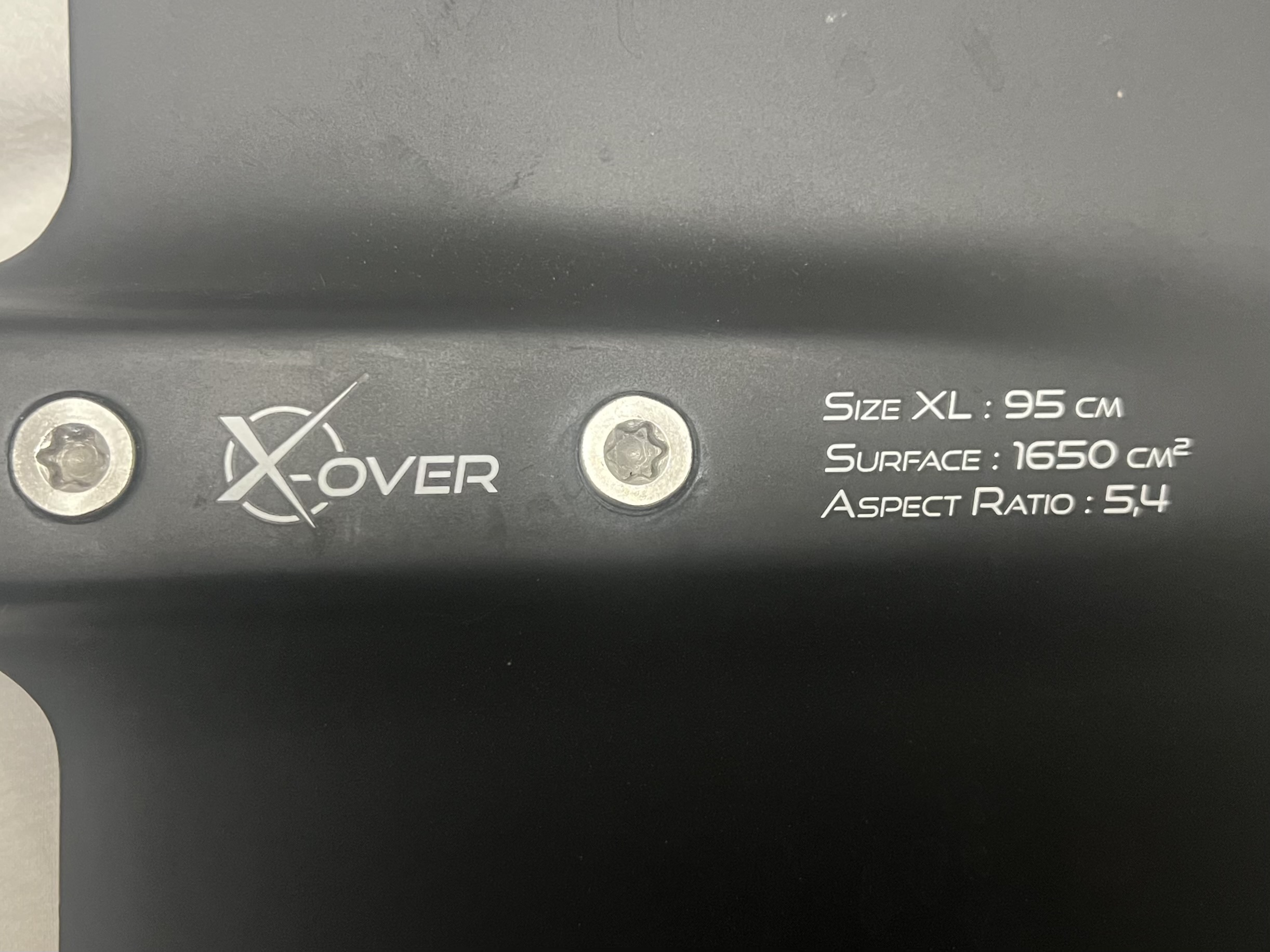

I mostly use my L size X-Over on the V2 aluminum mast and fuse. The area on my L is 1300 - my XL size X-Over is 1650 so not sure what ver of X-Over you are using when you state L and 1600??
I know that Gong has a complex product offering that isn’t easy to understand so maybe a good  idea to post a photo of your setup so the feedback you get is accurate.
I can’t offer an informed opinion on other Gong foil shapes but I do know that riding my XL 1650 size at 40kmh wouldn’t work well as that surface area has a LOT of lift and any small body movement would make it extremely challenging to fly.

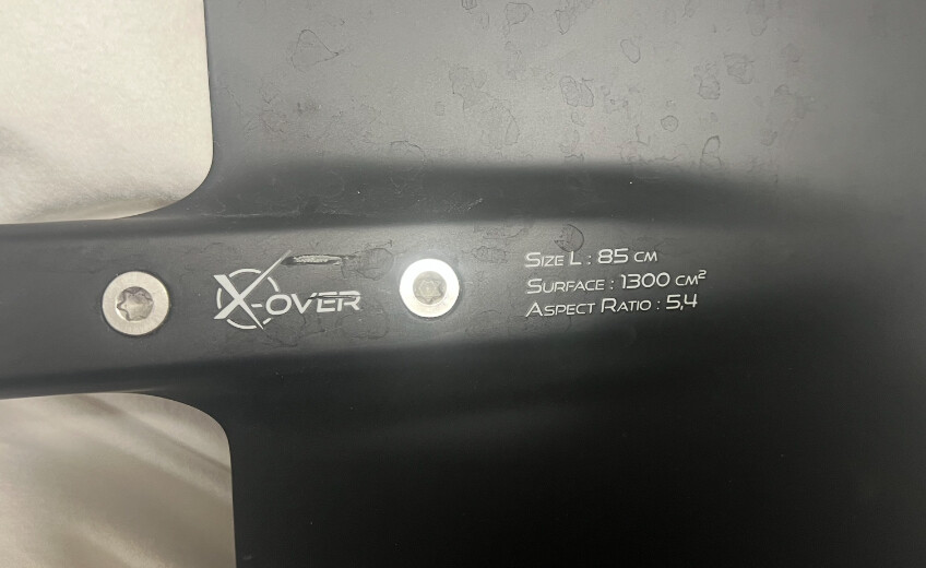

And yes—my mistake, the foil is 1300 cm², not what I said earlier. Sorry!

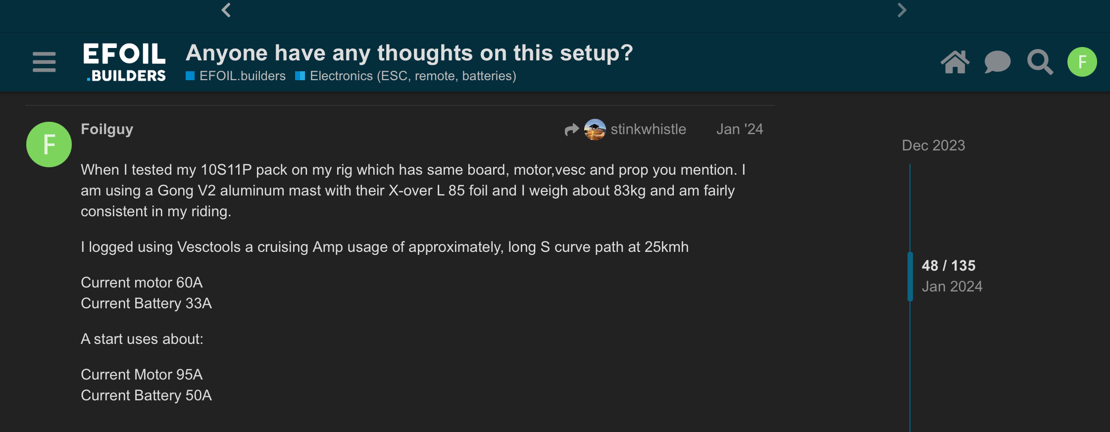

              This is what I get using same foil.
