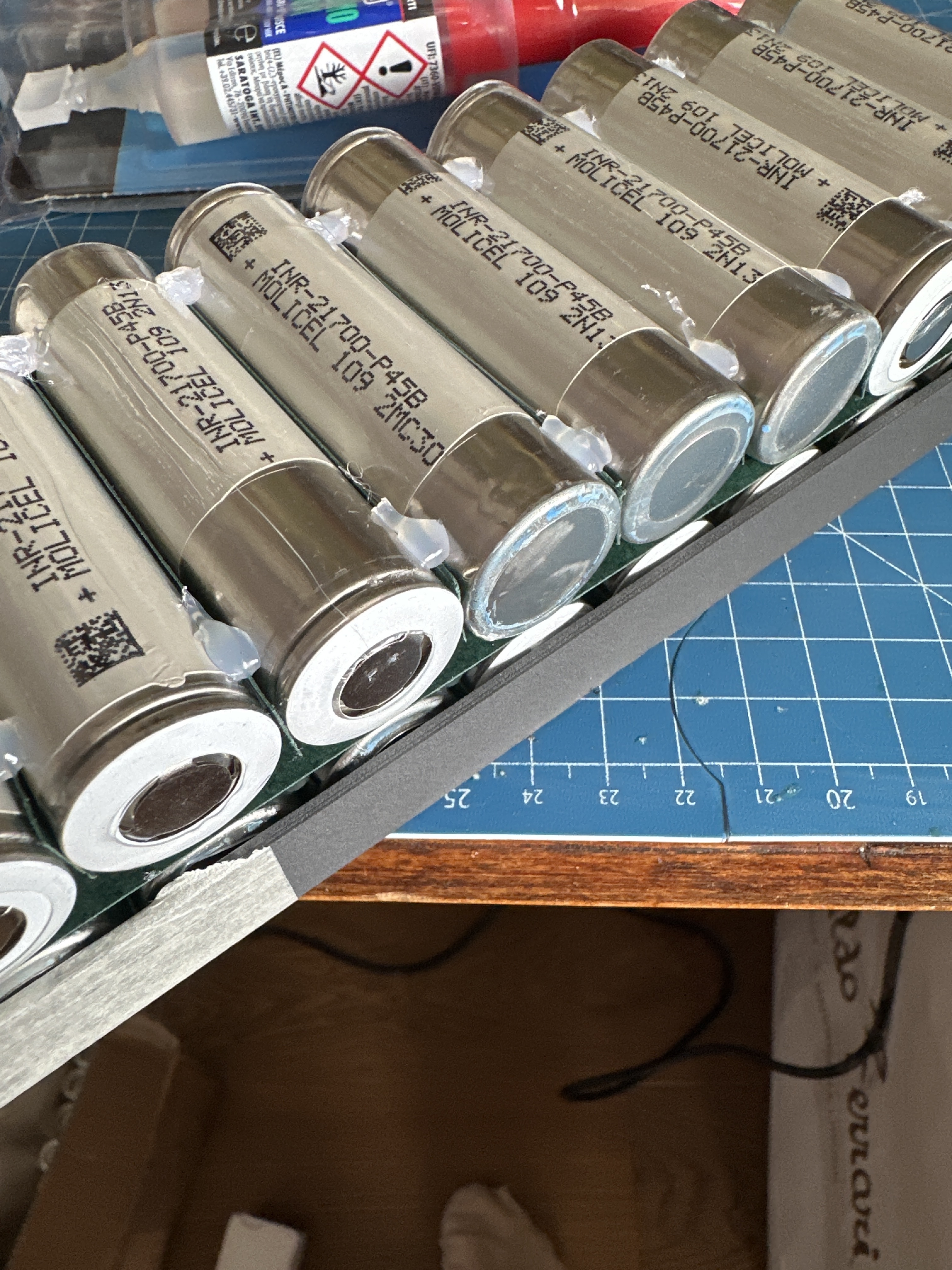

Has anyone else encapsulated batteries with resin? Do you think it’s okay to leave a bit of hot glue holding the batteries together under the resin and the green tape that would be included in the resin casting?
Oooooo that looks like it will cook some food well when it fires up. You need to rewrap those sells properly!
Look well mate :stuck_out_tongue_winking_eye:
Already rewrap (clear) left only one piece of old wrapping under new clear one for model reference :rofl:
