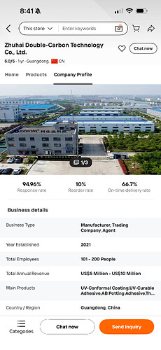

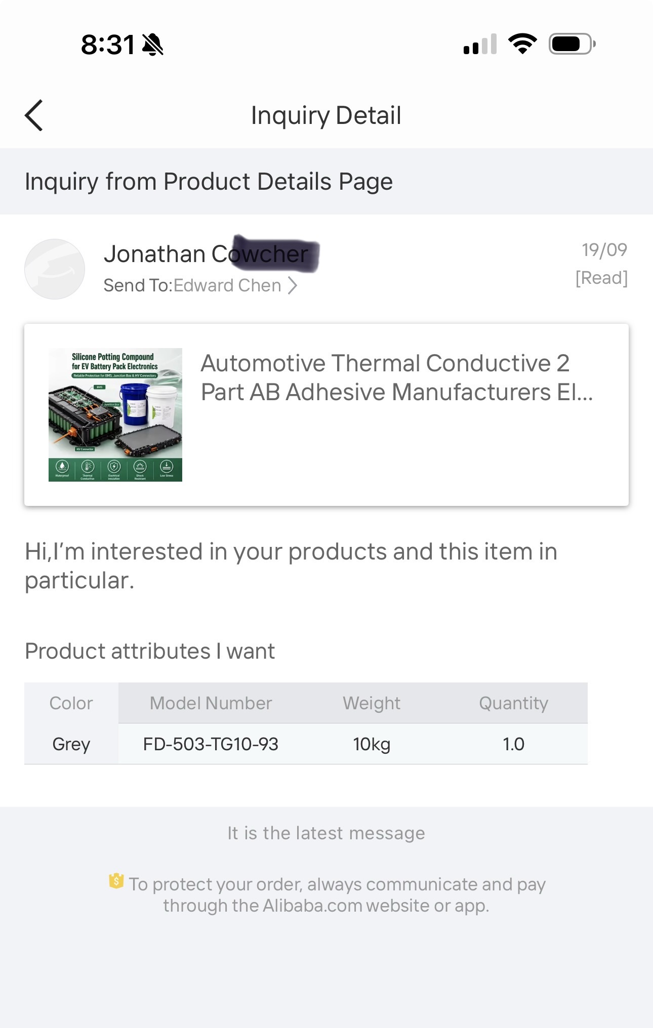

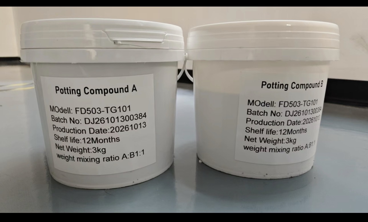

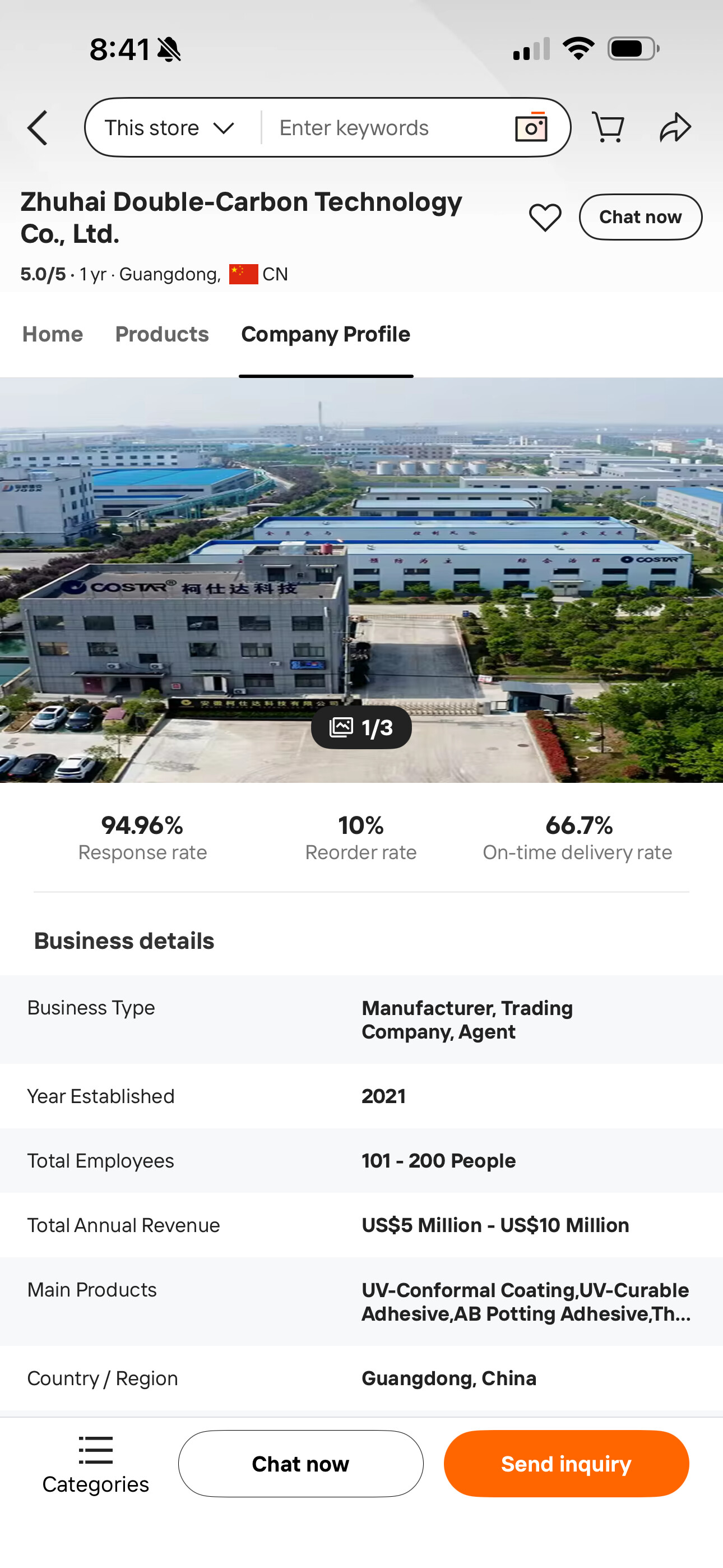

I had much the same ‘paralysis by analysis’ going on for potting battery packs. Locally available options in Australia were incredibly expensive. Finally took a gamble on these guys on Alibaba. Haven’t received the product but they have been super responsive and excellent to deal with.

Total cost was around $200 aud including PayPal currency fees, freight (most of the cost) and import costs. I’ll report back when I receive and use but hopefully it does a good job!
