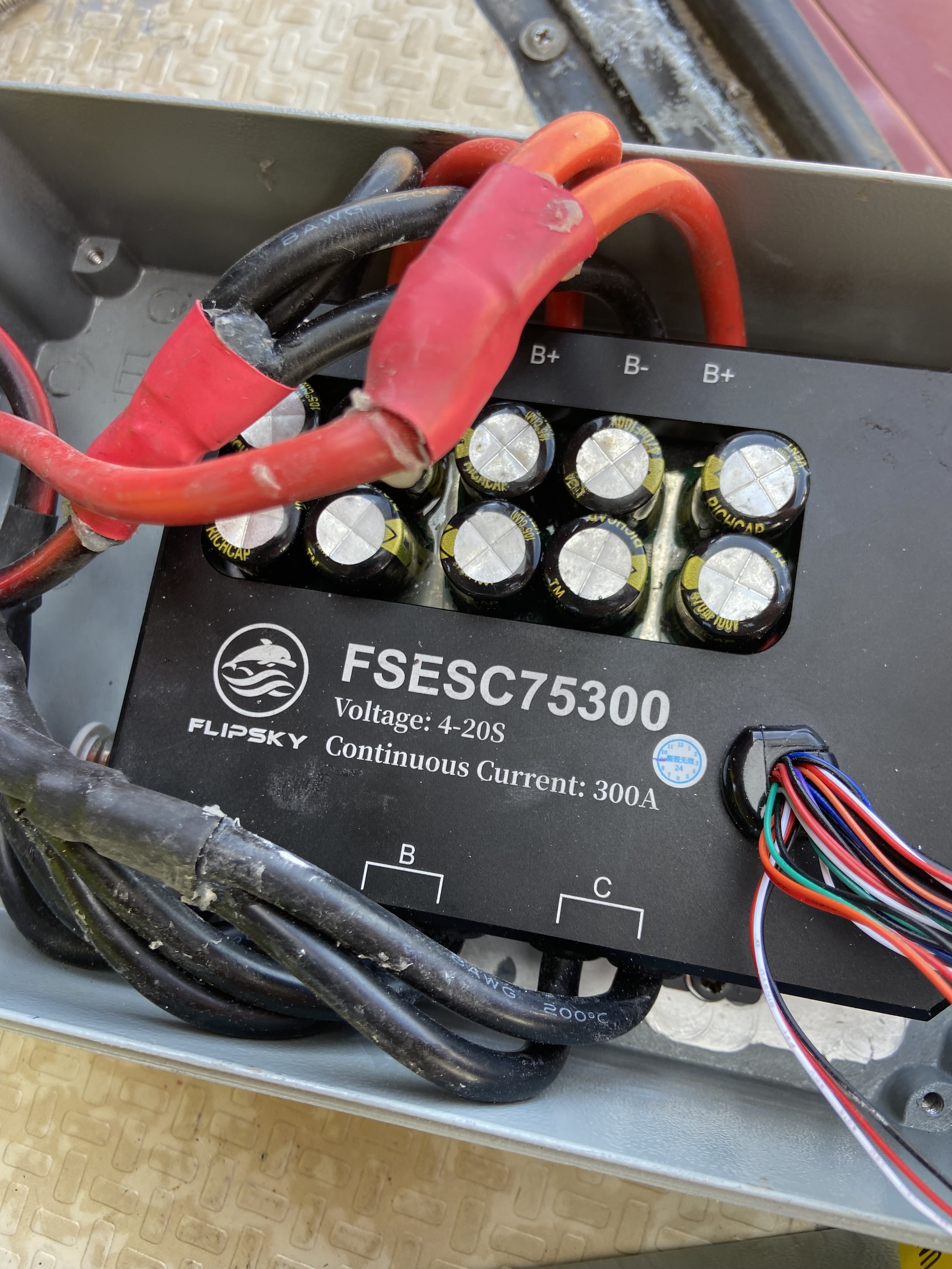

Hello everyone, after more than 6 month of researching and building, today was supposed to be the day of finally go to the water!

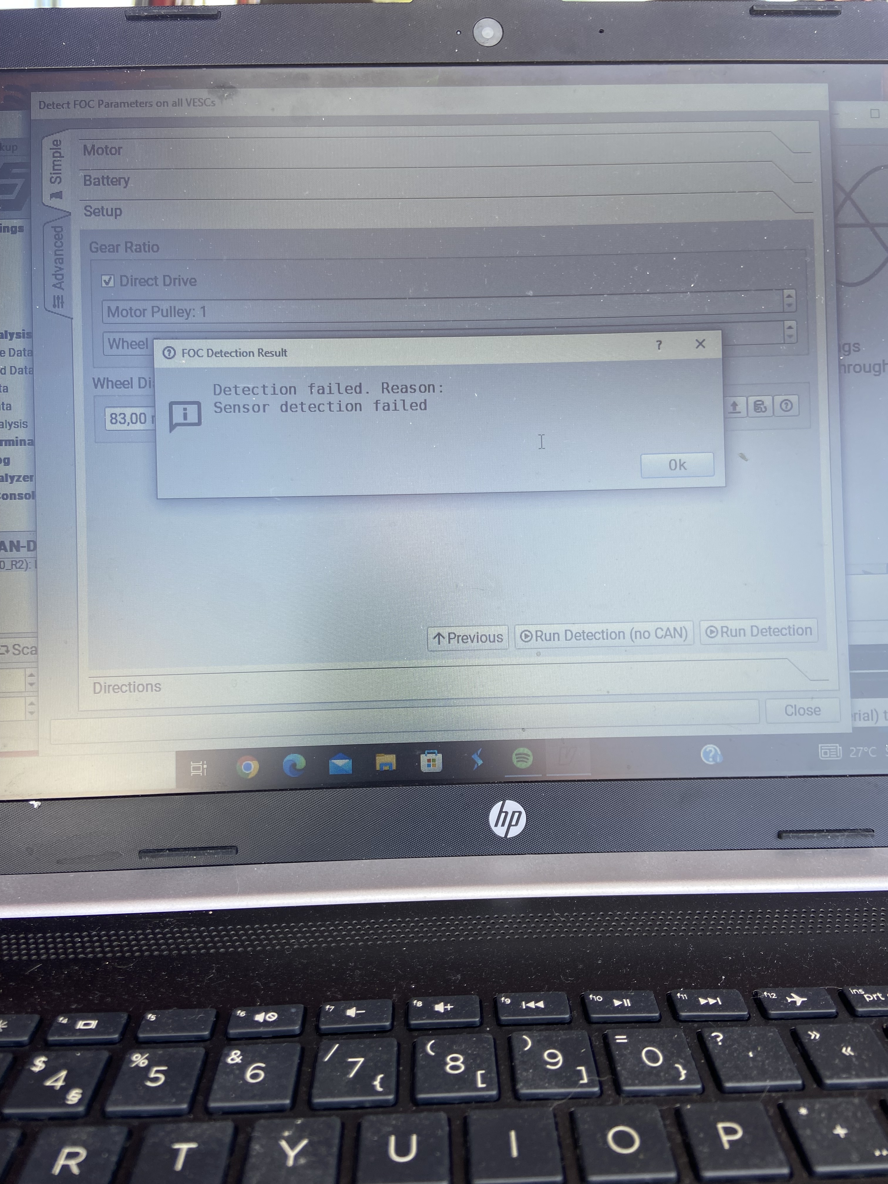

Unfortunately wend I was make the last test with the battery almost full 90% (molicel P42 14S8P) I couldn’t start the engine, connected the esc to PC and receive this message “ Detection failed. Reason: Sensor detection failed“
Any ideia what could be the problem? Esc ? Motor?

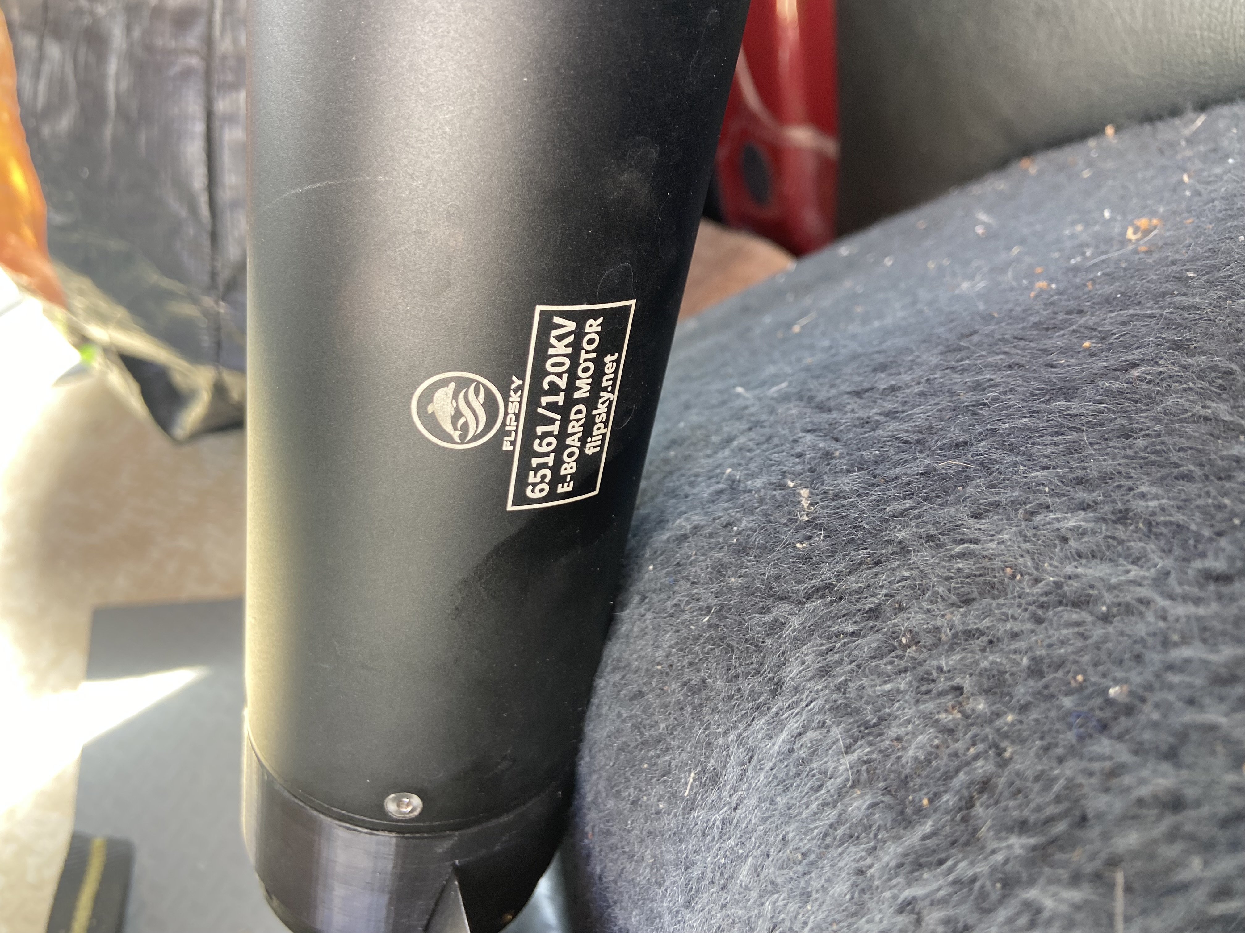

The 65161 is sensorless. In vesctool check what you have setup for sensored or sensorless.
I would try to use a newer vesc tool version, and run the motor wizard. Follow this guide:
Thanks for yours replies, after trying many times it started to work, and the first goal of this hobby was achieved!!!
