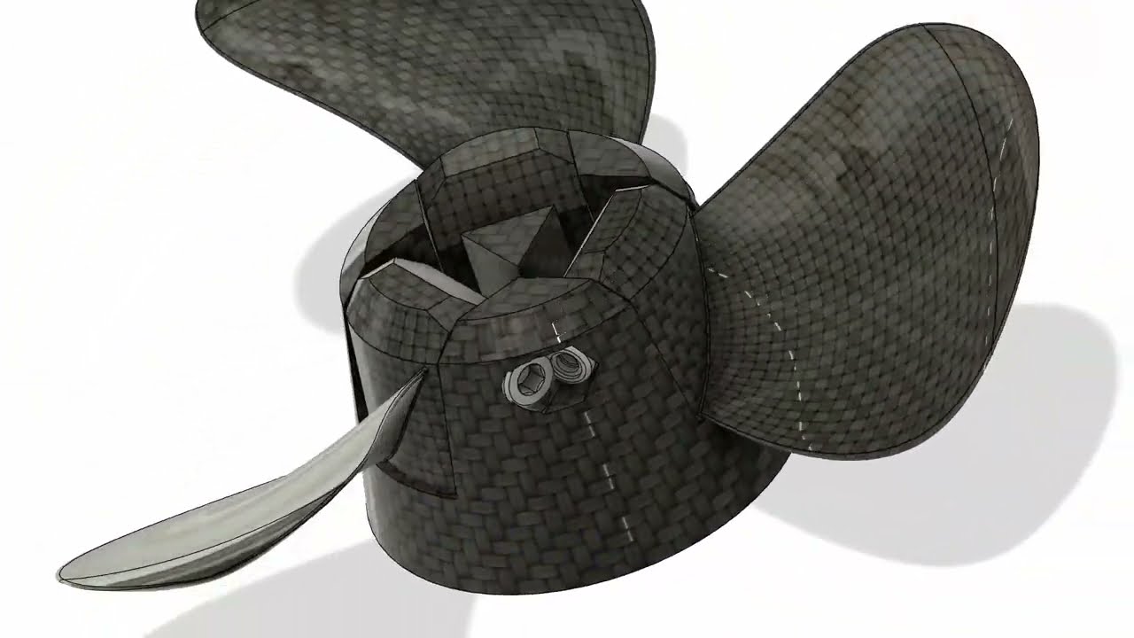

Fiber carbon reinforcements on all surface of the 3d printed parts is my solution

Nice work. How did you do such a neat job with the carbon fibre? Did you print the parts slightly narrower to account for the carbon fibre layer on top?
Also, how does it ride? Any noticeable improvements over a two blade folding prop?

I do not recommend using the prop printed without reinforcement. It clearly still has some issues, but if someone want to modify it, go for it.
Echoing Nekite - how did you do such a neat job with the carbon fibre? Did you print the parts slightly narrower to account for the carbon fibre layer on top? It looks amazing!
3 blades propeller on 6384 is working fine. At moment I don’t have any data to show to compare the 2 blades vs 3 blades. But in the following video of the real test usually I don’t have the full throttle during the ride and the power is about 1.1 kW (8s4p) with about1800 RPM (vesc 75100).
I agree with Twshale, to not recommend to use the only 3d print without reinforcement.
My solution is the carbon fiber after the 3d print (PLA or PETG), just putting on top of the each surface and on the base of the blade. It increase the thickness about of 0.4 mm (possible reduction to compensate). I’ll make a video how to do this very soon
