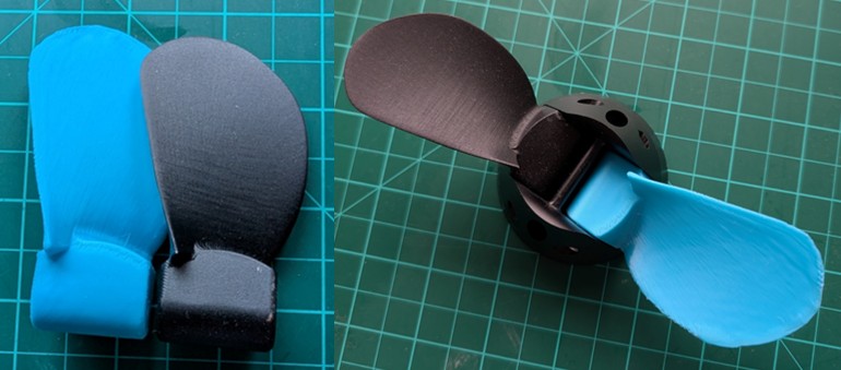

I have “created” an prop which turned out to look almost exactly like the FS 4.8" dual prop for the 6384 motor. Fits the flipsky hub aswell … The reason i did this is because i need a counterclockwise version of their prop for my tow boogie. I have asked them nicely to make me a ccw version but never got an reply.
CW CCW Prop
Disclaimer: I have not yet tested it and it is not 100% accurate to the original but very close.
You could mirror the blade in any CAD software for ccw or cw.
You can mirror in the slicer as well.
mirroring was the easy part. getting a 3d file to mirror was the hard one.
