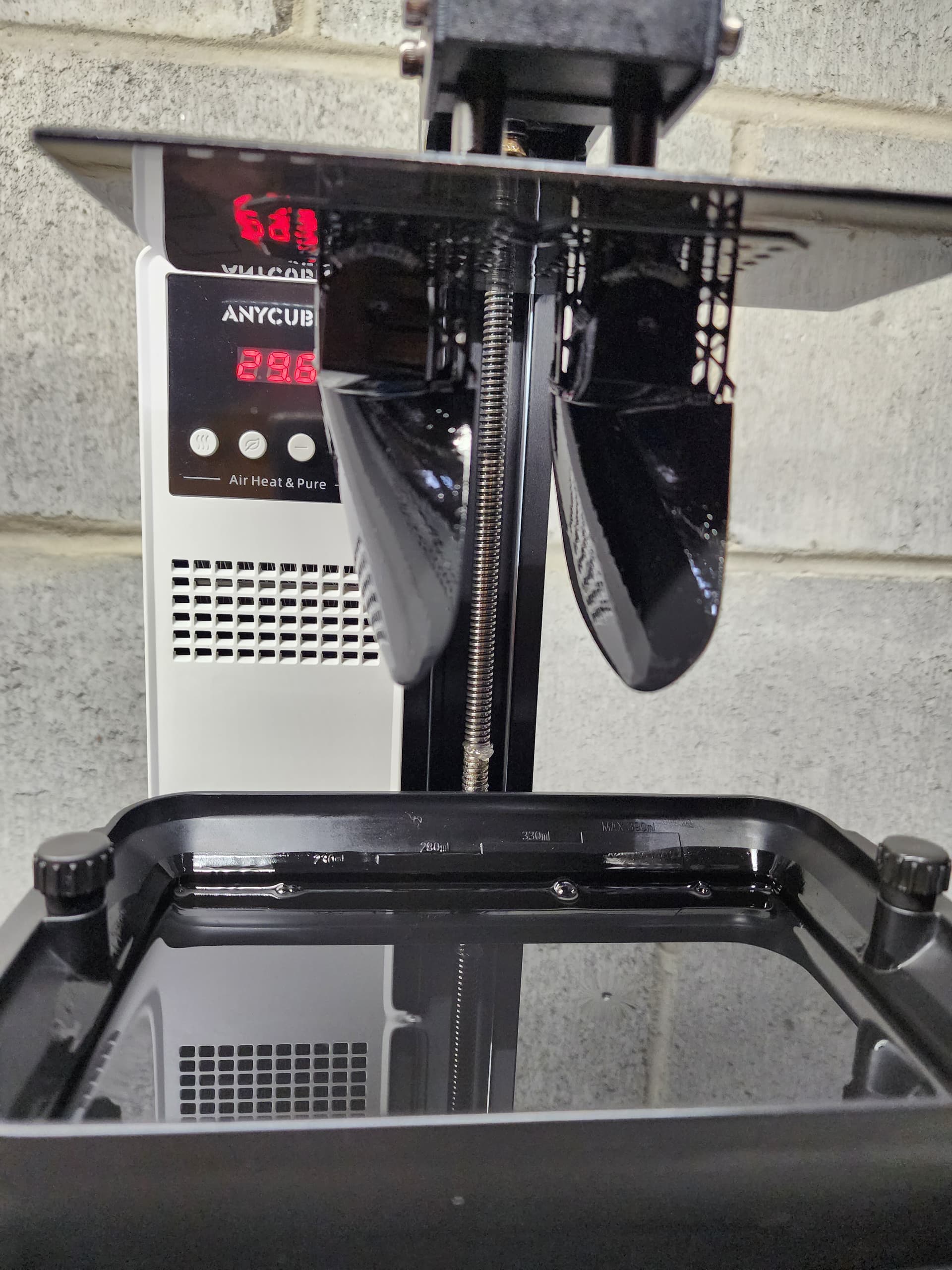

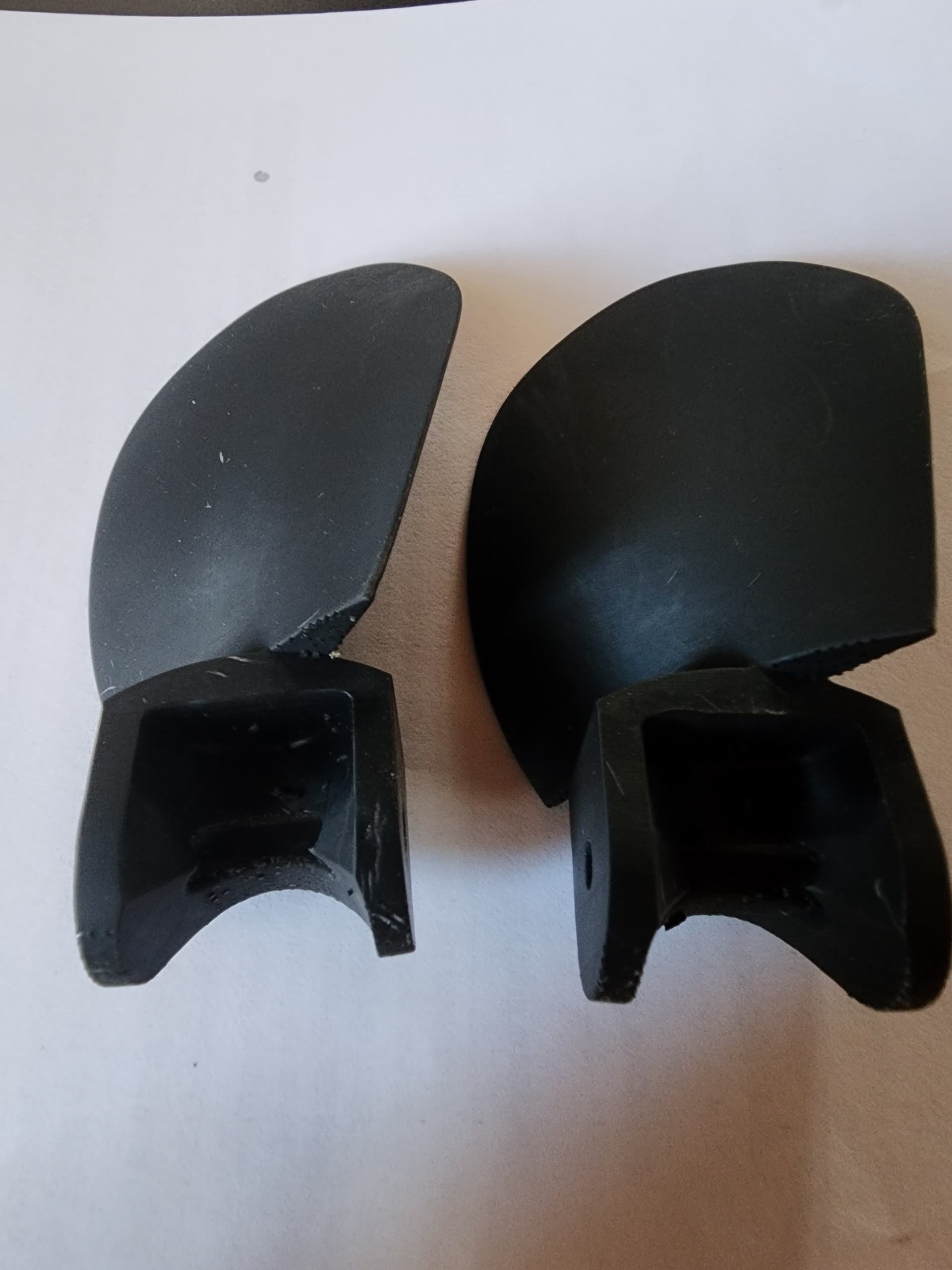

I have resin printed a few in the past. They come out really nice but you have to find the right resin. Most tough or strong resins are slightly flexible to make the part more durable. This flexibility makes the blades deform under load and vibrate.
I did print a few with a cheap abs like resin that lasted for a while. The problem was they would fail inconsistently. One might last 3 hours and another might last 50 hours.
Thanks for the feedback. I ordered the anycubic mon 4 and the abs-like v2 water wash.
Which resin were you using?
Sirayatech ABS like resin. There are def much stronger resins but they have more flex to them.
I ordered the syratech blu tough. Hopefully its better :wink:
