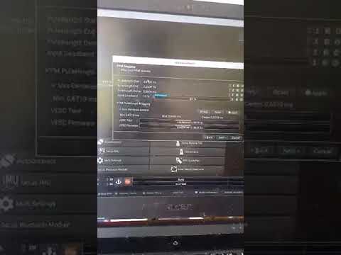

Hello, so the problem of the day is this: after a smooth ride yesterday (still without understanding why the board was working normally), today the propeller only starts spinning when 60% of the throttle is engaged. I had tried charging my battery only up to 95%, so I’m ruling out the issue of an “overcharged battery” this time.
I reconnected everything to VESC Tool and noticed that the values in the PPM wizard were very different from usual. Normally, I see values around 1.1-1.3, but today, as you can see in the video, they’re around 0.6. (and very stable)

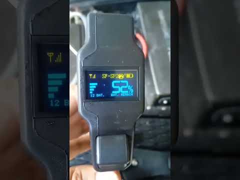

No big deal—I recalibrated using the PPM wizard with these new values, and now the propeller behaves correctly. However, as you can see in my second video, the battery indicator on the remote is completely off and shows nonsense.

Hi,just came back from the sea, the board worked well but no more display for the remaining Bat % and before go to ride I heard the relay in VESC box clicking several time . That forced me to unplug the battery and plug back.
