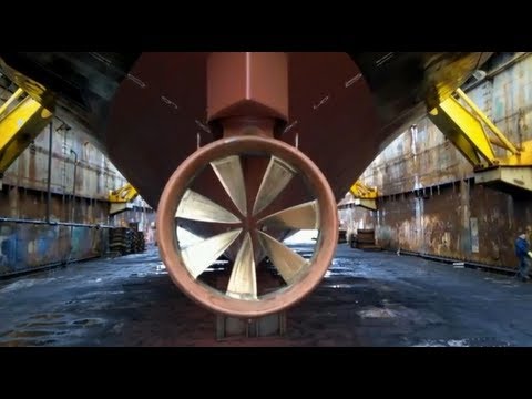

https://www.youtube.com/watch?time_continue=4&v=ok6O234NwOo&feature=emb_logo

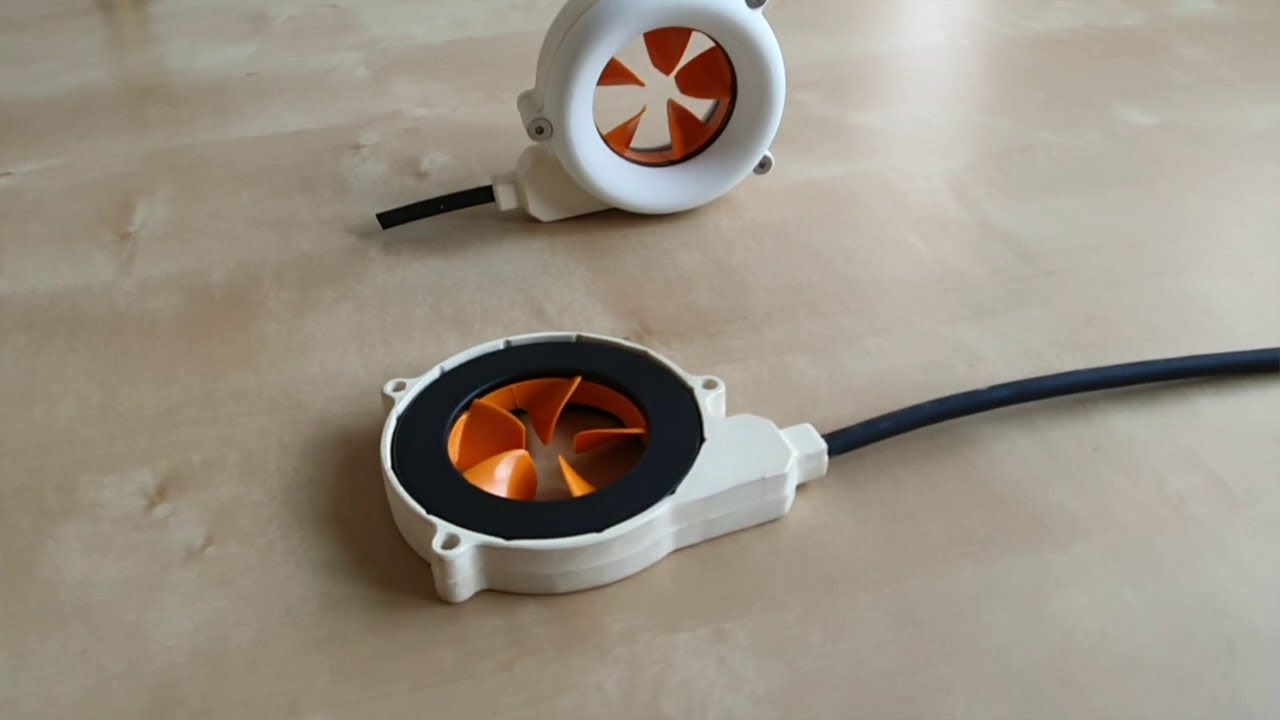

The secend one is would be intresting, with 2 intakes and regulad barring.
Did you already tested something?
