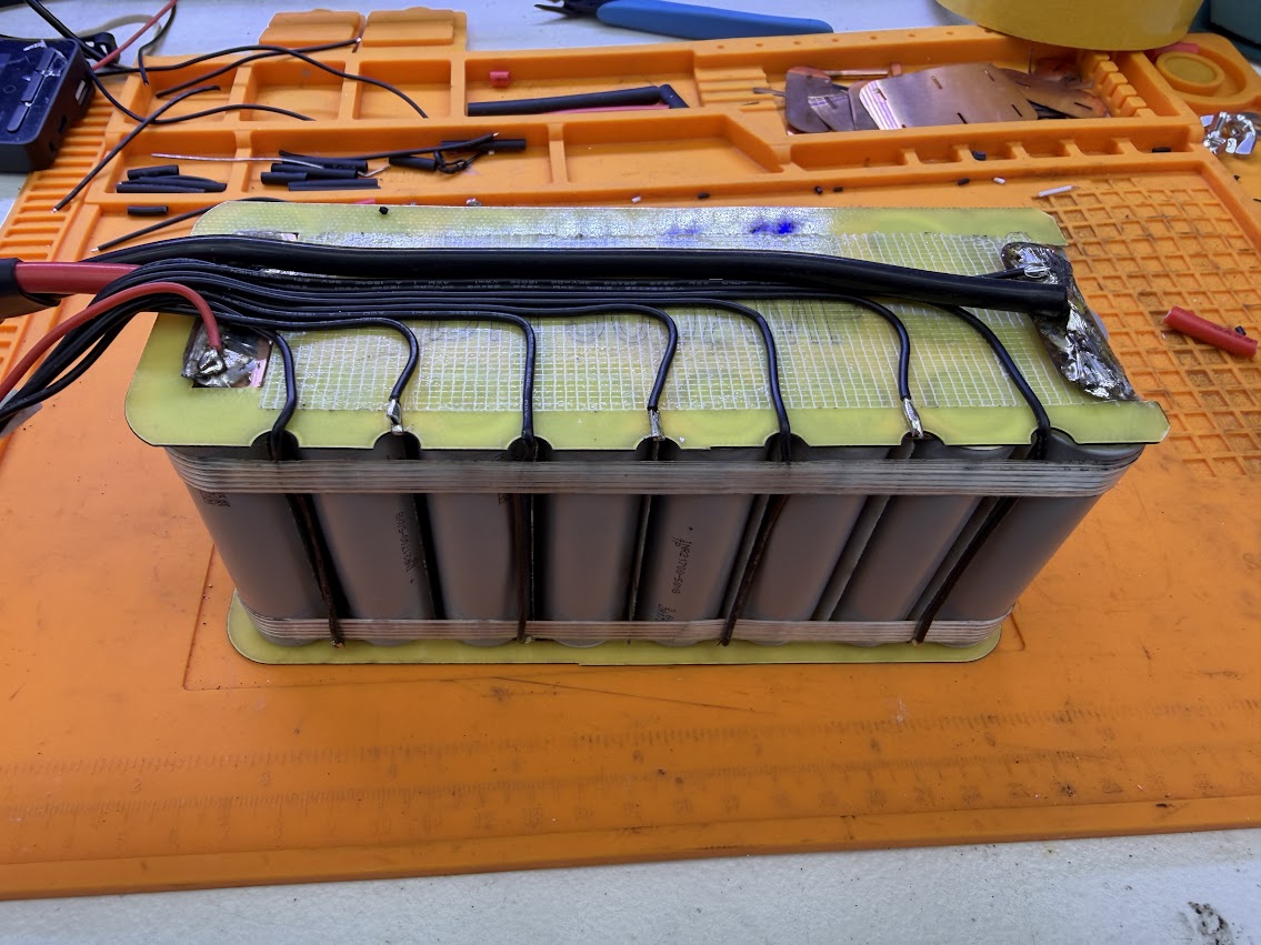

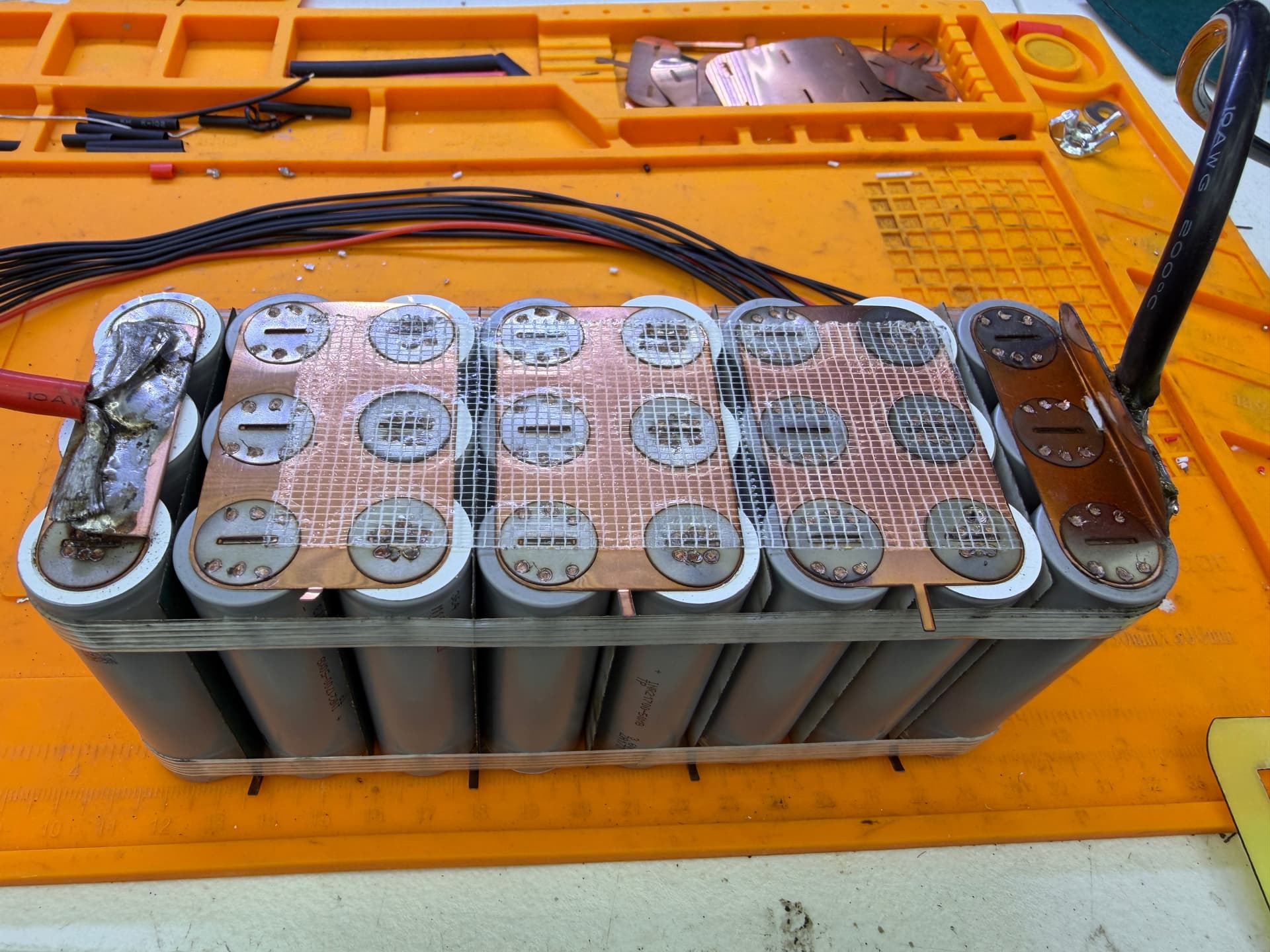

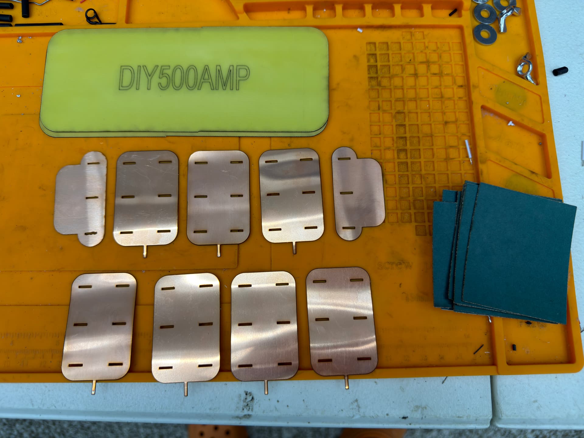

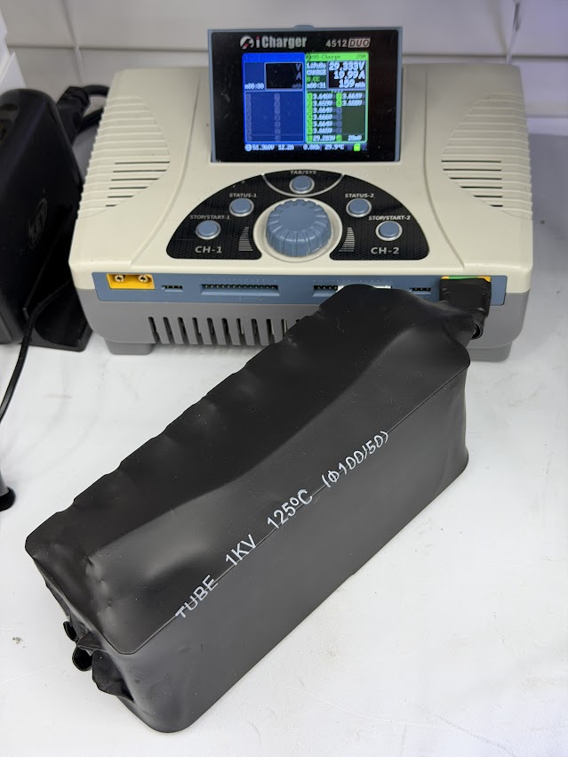

My last efoil custom pack for a client.
@DIY500AMP.COM nice to see you on Foil.Zone! A very clean pack build. Interesting that you don’t use any spacer grid for the cells. I guess that’s a laser cut fiber board on the top and bottom? Is that glued down or taped in place? What type of spacer have put between the p-groups?
Roger.
Normally I do not build without cell holders but this was a very specific request by the client since he explain otherwise will not fit in the factory box. I use fish tape to separate the P-Groups. Everything was cut with the laser yes.
