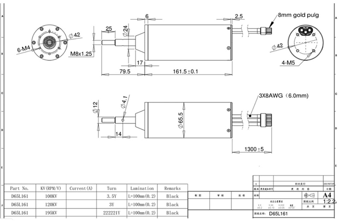

Good to know that FLIPSKY have just changed their motor page. They propose four variants between 100/120kv and 10/12mm shaft. In 120KV, they offer a 10mm unthreaded shaft (variant ~9559) and a 12mm threaded shaft (variant ~5095 your choice).
