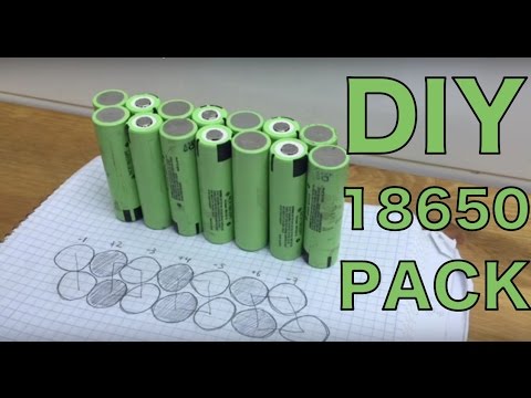

I highly recommend building a 18650 pack with either Samsung 25R or 30Q cells. It won’t cost you much more and you will have safer longer lasting batteries.
Would building a battery pack really be safer? I’m sure I’d be careful, but I don’t have any experience spot welding. Also, when your batteries got puffy, were you balance charging them and not discharging any cell below 3.7 volts?
Also, if I were to build a battery, are there any specific guides that you would recommend I look at, or should I just do a general search for how to spot weld a battery pack.

I have never taken my lipo’s below 3.6 volts per cell and they still get hot. Yet my 18650 pack I drain to 3.2 volts per cell without any issues.
Spot welding with a quality spot welder is not difficult. There are plenty of YouTube video to learn from.
Ebikeschool.com has some good videos
Well worth the effort to build your own battery packs in my opinion
