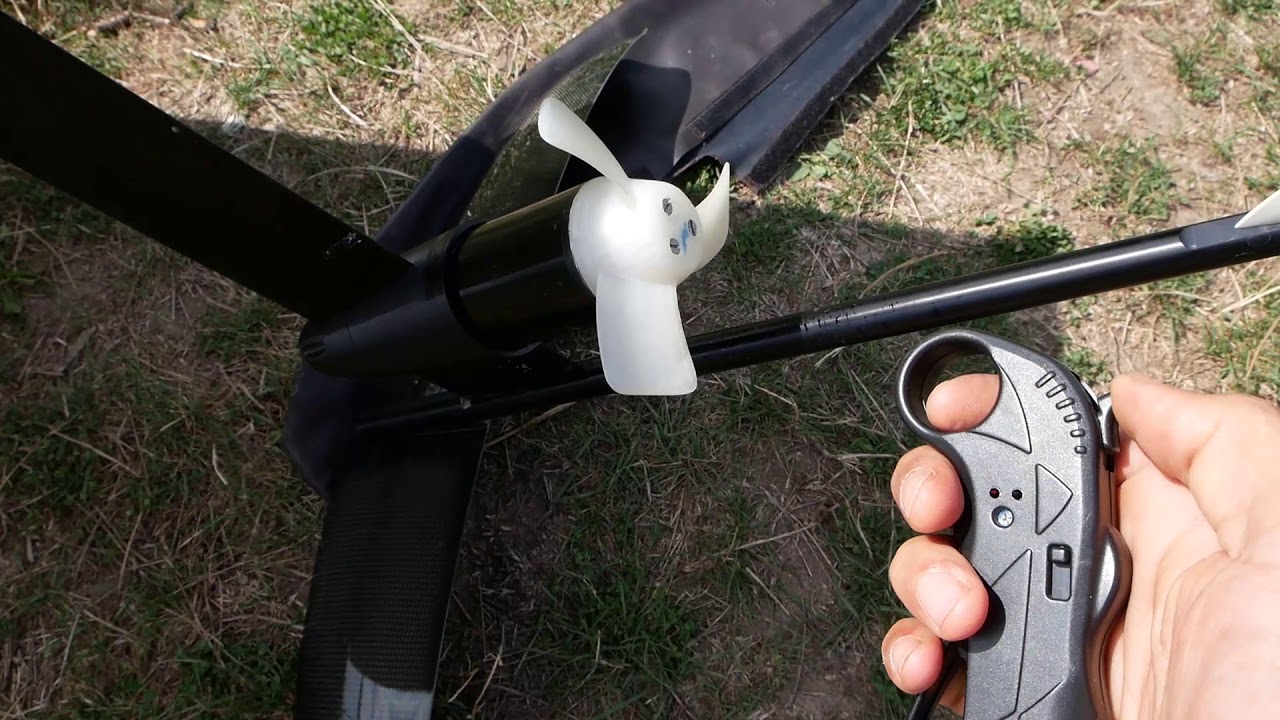

The Motor is mounted with a 3d printed clamp to the mast, directly above the RL-Kite-Foil-Wing. The mast contains 10AWG-Motorcables and a pipe for the water cooling system. It’s powered by a Flier 320A ESC and fused with a 200A circuit breaker. I only use 3d-printed props and started with scaled (factor 0,78) version of this one from the Forum.

Riding “Renate” 1-4 times a week for the last two months there is no major thing that i would do different the text time. I tested out around eight different prop-versions and finally found the perfect one for me (for now).
These are my results @ 47 Volts:
16 km/h 21A/1kW
20 km/h 29A/1.4kW
25 km/h 40A/1.9kW
30 km/h 59A//2.7kW
