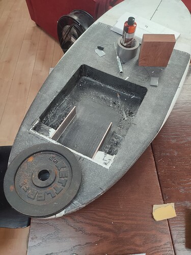

Roffa simple build with Gong setup, 4x6s flat lipo and 6384 motor
Bottom 3 layers are on, total is now 2.3 kg
I didn’t expect the foil mount box to be so heavy, somewhere around 1 kg
The total glassing scheme:
160gr glass
160gr glass
200gr carbon piece
-eps-
200gr carbon
180gr carbon/aramid piece
160gr glass
160gr glass
