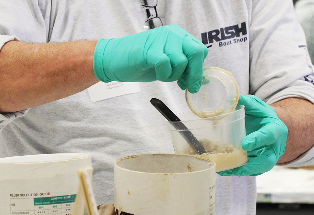

After making 2 efoil boards, I’m becoming more concerned about the affect working with this stuff has on our health. Reading is revealing that the resin, both the epoxy and polyurethane we use is quite bad for our health. The main risk being through skin contact with uncured epoxy. Over-exposure to uncured resin can cause sensitisation and ultimately the users body being unable to handle being around uncured resins.
  • Here are some articles that provide some insight, I don’t use this epoxy, but these are good articles:
With epoxy/polyurethane resin and fibreglass work highly involved in the building of efoils, I think it is important that we all discuss and are aware of the risks involved.
I personally wear nitrile gloves to prevent skin contact with uncured resin, and wear a face respirator with organic vapour filters to prevent inhaling the hard to notice fumes the epoxy puts out. Polyurethane which is a cheaper resin puts out more noticeable fumes than more expensive epoxy resin.

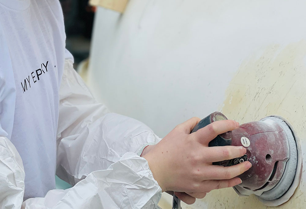

I was sanding and filing the old surfboard and sanding the new epoxy without any mask, I thought it would be ok for a while.
Meanwhile while having the nosebleedings I just continued, that was silly, but I thought it was some other problem. But the nosebleeding was really bad. I wanted to stop it by sqeezing the nose, but it ran in my throat, and the blood cleaned out all the slime in the throat. That is probably the reason why you get these nosebleedings so bad, your body wants to clean the slime.
Never happend again when using a good mask, also bought a dispossable suit and I clean the working area with mask and leafblower and vacuum cleaner. Stay Safe !
Thats a bad idea. Sanding is extremely bad. The particles are unhealthy cured or uncured, and a few days old epoxy must not be entirely cured and if the mixing is not perfect, there can always remain some free radicals.
I find hand sanding produces way less airborne dust, it tends to just settle on the floor, so I try to do it that way as much as I can. It does take much longer but worth it for me…

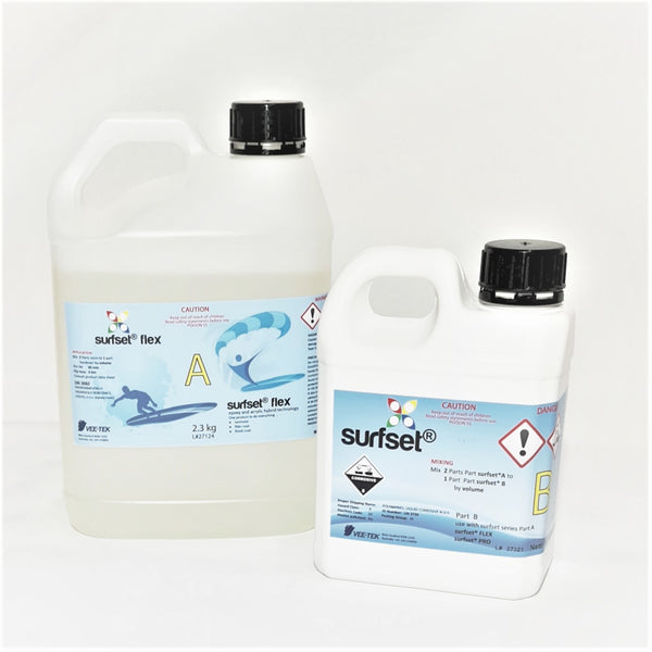

Then the second board was made with nicer fibreglass and a ‘surfset flex’ resin, which set faster and stays perfectly clear when in touch with water, really happy with this one, also stays stiff when heated unlike the other one.
I used about 3.5L epoxy to make a board.
