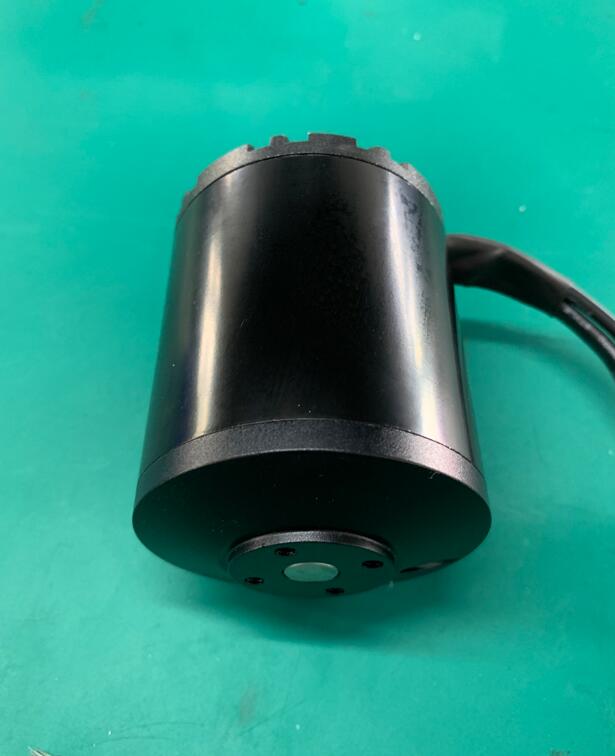

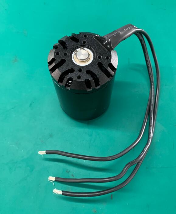

So I’ve been in touch with Saite, and they say their 6384 waterproof motor KV can be customized. They have also sent the pictures:
…looks waterproof, also have asked Saite to send the measures of the stator and the KV customizable range. (will post later as soon as they reply)

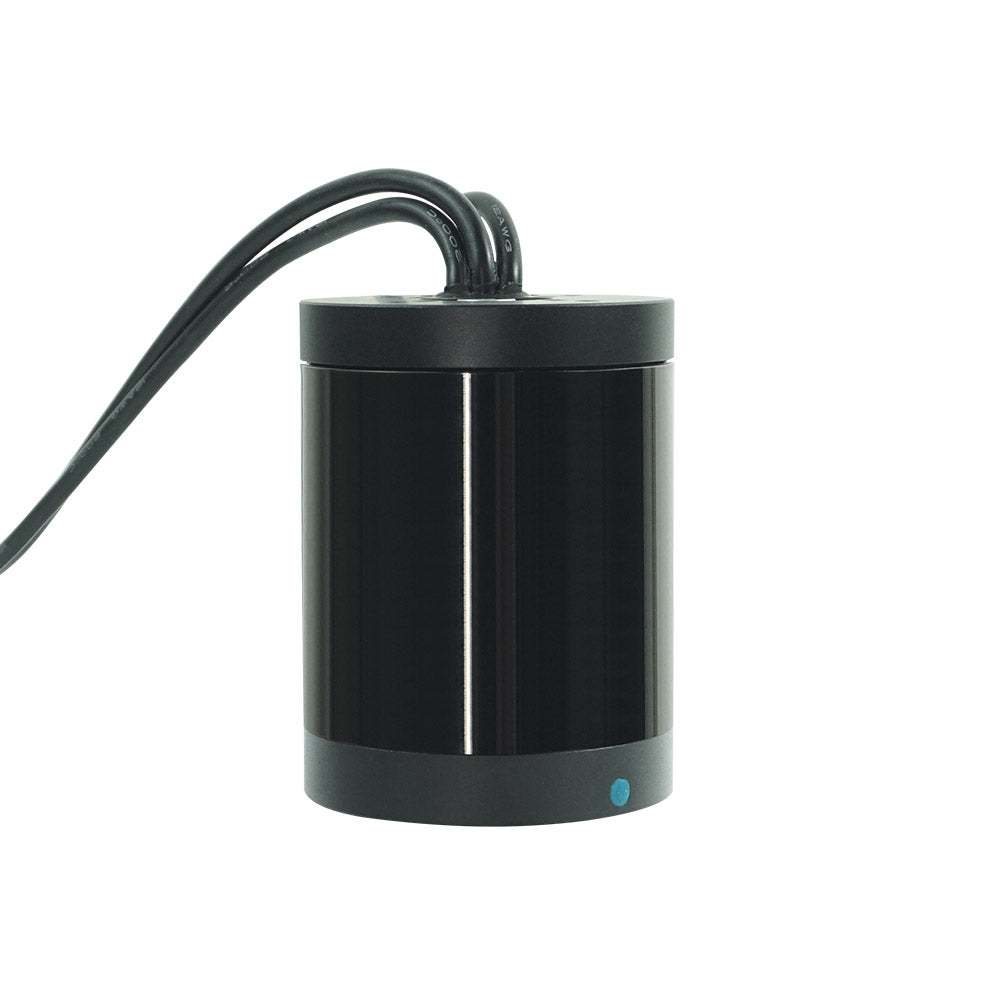

Now the Flipsky 6384 already comes preconfigured 140KV at 4400w
… I’ve tried talking to them and they reply, but at quite a slow rate. I will try calling them later this week with the help of my Chinese-speaking friends

Hi, thank you for the reply, I’ve got Saite 6384 at 130 KV
Chris from Saite said that mostly commonly ordered model is 130 KV, it arrived and looks identical to FD V2 v1 6374 motor with fixed 20cm (before they introduced replace cable). Just finised connecting the setup with my friend feels good, however sounds slightly different to the FD High Power versoin.
