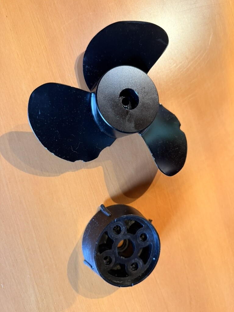

I got a Pulseer efoil A1. I know, my mistake shoud have gone for anything but Pulseer. Anyway, two months ago my propeller hit a rock. The protection cap broke off and the blades of the propeller got damaged. After several mails and messages with the local dealer, I remain without a real solution. Can someone help me with this?
If you give up the duct, you can probably fit an alternative propeller, i.e. flite propeller or a 3d printed one. Just make sure it has the same rotation direction. You might have to design and print a matching adapter between motor and prop.
Strikes me as odd that the dealer can’t sell you a new prop???
What does the motor shaft look like? The prop looks like a lift prop that is attached with an M6 screw.
6“ or 7“
Pulseer is almost a carbon copy of Lift, parts should be compatible.
