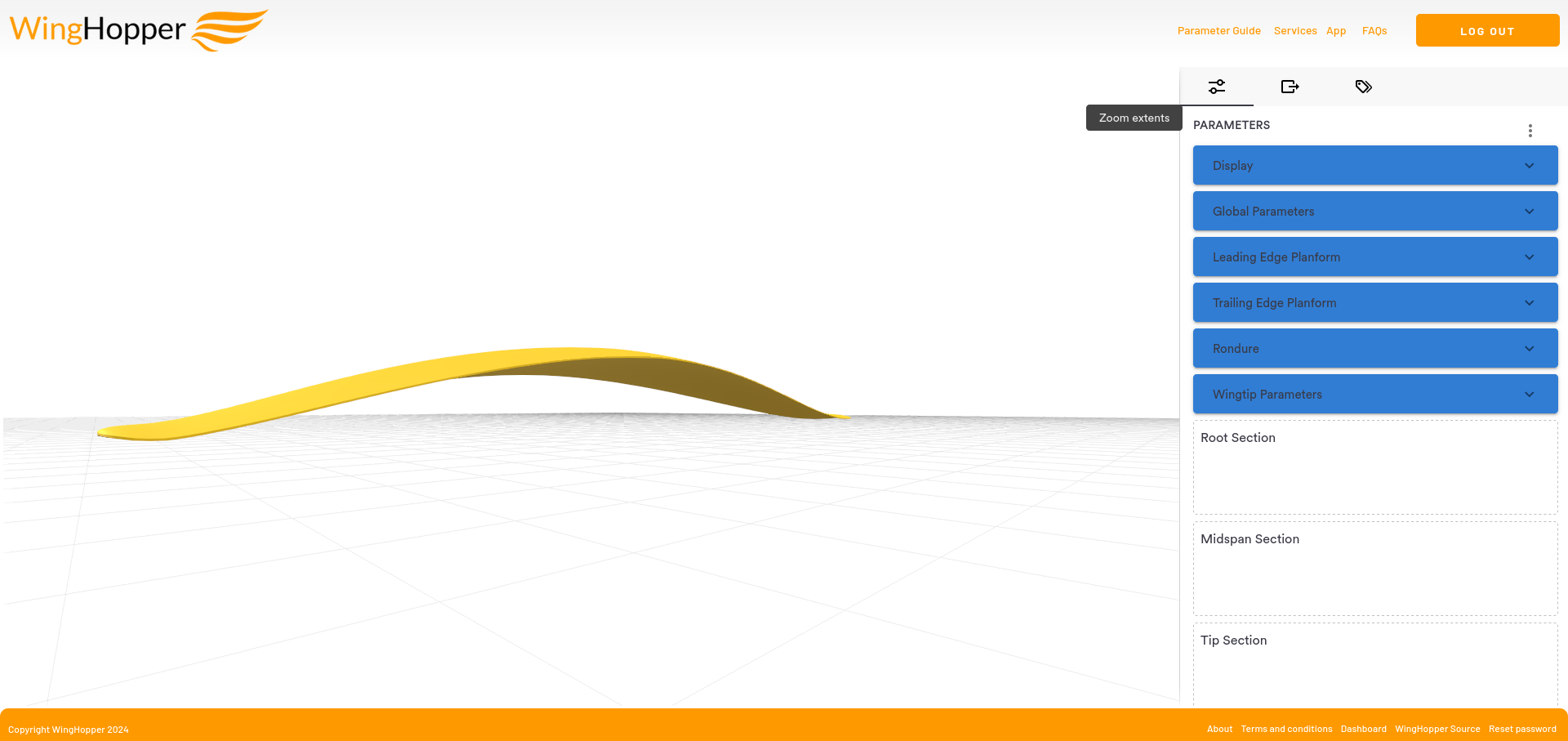

winghopper.com is a decent place to design your own.
Also https://finfoil.io/

WingHopper is absolutely great.
