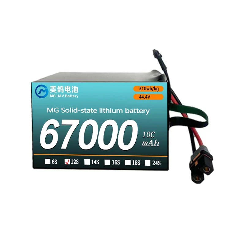

MG Solid-State Lipo Battery 67000mAh 10C for UAV/RC: 12S 44.4V, 14S 51.8V, 18S 66.6V, 310Wh/kg, 1C–2C charge
MG
Regular price$2,145.00 USD
Very interesting. Apparently it is real. New technology.
25% less weight, 50% the size.
Specifically these are Racepow - they have a website. Shenzhen Hanhailong on Alibaba sell them.
350-400WH/kg. Can be bought as packs or individual cells. The cells are attractive because can be soldered probably into a pack with BMS.
Price is about twice the 21700 li-ion variants.

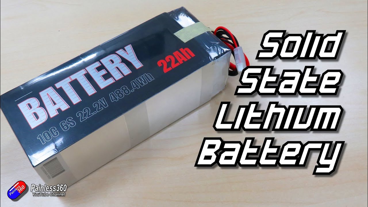

Here is a little video about the technology:
